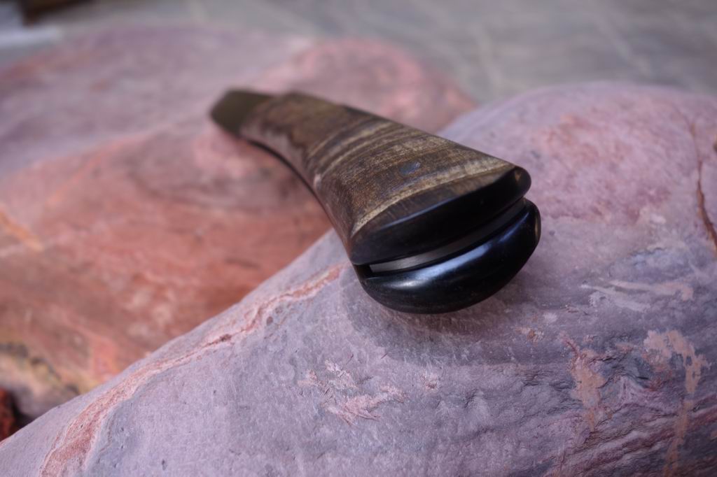

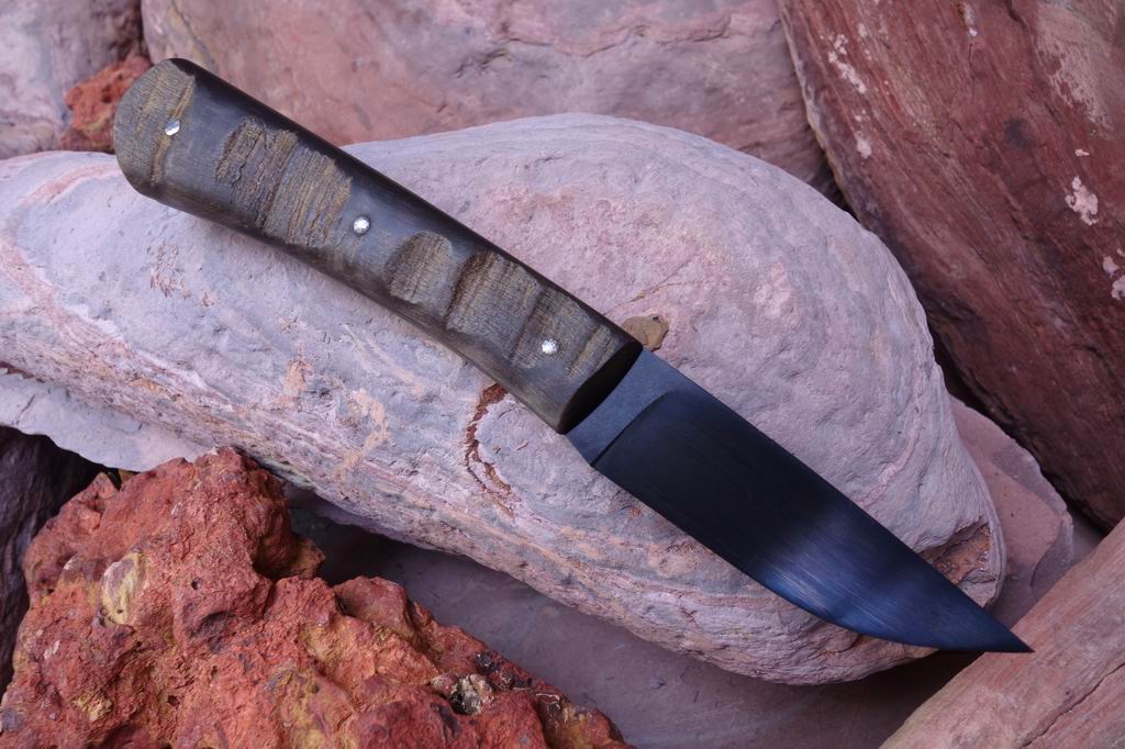

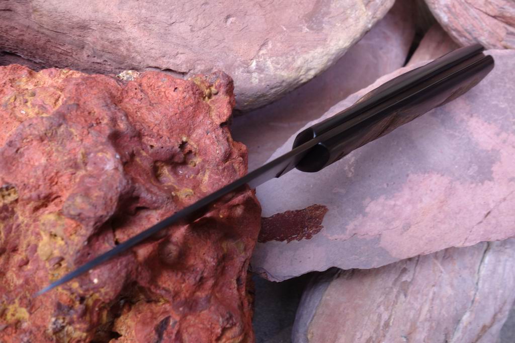

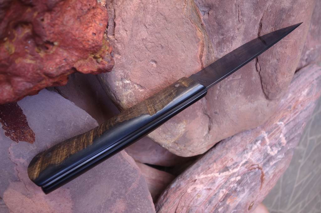

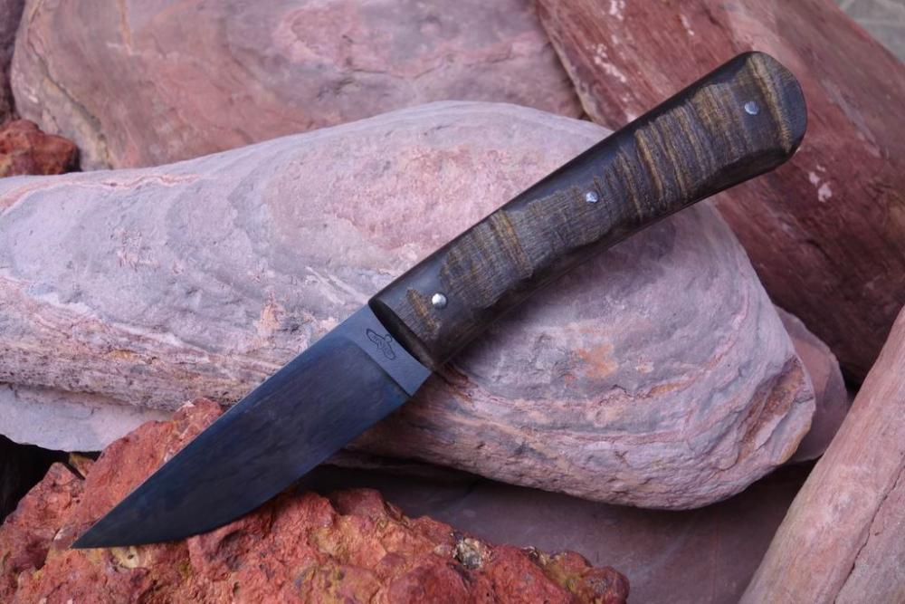

...could be translated as "Goat's sheet".
It has a blade made from 1.2442 (115W8) that is 86 mm long, 2 mm in width and overall length measures 200 mm.
Handle slabs are Capricorn horn pinned with sterling.

Very nicely done. I particularly like how the dark horn and the dark blade go together.

I have to ask: how did you get the blade to be/stay dark? Just curious as it came up in conversation with a new colleague when they found out I do this as a hobby (still unpacking after the move, so haven't hit anything lately).
Probably hot or cold bluing like is done on Guns, (and I once had a maille shirt hot blued...)

Correct me if I'm wrong, but doesn't it eventually wear and need to be redone from time to time? I haven't worked with the stuff yet due to the moving madness, btu it was a suggestion from my pattern-welding class.
Yup not seen a lot for "using blades" but ifn you are spending over US$5000 for a pocket knife you probably won't be using it to pioneer with...Just like guns that are blued and get used require redoing as needed.  The above is a beautiful knife but would not be my daily carry if I owned it---maybe I'd wear it when I went to church on Sundays if I was dressing up.
Cold gun blue of any brand works well.

Thomas, with respect to the tempering of the blade (cold work tungsteen tool steel, max.temper at 230 degrees)I would not recommend blued hot, which, as far as I know starts at 300 Degrees.

I don't understand the name but I see it as an awesome knife that has a good shape. Beautiful work. Love the dark on dark

That's a really nice looking knife temple hound. It has rough yet finished look to me, if that makes any sense.

That makes a lot of sense because it is an exact description of the kind of finish I want to have on my knives.
