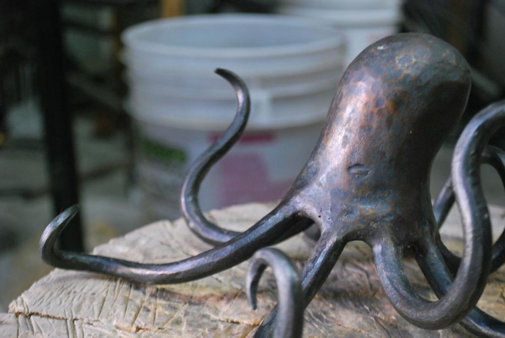

JoshuaK Posted January 18, 2016 Share Posted January 18, 2016 Hey guys, thought you might like to see this octopus I made recently. Quote Link to comment Share on other sites More sharing options...
Frosty Posted January 18, 2016 Share Posted January 18, 2016 Mighty fine Mollusk you made Joshua. Frosty The Lucky. Quote Link to comment Share on other sites More sharing options...
ausfire Posted January 18, 2016 Share Posted January 18, 2016 Fantastic! Looks like it's moving. Quote Link to comment Share on other sites More sharing options...
johnnie Posted January 18, 2016 Share Posted January 18, 2016 Yes Josh I like this! What material do you use for it? Looks like sheet steel. Well done looks great. Quote Link to comment Share on other sites More sharing options...
JoshuaK Posted January 18, 2016 Author Share Posted January 18, 2016 Thanks guys! I used bar stock for the arms, probably like 5/16 or something, and I used 16g sheet for the head. Originally, I tried to raise it in one piece, but I was working really fast, and I guess I probably had a rich flame (or is it lean? Whichever one has too much air) and I lost a lot to scale, so once I got it to shape, it was too thin to behave. So I just welded up a little can, ground off the welds and knocked in the corners. I ended up making a punch for the eyes. Not sure if I'll ever find another occasion to use my octopus eye punch. Quote Link to comment Share on other sites More sharing options...

Frosty Posted January 18, 2016 Share Posted January 18, 2016 Steel at forging heat will scale in open air regardless of the forge. Unless it was scaling IN the forge you just ran into normalness. Sheet seems to scale a lot faster but it cools so much faster it's in and out of the forge a lot more often. Frosty The Lucky. Quote Link to comment Share on other sites More sharing options...
