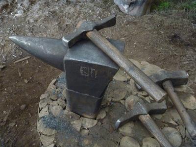

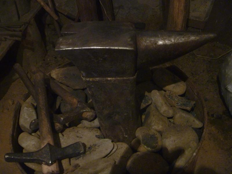

Bogdan Popov's anvil updated
The new version of my  anvil  is being tested
1. The main improvement is the dovetail end with one edge being sharper to be used as hardie and the other is rounded to be used as fuller.  The triangular notch is used multifunctionaly for punching, bending, etc.
2. The face preserves convex profile which proved itself extremelly well during last 5 years of work
3. Same for the edge like cross -section of the horn.
4.  Massive concrete foundation was used under the base plate
Thats an interesting anvil for sure. Are you making them yourself?
Andy
Thanks Andy!  I make the styfoam model, give it to the foundry, then grind , polish and harden the obtained object
Ah ok that's cool. What are they cast from? I'm sure a few members on here would be interested in buying one.
Why the rocks around the base?
Andy
The material is 0.8 %C carbon.
The rocks are used as quick fill for the drum base (gabion like) since this is test mode.  For permanent set up I use packed earth and woodedn wedges

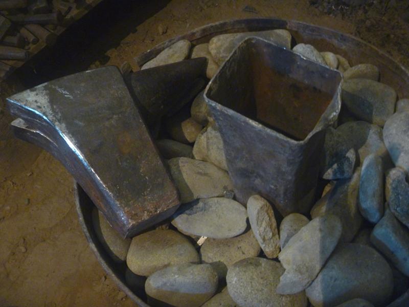

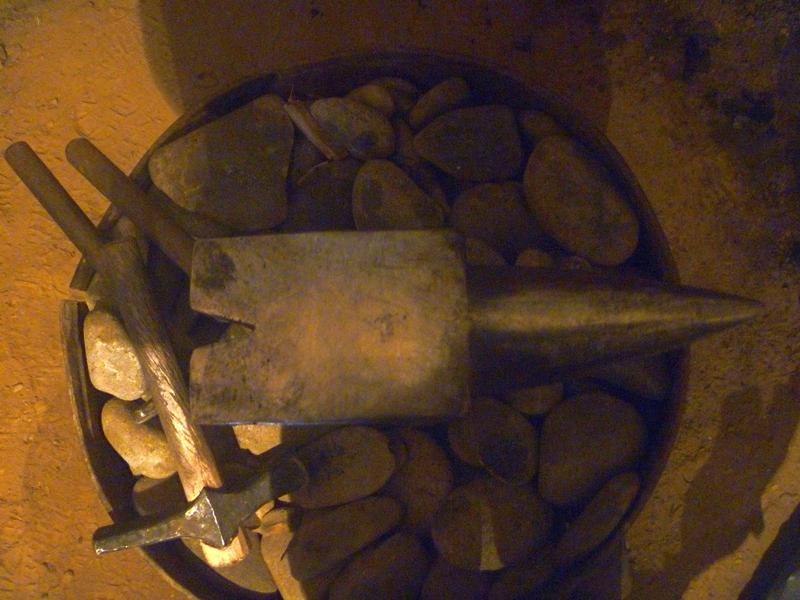

They're looking pretty good. The hammer in the second picture is covering the feature on the heal end. What is it?
Do you have pictures out of the stand, I'd like a look at the whole tool.
Here we go.  The anvil is set selfwedged in a hot formed steel pipe (132 mm diameter, 750 mm long to give my proper anvil height 850mm) which is welded to the 400x400x12 mm steel plate which  rests on a concrete base 600 mm deep.
That makes it pretty easy to take into remote places, finding a piece of pipe to use as a stand would be reasonably easy. Pipe is pretty common almost everywhere.
What is the feature on the heal end? I'm imagining all kinds of things but would like to know what it's really for. It's gotta be something good, it's too much trouble to make not to be useful.
Frosty, the heel end notch serves much like a pritchel hole and supports the work while you drive the hole through.  The ends of the heel are sharpened to varying degrees to create a built-in fuller and hot-cut.

Yes, the notch was meant for working with holes but I am finding more and more uses for it.  The heel edges are also good idea.  If you need to get to some complicated  places  they are quite useful.

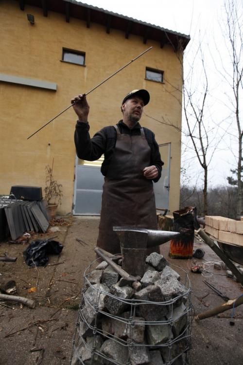

I ran a workshop in Vienna Uni a week ago "Blending Ecology and Blacksmithing together"  and made an experimental stand for my anvil as a real gabion with the steel mesh and stones -- basically what I found at the location.   Actually that worked extremelly well!  I really liked it.  No more earth and wooden wedges. The gabion was made in a conical shape with the base wider than top.  The mesh probably should be of thicker metal with the smaller spacing but anyway the principle is very practical.  I can recomend it like even to wrap around the thin wooden stands and fill it with rubble in case one lacks thicker stump.
