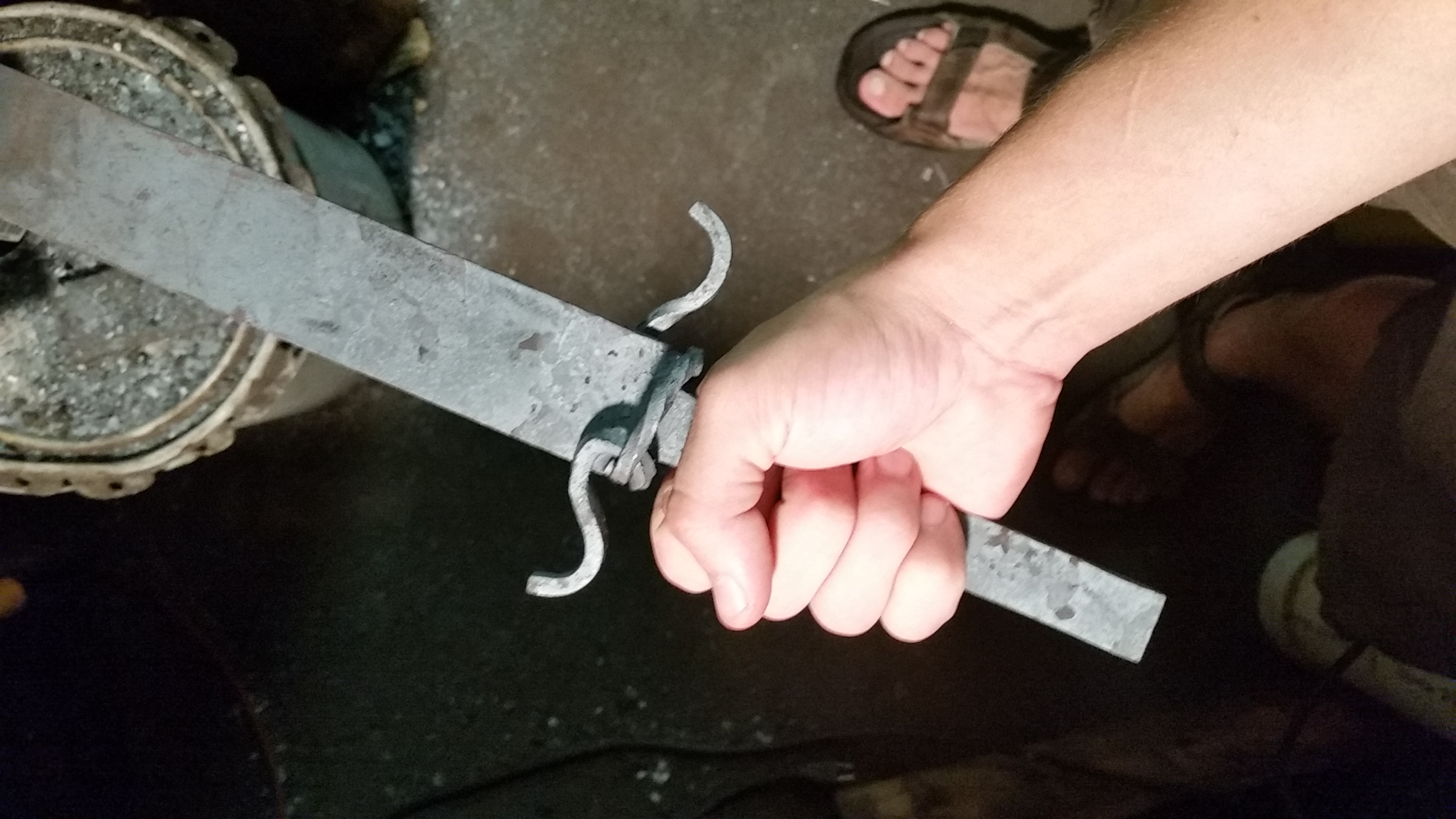

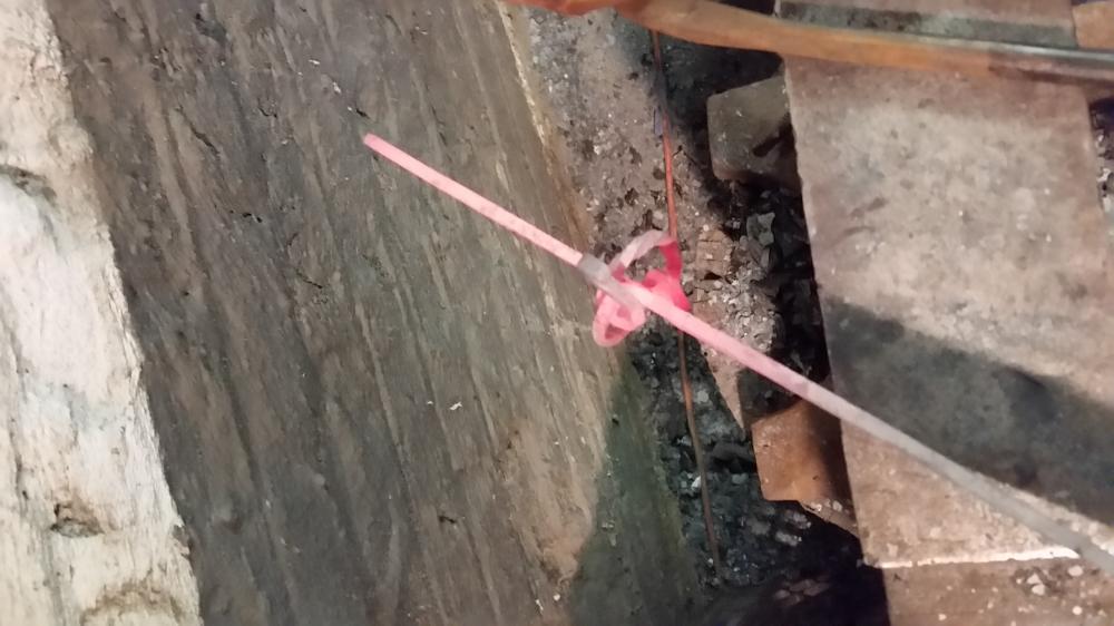

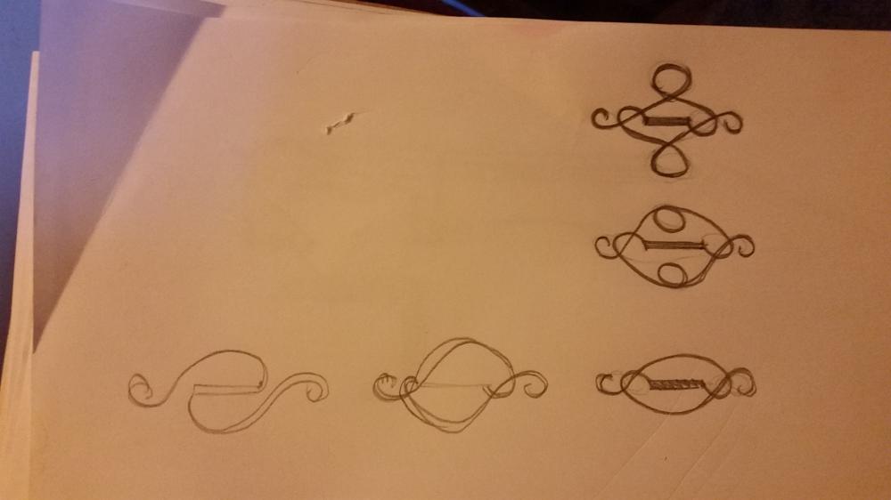

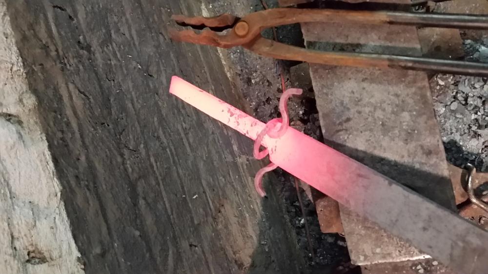

TheoRockNazz Posted September 11, 2015 Share Posted September 11, 2015 I've been working on another blade inspired by the katzbalger style sword... and honestly can't figure out if I like it.I think I want the whole guard to be broader, which would mean I need to untangle and untwist then draw out. I rather like the perfect squareness of the guard material though (I cheated and did the cuts with and angle grinder), and don't trust myself to perfectly squarely draw out the guard.Then I started doodling some other neat ideas I like a bit more, but only work if I draw out... but is it worth it? Maybe I set this guy aside and experiment.In retrospect I should have played with this design in mild steel first before cutting up a bar of S7 Link to comment Share on other sites More sharing options...
j.w.s. Posted September 11, 2015 Share Posted September 11, 2015 Looks cramped and a little forced, definitely not big enough. Remember, the guard is there to fully protect the hand, not to "just barely" protect it. Is there a reason you're working the guard on the blade? J Link to comment Share on other sites More sharing options...
JME1149 Posted September 11, 2015 Share Posted September 11, 2015 Of all your doodles, the one that jumps out at me is the bottom right corner. It looks simple yet elegant. Maybe if you go with an octagonal shape rather than square, the twists might look a little more finished or refined. Maybe try a mockup in a piece of mild steel before you commit to changing what you have.Just the humble opinion of a non-bladesmith Link to comment Share on other sites More sharing options...
TheoRockNazz Posted September 11, 2015 Author Share Posted September 11, 2015 JWS: Yep, okay, you're right. I love integral knives, and thought the katzbalger was perfect for an integral guard on a sword. I also like a challenge, haha JME: That one seems to be everyone's choice. I have no mild steel in my stocks, gotta pick some up. Ah geez - why didn't I remember this before? - I should get some clay! Link to comment Share on other sites More sharing options...

Frozenthunderbolt Posted September 14, 2015 Share Posted September 14, 2015 I've got to say, that from a (Semi) practical point of view, I would lean towards the bottom left design. It is simple (light - not adding weight to the sword) but provides decent protection. Link to comment Share on other sites More sharing options...

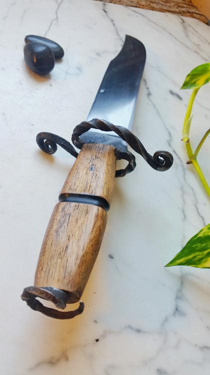

TheoRockNazz Posted September 17, 2015 Author Share Posted September 17, 2015 Did that for this guy, would like to do something a little more elaborate Link to comment Share on other sites More sharing options...
