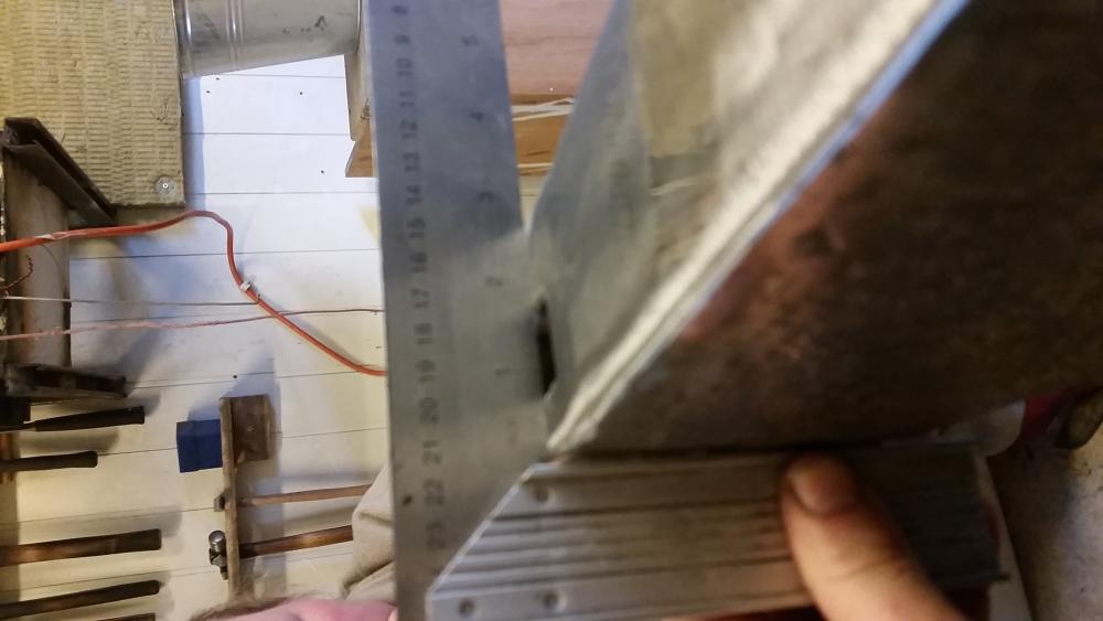

The hardy hole is about 30 mm not quite square and very slightly tapering. My bought hotcut has a 25mm shank so I took a piece of 30mm square tubing heated it and hit it down into the hole. It became loose of course when cooler. I then cut it so it would be lower than the anvil surface, ground the shank to a thight fit and hammered tube onto it. The result was excellent. The play (or should I say shake) at the edge is less than a quarter of a mm but it will not stick the least in the hole at all. It will, however, only fit one way since the hole is not a perfect square. I can recommend the procedure.

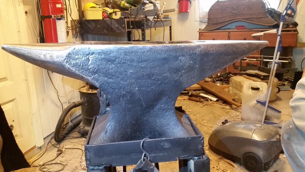

Well yours is obviously a Norrlandsstäd i.e. North Swedish type. Where are you by the way? Norge? No I do not know who made mine It could be Söderfors or Kohlswa or Bofors or or. Ther has been several Swedish (and I assume Norwegian) steel foundries that made anvils in the past 150 years.

Ah I see. . Im from norway yes. Ah the stores those anvils could tell. . I think your anvil is bigger than mine mine are just 70 kilos. .

You guys in the Scandinavian countries just kill me with how easy it is to find such fine cast Swedish steel anvils. I have a 125lb. Soderfors, Sorceress #5 and I'd dearly LOVE a heavier one for a shop anvil. A double bic would be sweetness indeed.
I don't think I could bring myself to do anything to either of those fine old ladies but make a stand and put them to work.
It is not that easy to find an anvil here Frosty but those that we find, are usually of that type. It is popular among blacksmiths. The three closest shops here use them exclusively.
This shape seems to be more silent than the London pattern, there is a substantial amout of steel under the holes and the "sweet spot" stretches nearly all the way between the horns. They are also very easy to move since a rope will go down one hole and up the other. Any hoist will keep them level when lifted.
Yes Kjell, mine weighs in at 110 kg. nearly 250 pounds.
The thick body wouldn't ring like the tall thin body and long thin horn and tails on the London patterns. I'd sure like to have the performance without the brutally loud ring. Oh well, small enough price to pay.
