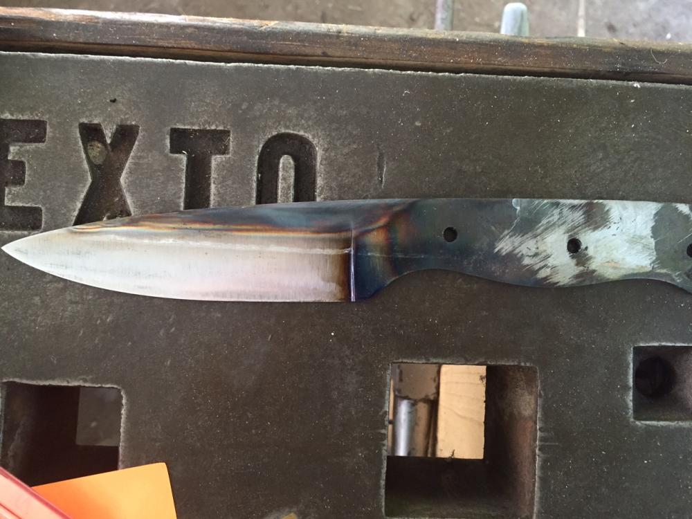

Urthman Posted August 5, 2015 Author Share Posted August 5, 2015 Spine draw using oxy-a torch and pan of water method.Maybe I could have gone a little closer to the edge, but I guess this looks about right... Quote Link to comment Share on other sites More sharing options...
Frosty Posted August 5, 2015 Share Posted August 5, 2015 You GUESS?Frosty The Lucky. Quote Link to comment Share on other sites More sharing options...
Urthman Posted August 5, 2015 Author Share Posted August 5, 2015 More like "I HOPE". This is uncharted territory for me... Quote Link to comment Share on other sites More sharing options...
Frosty Posted August 6, 2015 Share Posted August 6, 2015 All the more reason to spend time reading the knife making and heat treating sections here. Not to come across cross but blades aren't really the place for I guess unless you're making wall hangers and you've obviously put time and work into that one. There's no need to guess and gamble all the work you have invested when a few hours reading would give you a good grounding.I'm not a bladesmith guy but I can tell you the draw on the spine is about as wide as the full hard edge should be. As it stands right now if you achieved full hard in the hardening step your blade is dangerously brittle. Only the last say 1/2" or so of the edge should be in the pale straw range.I don't know how long it's been since you hardened your blade but without tempering there are stresses building and it may fail catastrophically just sitting there. At least pop it in a toaster oven set at 375-400f and give it an hour or two.Frosty The Lucky. Quote Link to comment Share on other sites More sharing options...
Urthman Posted August 6, 2015 Author Share Posted August 6, 2015 Oh believe me, I've spent many more hours reading about how to make a knife than I have actually working on this one. The tricky thing is, if you ask 10 different knife makers how they'd heat treat this knife, you'll get 10 different opinions. Condensing all the differing opinions into a decision on how to make *this* knife was not easy. I finally decided I had to stop reading and put all the advice into a knife and see how it turned out. This one has been triple quenched (1 full and two Edge) so theory says the spine should be "somewhat" soft to begin with. It was then tempered at 375 (twice, 2 hours each) and the spine drawn back for 'insurance'. The blade is stiff, but has some flex if I push it hard against a table top.I've also got 6 pieces of 'test blade' that I'm trying different tempers, spine draw methods, etc on so I can see how they stand up to destruction testing.Thanks for the feedback! Quote Link to comment Share on other sites More sharing options...
Frosty Posted August 6, 2015 Share Posted August 6, 2015 I've only ever made a couple knives and didn't heat treat either that way. Probably a good thing I don't make blades. Who's technique did you use? If you tried coming up with a technique after reading a bunch of opinions you're most likely really confused.Pick ONE master bladesmith who's shared their technique and stick to that method.I'll be quiet now and keep my non-bladesmith guy opinions where they belong. Frosty The Lucky. Quote Link to comment Share on other sites More sharing options...
Urthman Posted August 6, 2015 Author Share Posted August 6, 2015 after some sanding... Quote Link to comment Share on other sites More sharing options...
Steve Sells Posted August 6, 2015 Share Posted August 6, 2015 First he hardened then gave one temper cycle to the full unit. Good. we should all agree at this point.Then he added some extra and decided to make spine even softer. This extra step of the spine is just that, extra and wont hurt as long as he didn't get too soft, or bleed into the cutting area. nice work Quote Link to comment Share on other sites More sharing options...
