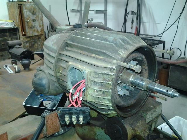

Prospector Posted May 29, 2015 Share Posted May 29, 2015 Hello,We got on old metal cutter and the motor is "burner". So we decited to re coil it.Problem is how to remove the motors stator? It is there pretty tight and can't see any method of attacment.In pic.2 are small gaps in outer ring ond you can actually see trough other side from those gaps. Quote Link to comment Share on other sites More sharing options...

the iron dwarf Posted May 29, 2015 Share Posted May 29, 2015 which part of the world are you in?if in england I may be of some assistance. Charles, that type of motor does not have brushes and a commutator and there will be no countersunk screws under the paint, the outer case is heated to get it to fit and then cant be removed Quote Link to comment Share on other sites More sharing options...

Prospector Posted June 3, 2015 Author Share Posted June 3, 2015 which part of the world are you in?if in england I may be of some assistance. Charles, that type of motor does not have brushes and a commutator and there will be no countersunk screws under the paint, the outer case is heated to get it to fit and then cant be removedFinland. It only takes couple hours to fly here... We came to same conclusion here. Let's heat up the beast and remove the stator. Quote Link to comment Share on other sites More sharing options...
the iron dwarf Posted June 3, 2015 Share Posted June 3, 2015 you will need the stator cold and the casing hot, also record the exact position and orientation of the stator, turns, direction thickness of each winding and how they are interconnected, any of this wrong and it wont work and may be very dangerous.I presume you have rewound motors before and have the equipment and knowledge needed to do this Quote Link to comment Share on other sites More sharing options...

rockstar.esq Posted June 19, 2015 Share Posted June 19, 2015 I managed an electric motor rewind shop for a year and helped out occasionally with the rewinds. Motors seem really simple but there are HUGE variations in how it all comes together. Do it wrong and it's a fire hazard. Winding arrangements alter the torque, speed, direction, horsepower, and current draw of the motor. Subtle changes are not at all easy to define mostly because you can't get the windings loose until the varnish is burned off. It takes a very practiced eye and a hefty amount of reference material to define what you're looking at. We had a huge library of reference material and yet we still encountered occasional "mystery" motors.Beyond all of that, burning out the resin/ varnish requires a furnace built for the task. Out here, that means an after burner on the stack and regular EPA inspections. Depending on what it's made of, varnish can be incredibly toxic when it's burned. Very often the entire motor assembly is placed in the furnace. I would very much discourage you from taking it apart. Motor rewind shops will have all the necessary tools, equipment, and knowledge to fully refurbish the motor. Bearings are an enormous variable that often drive upwards of 30% of the cost. Very expensive bearings are irreparably damaged through mishandling. Torches can melt Babbitt bearings, commutators, and brushes. Stators can be made of oxidized steel laminations that are deceptively easy to damage. Capacitor start motors can hold deadly charges for years after the motor is disconnected from power. Also, when the motor is re-installed great care must be taken to avoid misalignment. We often think hulking cast-iron enclosures are bomb-proof but they're not. Larger motors can wear out their bearings in short order if the mounting feet aren't perfectly level, and evenly torqued down.I would strongly recommend you take the entire thing to a rewind shop. Quote Link to comment Share on other sites More sharing options...
WL smith Posted June 25, 2015 Share Posted June 25, 2015 Take it to a rewind shop. The only way to remove the stator is to pack the inside with dry ice and heat the outside shell evenly then use a press to punch it out. Rewind shops are prepared with the proper tooling Quote Link to comment Share on other sites More sharing options...
rockstar.esq Posted July 8, 2015 Share Posted July 8, 2015 In about 90% of the motors we rewound, the stator is left in place and the entire housing is burned out in the kiln. The old windings are cut and the copper gets pulled out. The new windings go in through the slots and are held in place with a sheet of Nomex folded to "cap" the slots, then the entire thing is dipped into dielectric laquer and kiln dried. Quote Link to comment Share on other sites More sharing options...
