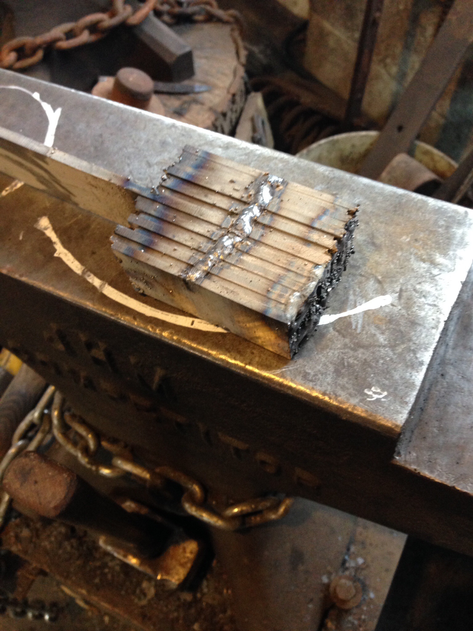

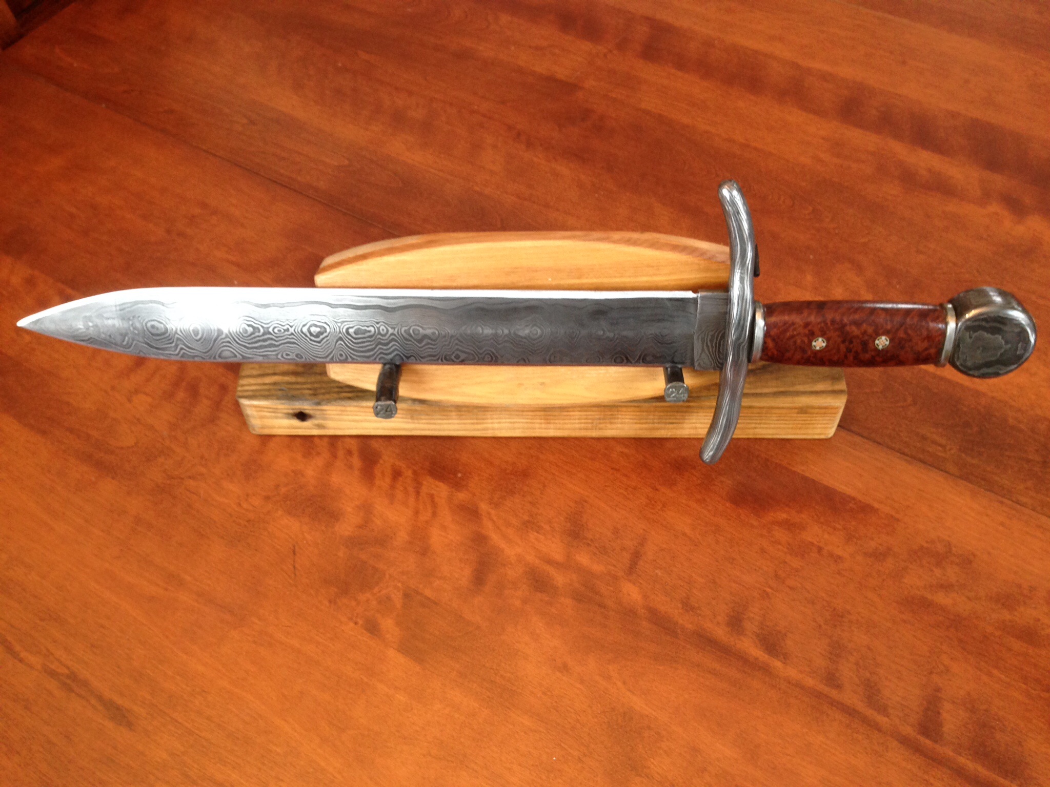

kayakersteve Posted May 28, 2015 Posted May 28, 2015 this short sword started as this billet. it was difficult to handle and i do lots of forge welding. Start small and go from there would be my recommendation Quote
