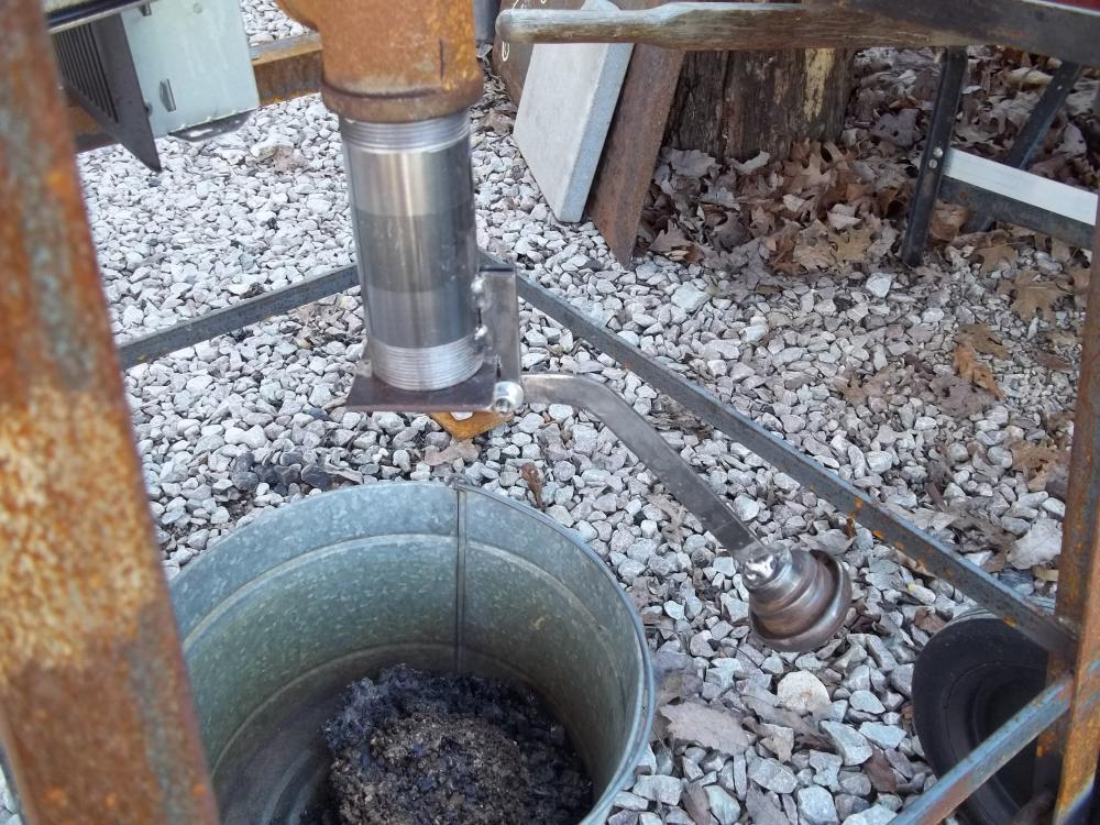

Floor flange to nipple to T to another down nipple and a hair drier is pretty standard in this day and age of $5.00 yard sale blow driers. Don't get fancy blocking the ash dump, a screw in plug is way more hassle than necessary. I have an exhaust stack flap cap on mine and it works a treat. It's just clamped on upside down with an extension on the counter weight arm so I can reach it easily under the forge table. The extension keeps it close more securely as well. All my solid fuel forge hardware is welded but plumbing works just fine and you don't have to wear a welding shield.

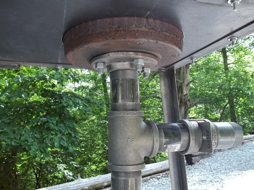

Shamus, here are a few early pictures when I was making my brake drum forge.  I simply bolted a floor flange to the bottom of the drum.  I built an ash dump similar to Frosty's.  I cutout and welded it from scraps.  The screw on caps are, as Frosty eluded to, a PIA!  I'm using a xxxx fan from HD for air, a blast gate (air gate) for air control.  I only open the gate 1/4 to 1/2 for most forging.  I've since added a hood which I wish I had done from day one.
As for the grating on the tuyere, everyone has a different type.  I started out with some 3/8" rod welded across the drum hole, spaced about 1/4" to 3/8".  They burned through pretty quick, plus welds on cast iron are not strong in this application.  Next, I tried some cast iron drain grates.  They also burned through pretty soon.  Finally, I made a grill out of 1/2" bar stock.  Forged a circle same as the I.D. of the drum, welded the 1/2" bar stock to it, and dropped it in.  Nice snug fit and so far it shows no sign of burning.  If it does, I'll just weld in some replacement bars where it burns out.  Some folks weld their plumbing together, but that's sort of semi-permanent.  I just screwed all my black pipe together and it will come apart very easily if I need to remove it for some reason.

When you are building your forge, no matter what the design, I STRONGLY recommend making a hood for it.  They are worth a fortune to get the smoke and a lot of heat out of your face.  I ran my forge for nearly two years before I got around (lazy, I guess) to putting one on and have never regretted it.  I got so tired of having smoke swirling around and choking or blinding me.  Plus, my wife has stopped complaining when I wash my face and the washcloths are no longer black!
There are a myriad of designs and fabrications out there, from fancy stainless steel to scrap sheet metal.  Whatever you can cob up, go for it.  I found a design for a rectangular one made of sheet metal that I fabbed up and stuck on mine.  I think I got the design drawing/photo from some post on IFI.
