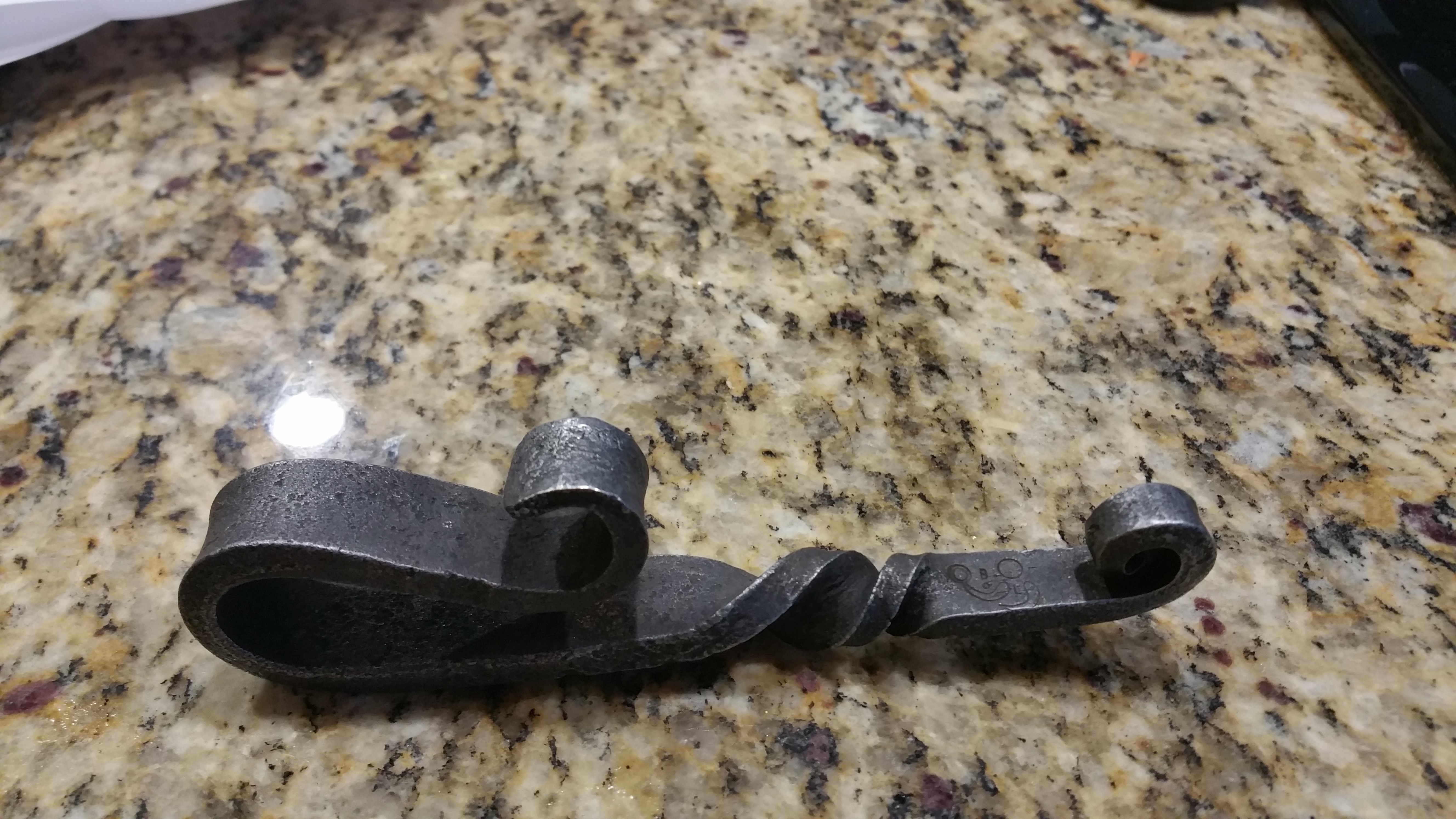

I just pulled 6 of these out of the tumbler from this weekends smithing after etching in vinigar overnight (they were tumbling during the video).  They were tumbled for 4 hours at about 25rpm.   It got all of the scale off and polished most of the exposed surfaces.  It didn't get into the twist and scrolls as much as I was hoping.  In an attempt to get more polished pieces I am going to try adding water and soap on the next run.

Looks pretty good but I don't think it's completely descaled is it? I'm thinking SS tends to be less abrasive than scale so might not be the best media. How about ceramic media?
Soapy water will rust the pieces almost as soon as they dry. If however you add some water soluble oil to the mix it should give you time to finish the pieces before they rust up. Heck, maybe add vinegar to the mix to help soften scale as it tumbles.
Forge scale is probably the hardest thing in your shop.  Most stainless is pretty soft until you abuse it somehow.  Might not act on scale as fast or well as you want.  That said you got the edges polished up, that's what most folks are after with a burnished or hand sanded finish.  Keep experimenting and let us know the results!

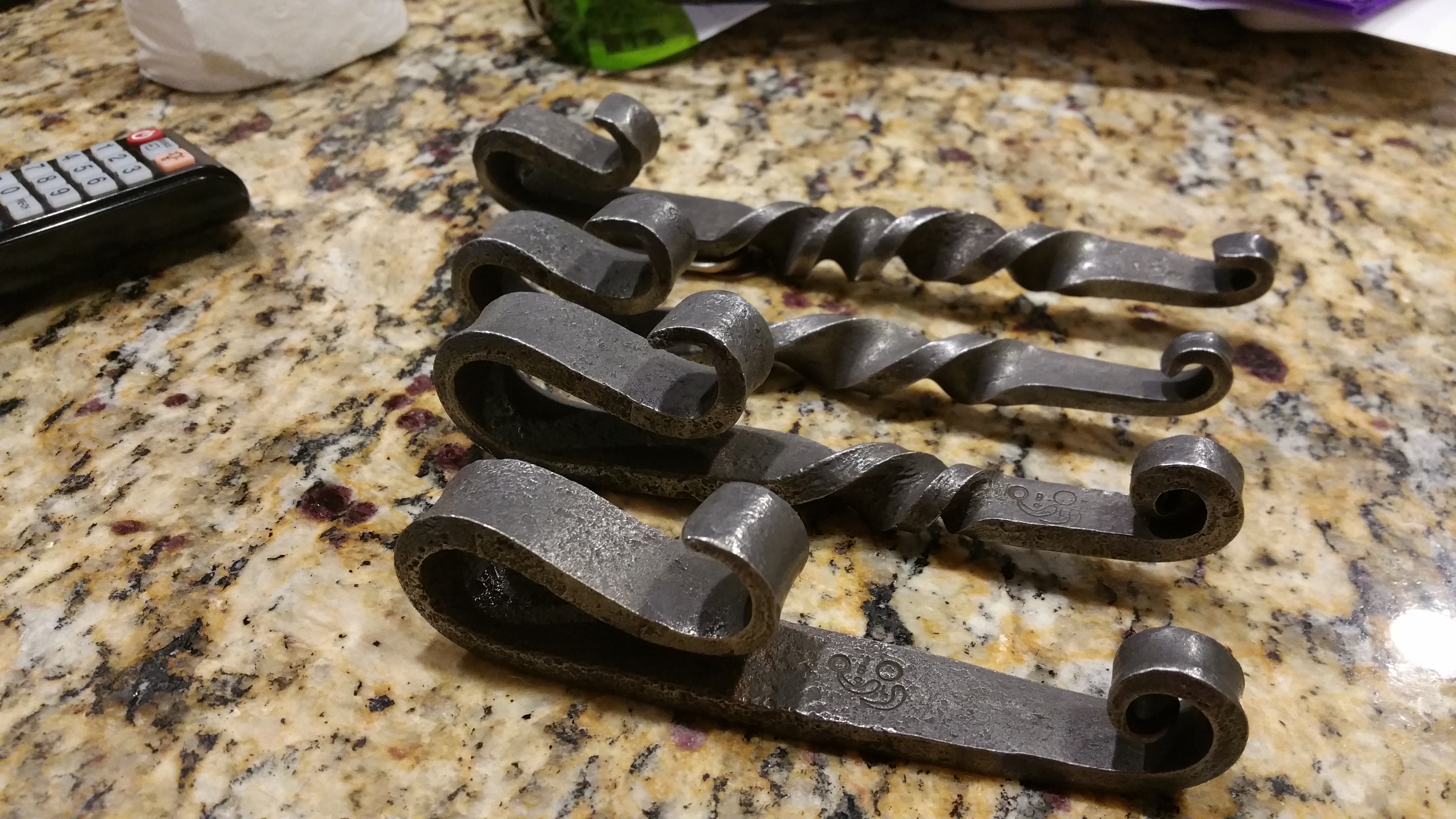

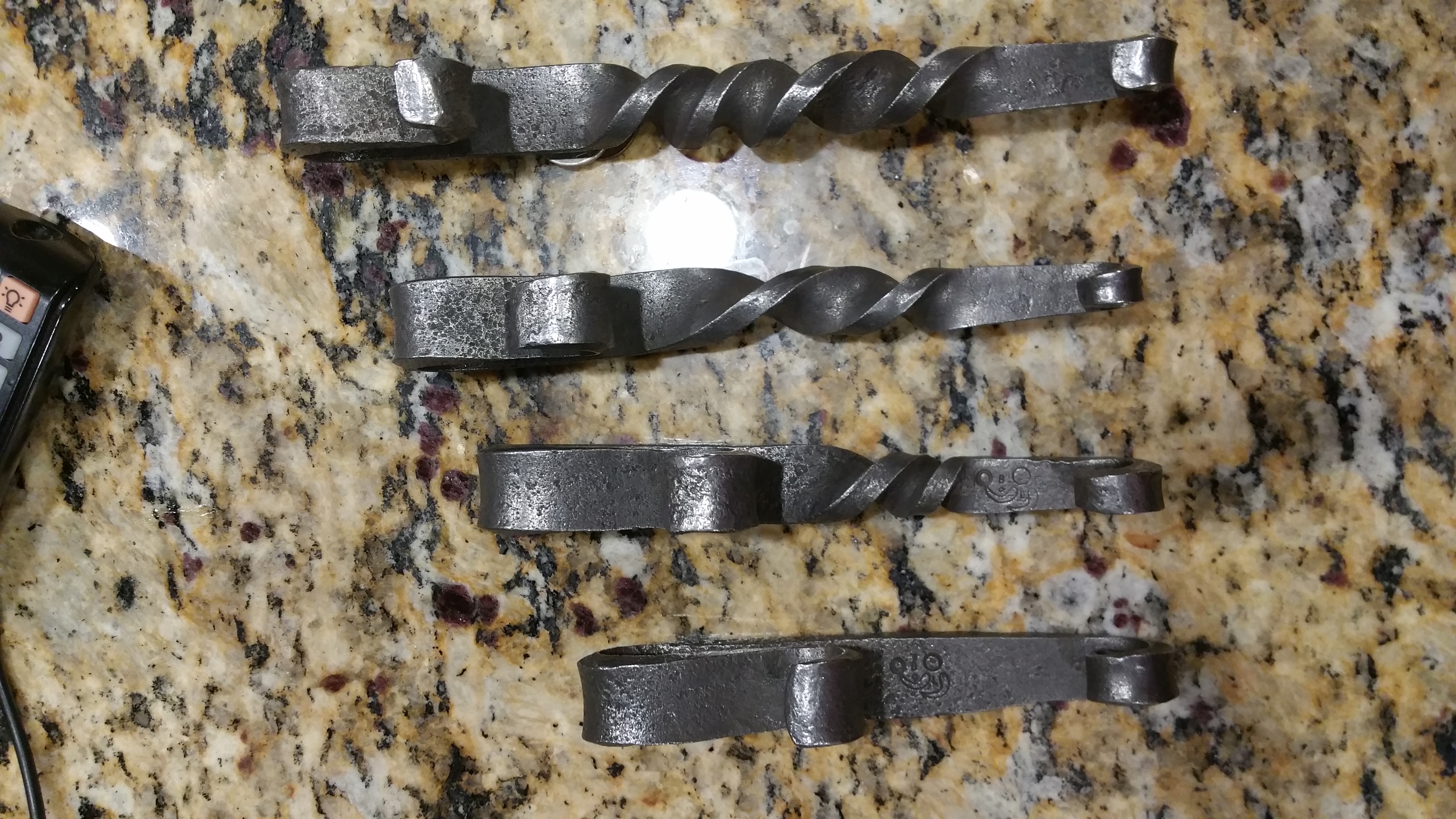

I ran another test tonight with adding simple green to the mix.  This really seemed to help.  It still isn't as aggressive as I was hoping but it is close to what I wanted.  The media doesn't seem to do a good job in the twists.  I ran the tumbler for 98 minutes for this second test which was probably less that half of the first run and the results were much better.

On the run tonight I ramped up the speed a little bit.  It was originally at 18rpm and I bumped it up to 25rpm.  I also added about a cup of simple green to the mix in the hopes that it would help with the scale removal.  I don't know which thing made the different but the results were much better after another 1.5 hours in the tumbler.  All I did was take them out of the tumbler and dry them with a towel before taking these pictures.
Try adding some pea gravel or maybe just sand, it needs some abrasives to cut the scale.
