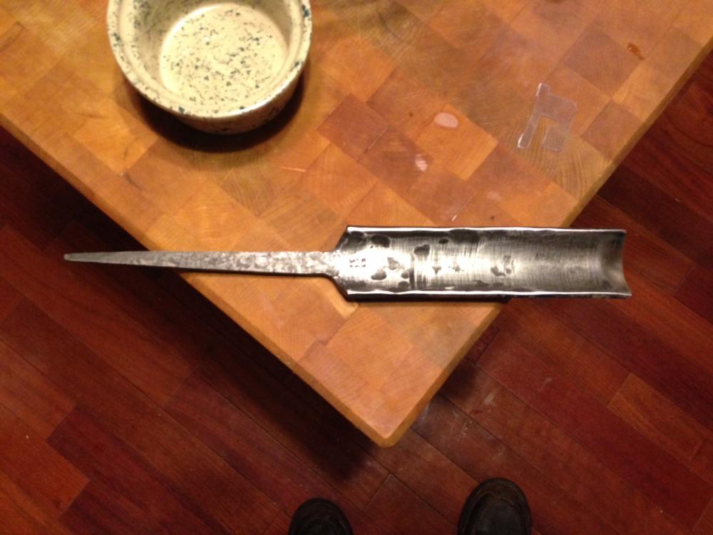

For me one of the best things about being a blacksmith is the ability to make tools you want.  My boss is retiring and the company got him a large 16-inch wood lathe as a retirement gift.  I wanted to give him something from me so I decided to make him a large roughing gouge. I used some 1/4 inch 5160.  Forged out a tang got the roll started in a swage block and rolled it up on the anvil face.  Its 1-3/4 inside the flutes.  I turned a handle out of a chunk of cherry and used a cutting shoe from a drill rig sampler for the ferrule.  Our company is a drilling and engineering company so using a company artifact so to speak adds some mojo.  I quenched in hot veggie oil and tempered the edge to not quite straw while burning in the tang.  Cuts pretty good these large chisels are great to tuck under your arm while you are getting a large irregular chunk round for safety.
Nice gouge Matt, well done.
Would that have been an AW split spoon sampler? That'd just be a WILD guess of course. It looks WAY small for NW and certainly not a continuous. Driven SPTs before? . . .Who,  ME? (shhhhhhh folk  think I'm a respectable guy  now) <wink>
  1. Frosty you have a keen eye, AWJ split spoon for sampling.   I was tempted to touch it with the file while on the lathe, but all those cobble score make it real, I just shined it with a cork belt.  Thanks.

I like the look of it!  As an old turner though I would NEVER tuck a gouge under my arm... Especially while roughing!
bigfootnampa, seconded.
Actually whenever there's risk of high enery catches, such as when roughing or working on the outer circumference of large, heavy bowl blanks,
I just pinch the handle horizontally between two fingers, so that if it snags, the tool goes flying without breaking any of my fingers. It very rarely snags, tho.
If you ever feel you need to resist the handle lifting, then the solution is not to hold harder, it is to sharpen the tool, spin the blank faster and ride the bevel.
The weight of the handle alone should be enough force.
Tucking is something you can do for comfort with a treadle lathe.
