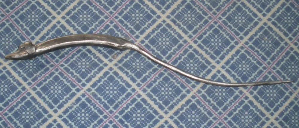

Below is a pic of the drum carder, Doffer I came up with. This is Deb's  Doxy Doffer and the couple I made for guild members have a cable twist handles. The curved handle makes it easy to push or pull and the bend in the "tail" provides leverage to pry the wool through the cards up or down. After brushing I finished it with lanolin from raw wool so it won't stain. It also lubricates so it lips under the wool more easily. Deb keeps a bit of raw wool with it to refinish as needed.

Deb's  Doxy Doffer
  Very unique, I like it very much.
Yes, pineapple twist is what I meant. I break the edges on pineapple twist handles I make for the ladies or they're too sharp for comfort. Men like the sharper corners, I know I find the sensation pleasant but I am one of those brutish men.
Thank you Scott. They functioned really well as a doffer too. One of my little successes. I only made the one doxy animal heads don't let a person push on them with their palm. A leaf turned as a gentle hook works very well, the leaf fits comfortably in the palm to push against and you can hook a couple fingers on the other side to make pulling easier.
