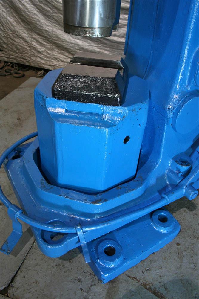

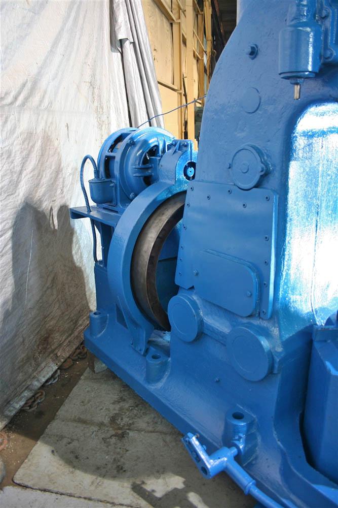

So as you guys know there is a little hammer heading my way.
I figured it was time to start a separate thread rather then continue the gentle hijack of the other one.
It now belongs to Mike L. and will be set up here in our shop. The current intention is to move the Beaudry #8 to what will be the back wall of the shop and place the Nazel in its place.
The seller stated that this hammer had been a trade-in on a Nazel 6B but I dont think they gave anymore info. If anyone knows anymore about it please let me know!.
I talked to the gents at Postville Blacksmiths shop today in relation to moving and general weights of the individual pieces. I have arranged for a 15,500 lb capacity forklift with pick up and delivery here rather then try to use a catapillar 966G that they have on site next door at the quarry. While the 966G has the lifting power I was concerned with its ability to lift high off the trailer and control in setting the hammer in place. On top of that its huge! It will be easier to manuver the forklift.
They also recommended to wait to hunt for dies till we have the hammer were we can take accurate measurements of the dovetails as they are often altered from factory. I think our current idea is to purchase material to make a new set and cut the dovetails here once we inspect the hammer. I use a local heat treater that can handle hardening in just a couple days on parts like this. They already have harden hammer dies for 2 different big drop hammer shops (Victory Racing Plate and formerly for Kirk-Stieff Silver)
I also spent some time with Dave Hammer at the BGCM's Blacksmith Day's in Westminster MD this weekend. We mainly talked about foundations and issues if the hammer has been abused.
Currently we have a 10hp rotary converter in the shop that will have to be increased or purchase a big VFD. We were beyond capacity anyway so its time to upgrade.
Pics of the hammer from the ebay auction...

Someone has pointed out to me that the plate on the left side of the casting is an odd cover likely hiding a repair. I'd like to hear thoughts on this from those who know more then me!
