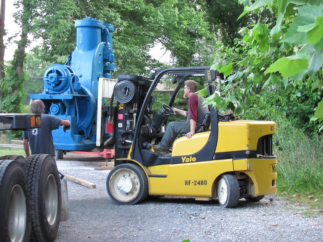

Its looking like we have confirmation on a June 25th delivery date. The concrete has a couple weeks on it now and it will be close to a month of cure time when the hammer arrives.
Now I just have to clean the area to get the trucks and forklift in, which of course involves moving 2 other power hammers! Not sure I've done the best planning here but I think I can get the puzzle worked out.

You may get to see it anyway Dave. The rigger is telling me he can't get a truck this week. I'll know more in a couple hours but this sucks. Hopefully I'll have enough time to cancel the lift truck if it is postponed.
Either way I'll use the time to set the Beaudry but I can use a much smaller (cheaper!) lift for that or maybe get the quarry guys to move it.
Happy news.. the hammer is being loaded right now and is expected on time for delivery.
I dispaired too soon!
Kerry...
I'm glad it all worked out. I'll miss the delivery, but I will come to see your shop (and the hammer) some Monday during July.
Interesting day. Hammer came a day early. Thankfully so did the forklift!!
Gives me a needed jump on the day for tomorrow.

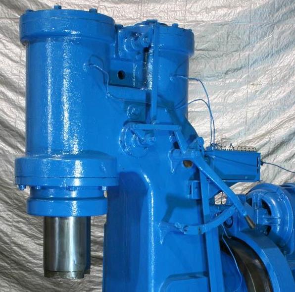

Hum somethings missing here..... It will be interesting to see how this works out.
Ebay pics as part of the machine description....
Broken while lifting it :huh:
Don't run it dry :rolleyes:
A beautiful baby, I'm terribly jealous :angry:

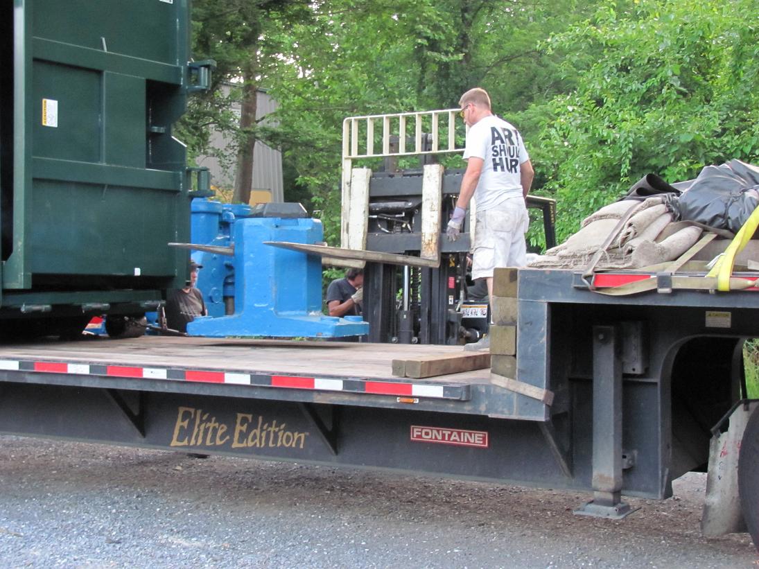

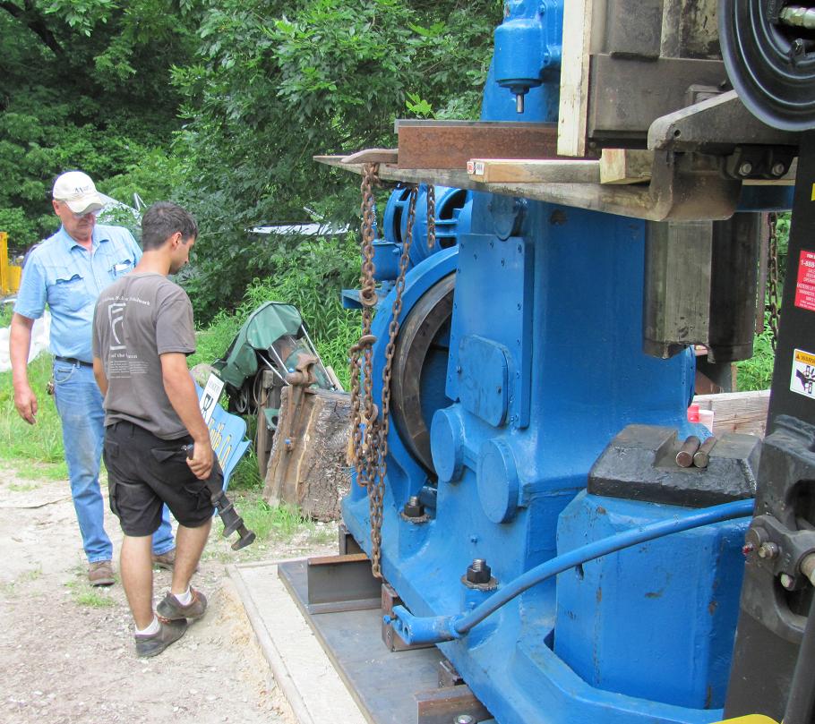

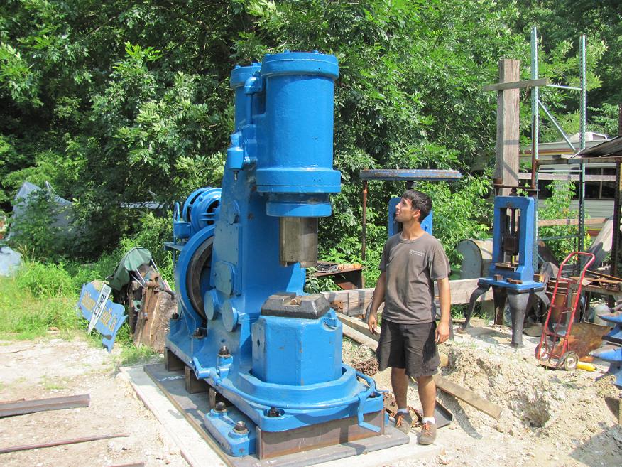

I watched this morning as Mike and Kerry got the 4B on to the supports that bolt to the hammer frame and are (or will be) welded to the steel plate. The last picture above is Mike in his well deserved victory pose. I expected a crowd, but just me (at least until 11:00 am). Just as well, I'm sure because there was a lot of fussy work by the boys to get perfect alignment. Congratulations to both of you for the time, ideas, and $ invested. Very impressive and will be more so as work continues.

John understates how perfect his timing was coming by. Having a third set of hands made a huge difference getting the risers lined up. There is nothing quite like having an experianced power hammer builder show up at your site to help you install a beast like this.
Having John show up is kinda like having John Wayne show up to tell you 'Go ahead pilgrim, I got your back'
Yes Mike, its bigger then you thought!
I want to thank everyone that has helped me with this hammer so far.

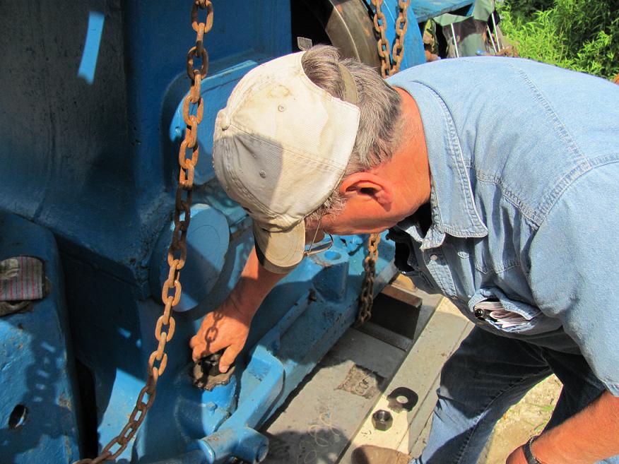

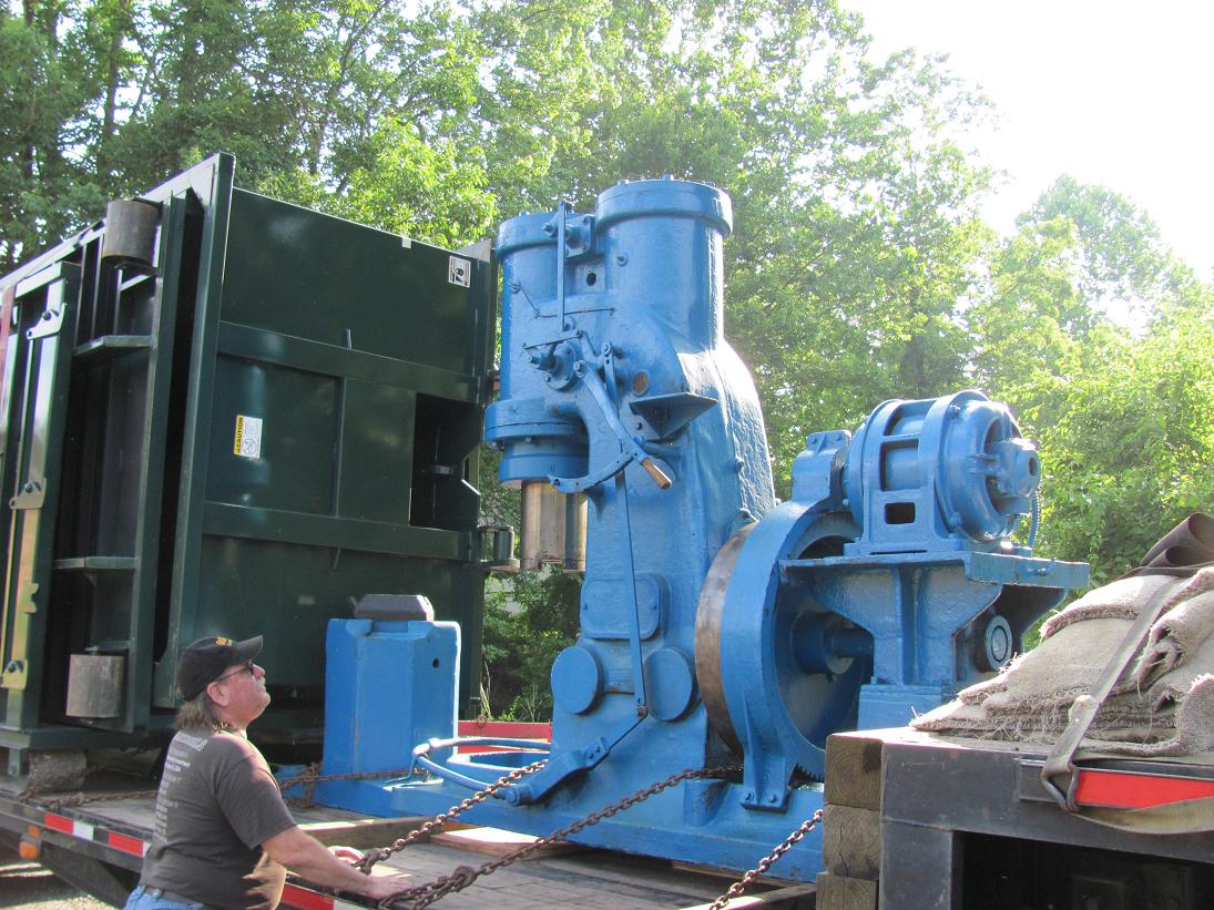

Here are a few shots of the hammer being installed
Kerry cutting the studs
Picking the 2" base plate

Hammer coming in
Hammer in place and welded in

She still needs some more work, but it is all rolling right along.

So is this hammer going to live outdoors? Or are you going to build a building around it? Or???
What is the construction of the risers that eleveate the hammer to line up with the anvil?
The building is going up around it. Actually it will have a roof cantilevered over it from the main structure. The 250 Beaudry is cattycorner across the room on a 2 ft thick foundation (or it will be in about an hour!) The Iron Kiss 90 lb beam hammer will go directly to the nazels right and the drop hammer will go back where it was about 15 ft in front of the Nazel.
The risers are 2 sections of 8" channel 1/2" thick set back to back, plug welded with several gussets and end plates welded in(basicly making an I-beam with gussets). The machine is bolted in place and the risers are now welded to the 2" steel plate. I wanted something more substancial then others we saw tied to concrete directly. Threaded sections are 1.5" around and the washers are 1/4" steel. We may add to the front riser at some point once we make a decision how the standing area around it will be handled.
Dave Hammer actually has his anvil (3B) set like this but with hard maple between the anvil and plate. It seemed counter productive to isolate the anvil from the plate so we went with a direct approach.
The plate will be tied into the concrete to prevent it from walking/rotating.
The single sections of 'C' channel you see in the pics are just there while we were finishing the risers, just in case the forklift allowed the hammer to lower while it was sitting. (which it did!)
Where will the floor be? The anvil looks too high already..add the die to that and it must be 4foot off the ground.
I would have mounted my 3B like this or similar, if not for the die height (or my inseam shortness).
Ric
See the beam behind Mike? The base of that is the floor level, so up about a foot at the back. Right now the dies would be chest high on Mike and that doenst seem fair!
