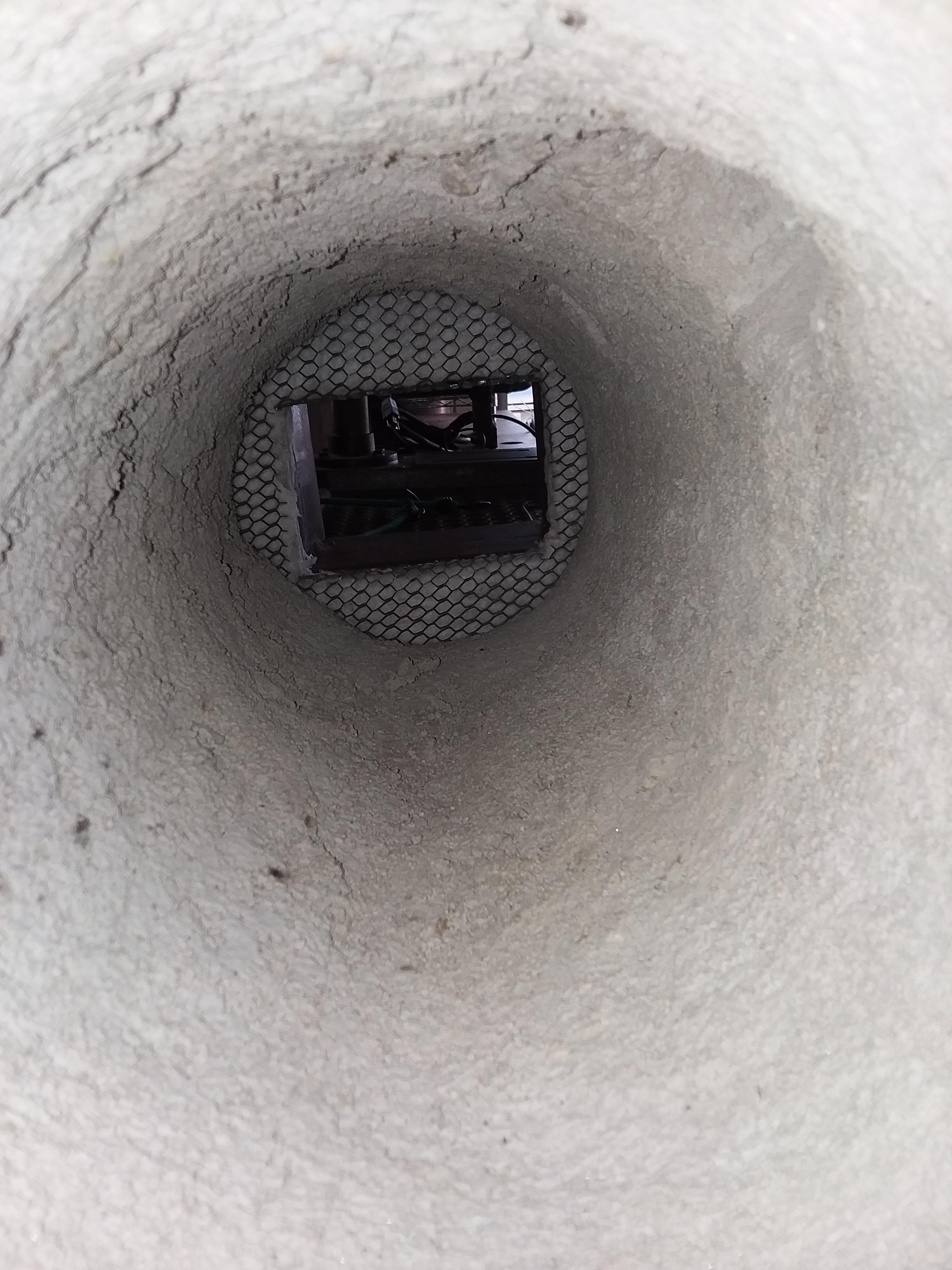

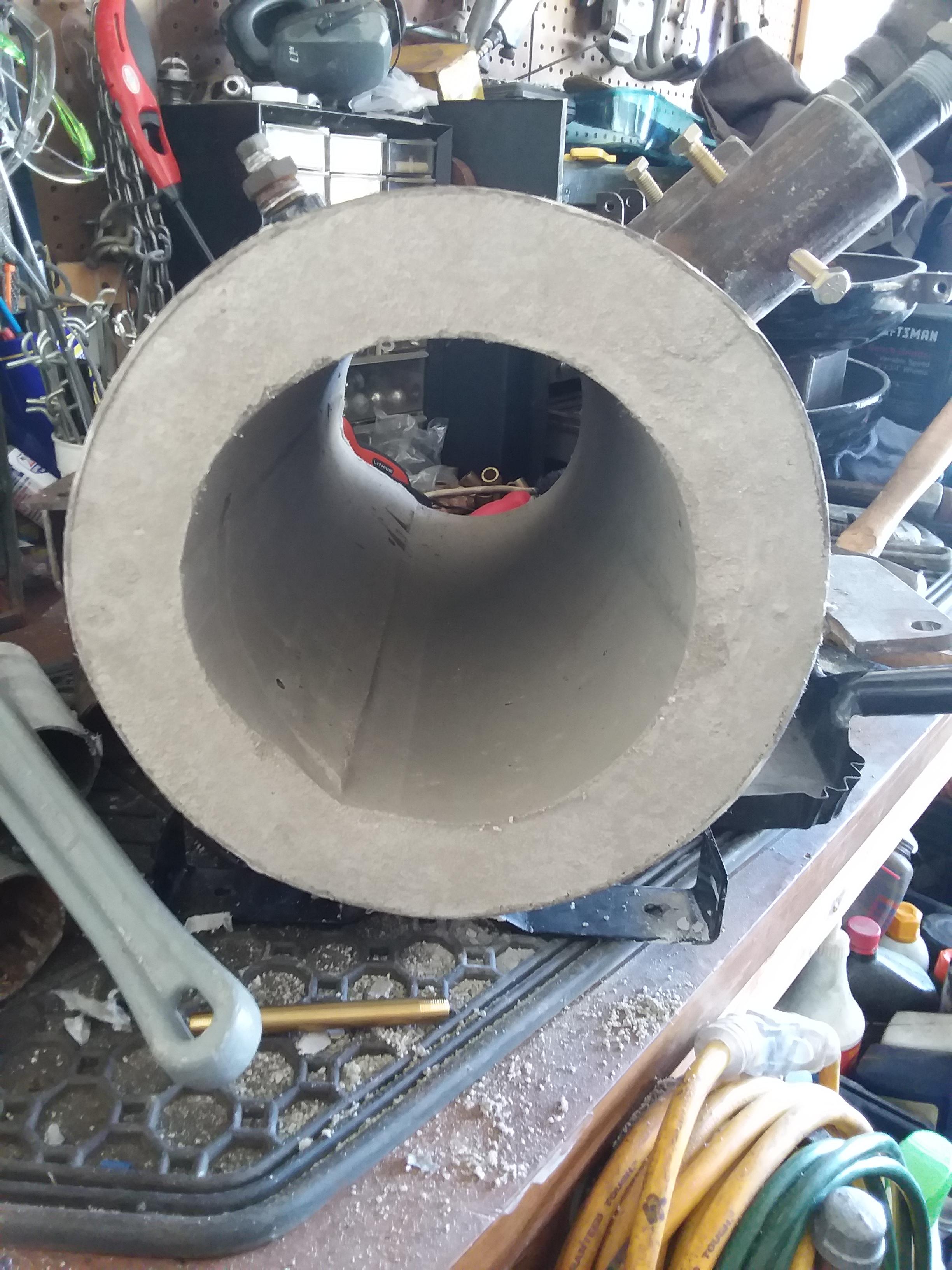

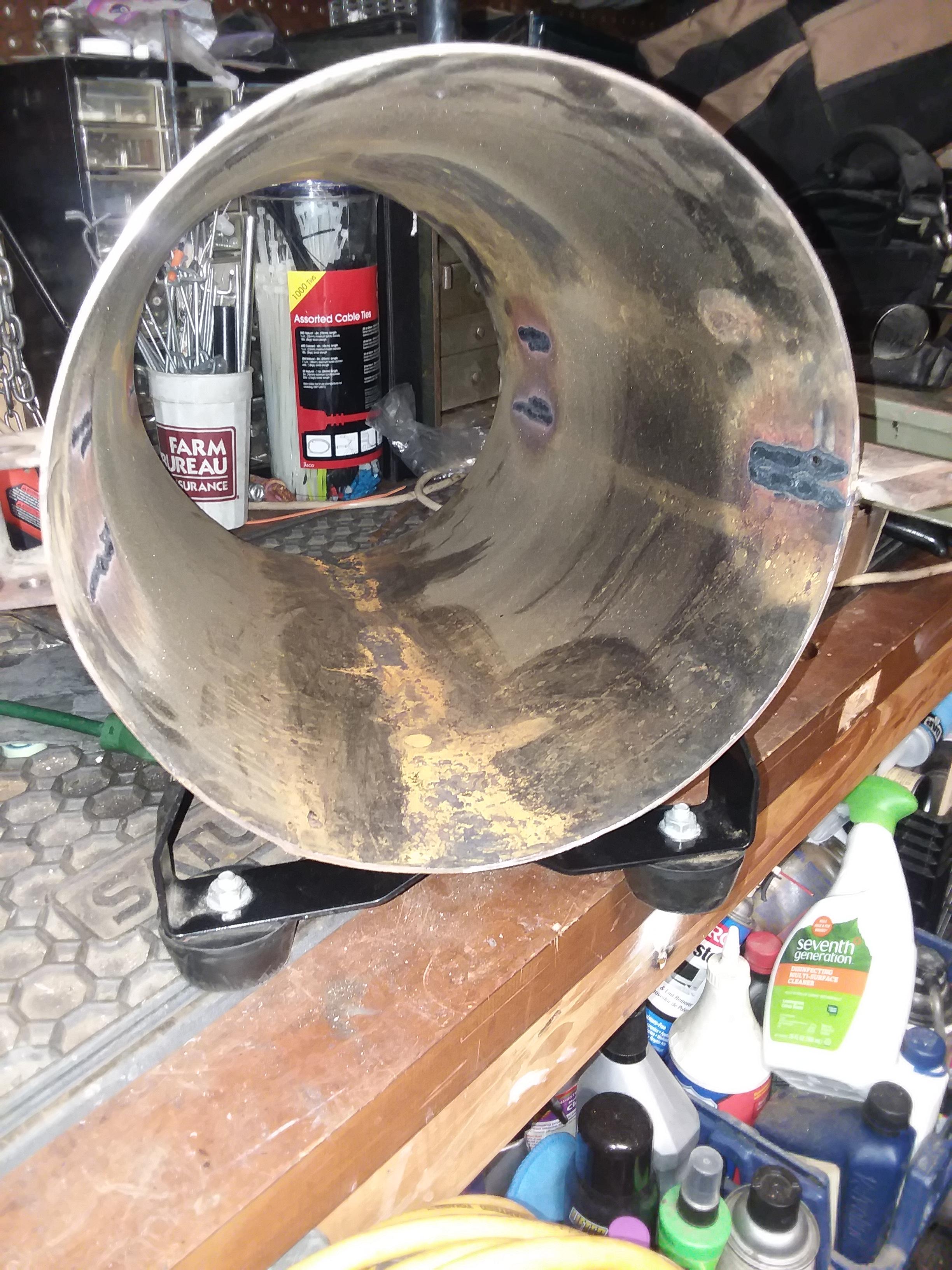

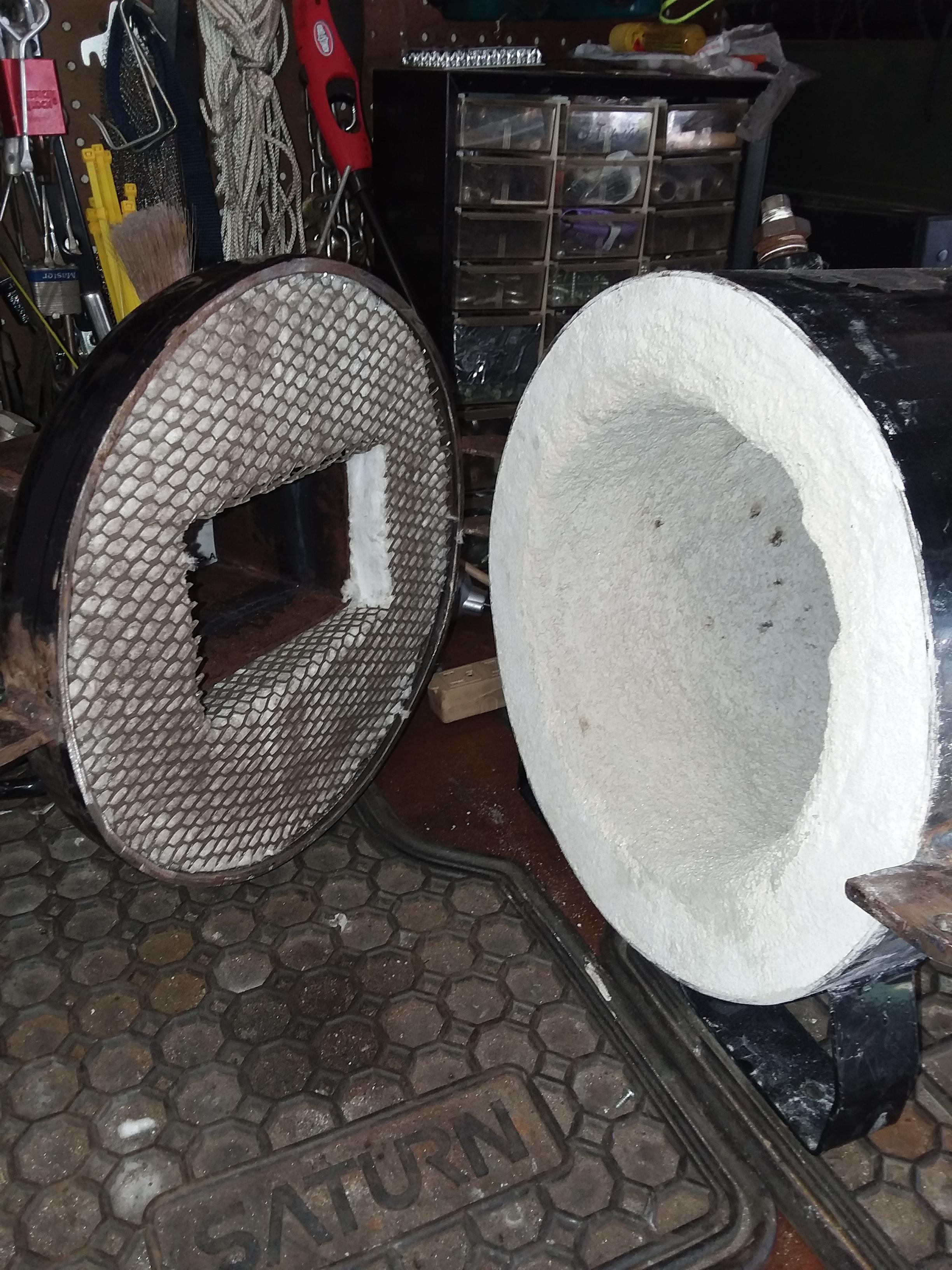

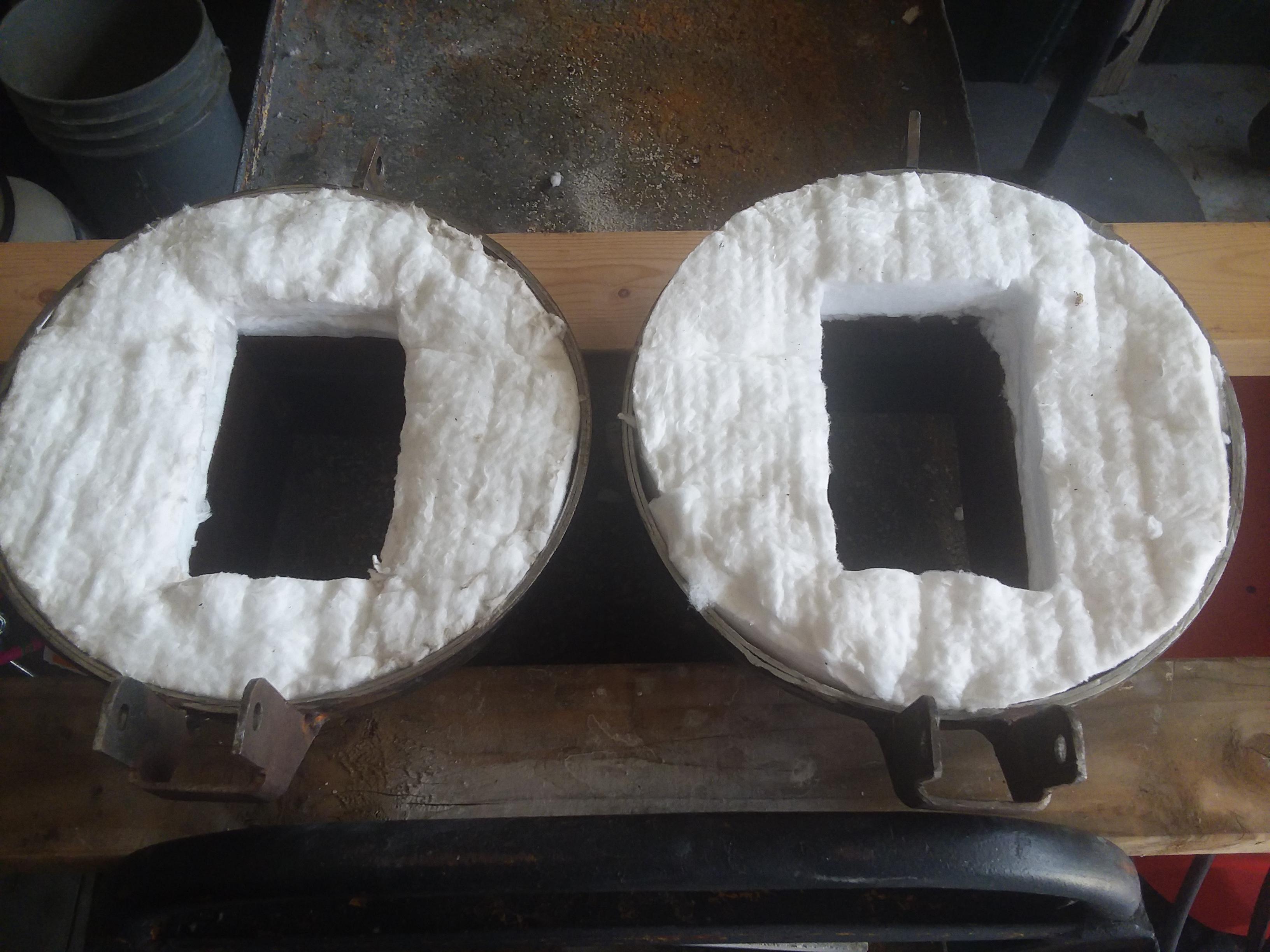

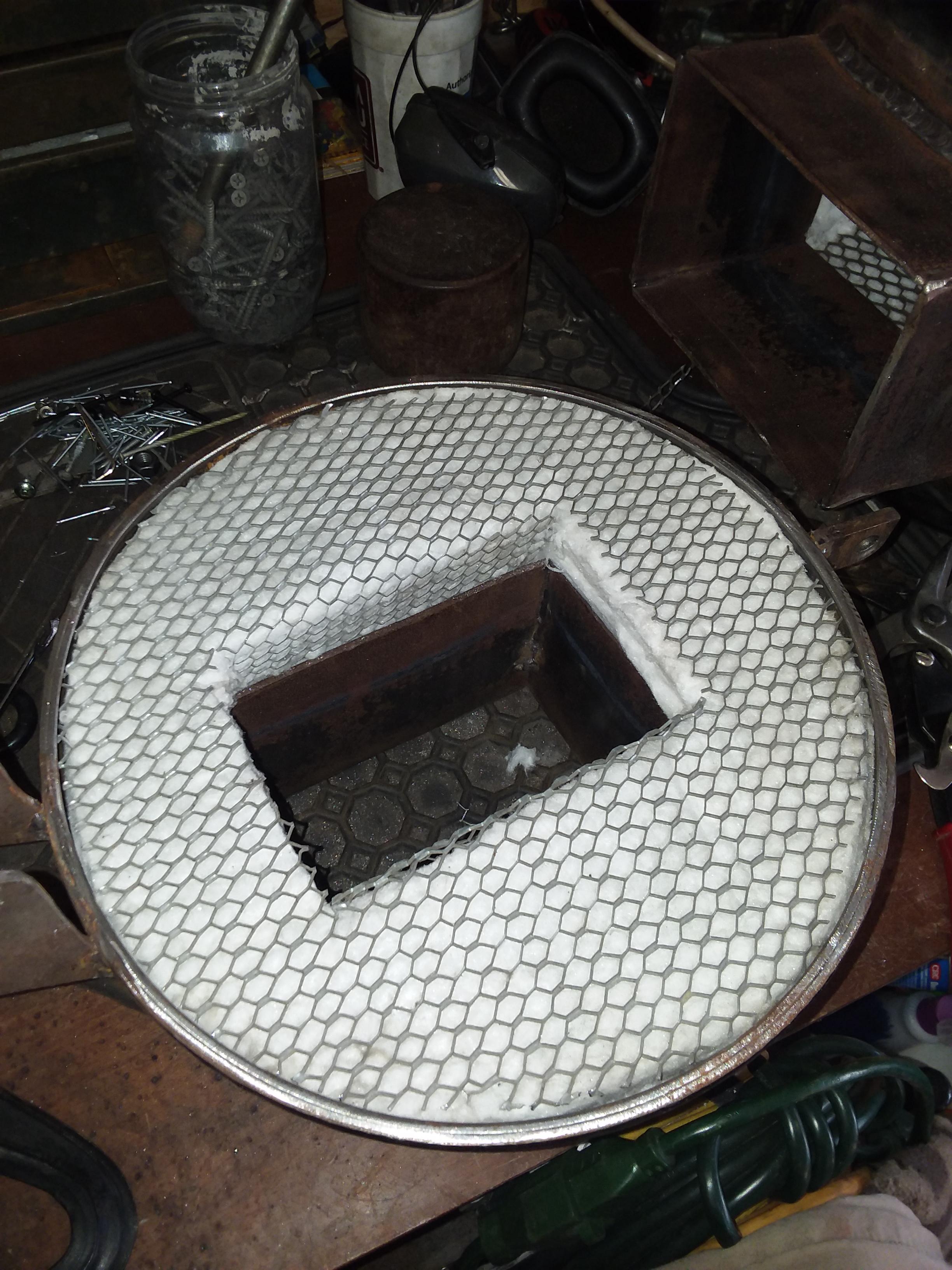

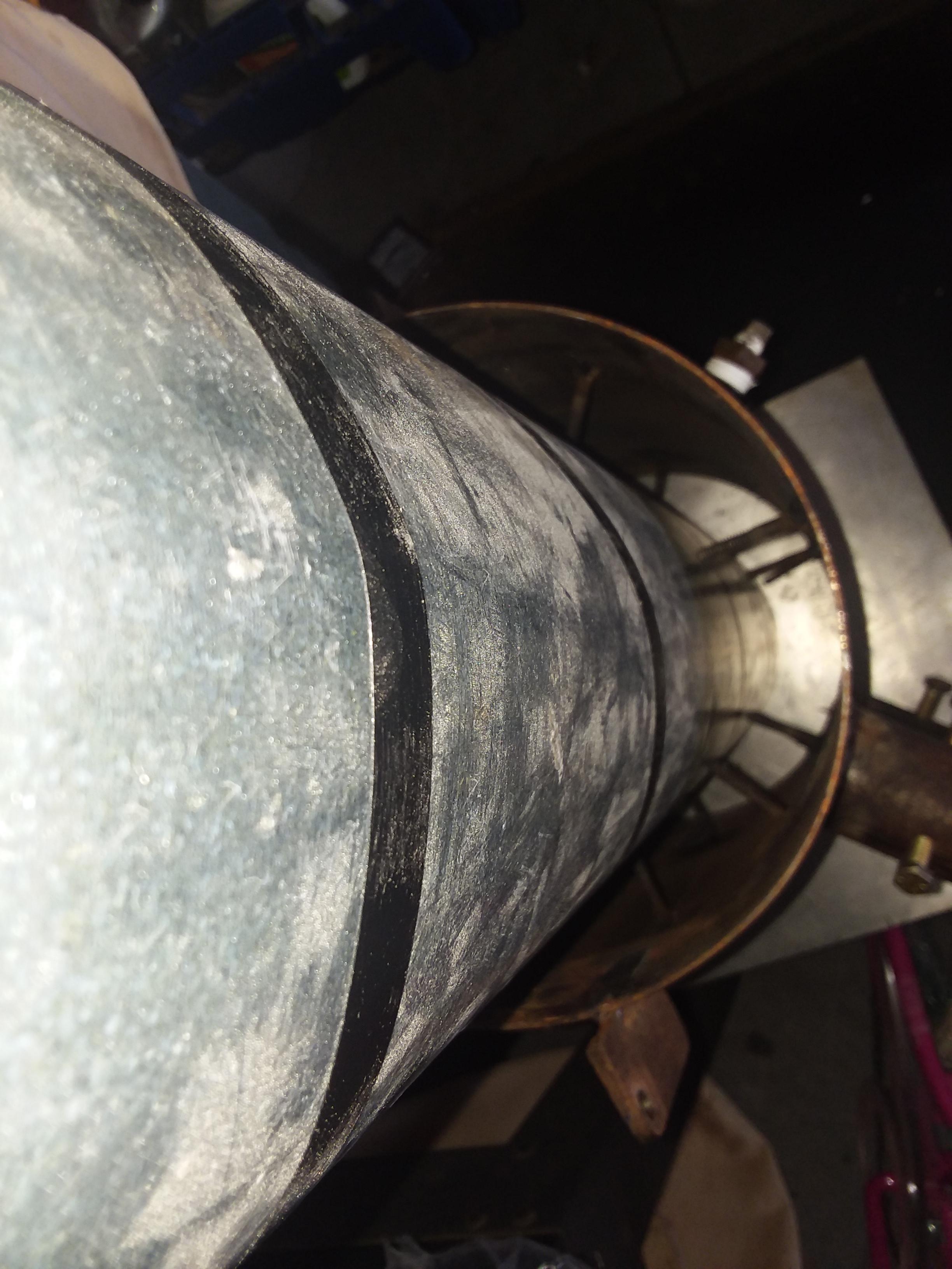

After I last posted, I felt a surge of ambition, so I went out and chipped out the castible. It wasnt as difficult as I anticipated. I had some 2" Insawool on hand so I carefully sliced it into an aproximately 1" layer. I sprayed 3M super 77 glue inside to hold the wool and now I am reseraching rigidizers. Pnut, I looked into what you called "hydrophobic colloidal silica" turns out they sell the stuf at West Marine near me. The only thing is, I cant find much information on using it for this application. It is definitely the nore cost effective option. Real wool rigidizer on amazon runs north of $30 while the thing of silica is only $15 and I could get it right away. Alas, I dont want to be in the same boat I was a few days ago, tearing out and re-doing...

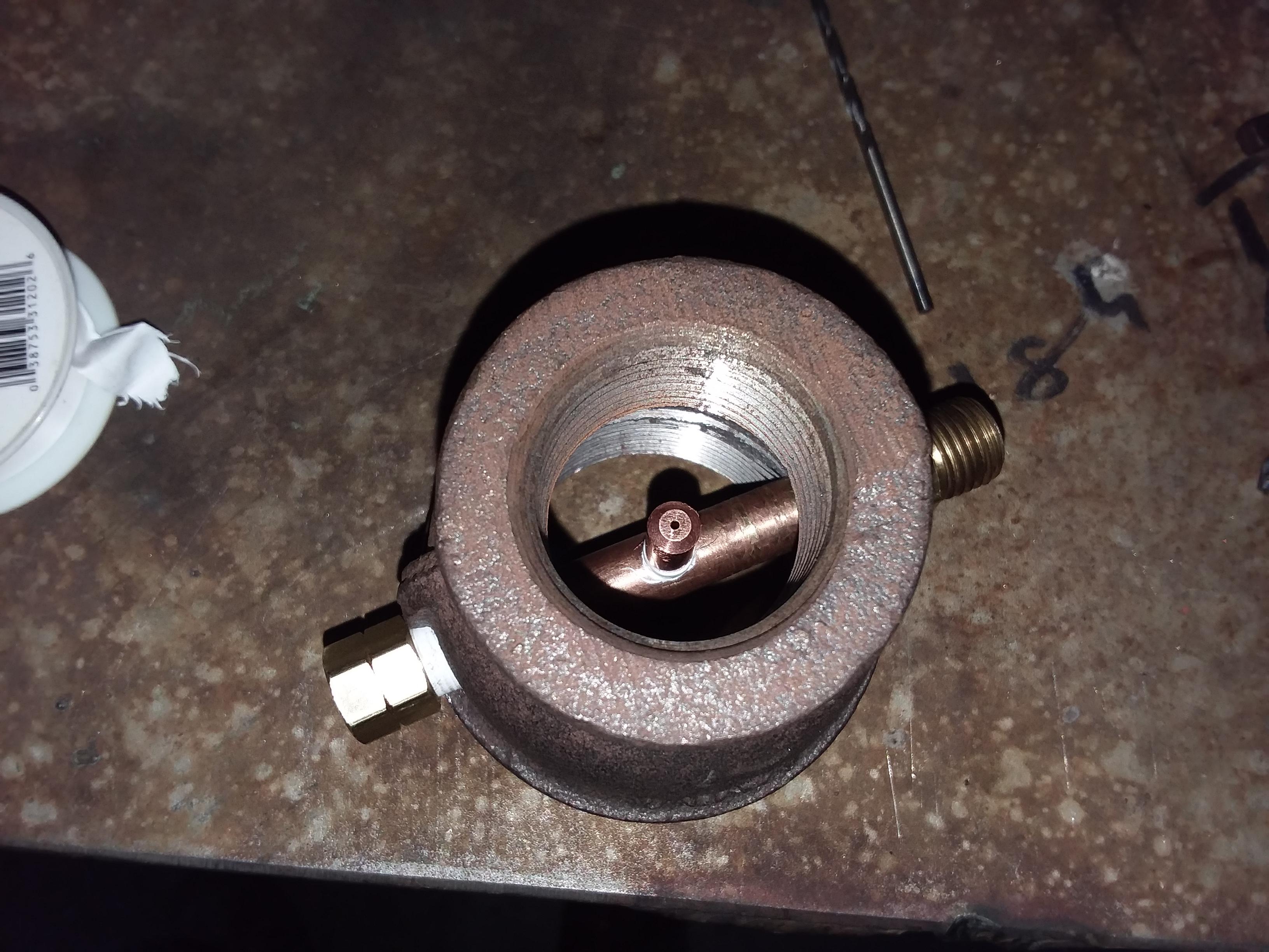

Well said, Pnut. Thanks for the encouragement! I actually found the burner to be quite easy! From the looks of it, it has a consistent flame and I am optimistic about it. We will see. Wonder how hard of a time that castible is going to give me as I chip it out?
Punt,I read it, however I was already 75-80% underway before I found it. Reluctantly, I will most likely be doing some chipping and relining. I just hate having to back up, but I think it will be worth it to re do the lining. Marcus and JHCC, i will definitely take your thoughts into consideration. Thanks!
I thought there was some spray out there that would stiffen up the surfce of the wool. My question is this, suppose I been out the hard refractory and put in the wool, how tough will the refractory e with the softer wool behind it? Will it want to collapse? That ws my concern from the beginning before I stumbled upon iforgeiron...
Thanks for the advice, Marcus. I am afraid of the refractory issue. Its going to be some nasty chipping if i have to to start over. I had her built before I found the forum so here goes. I will put some on the doors as per your recomendation.

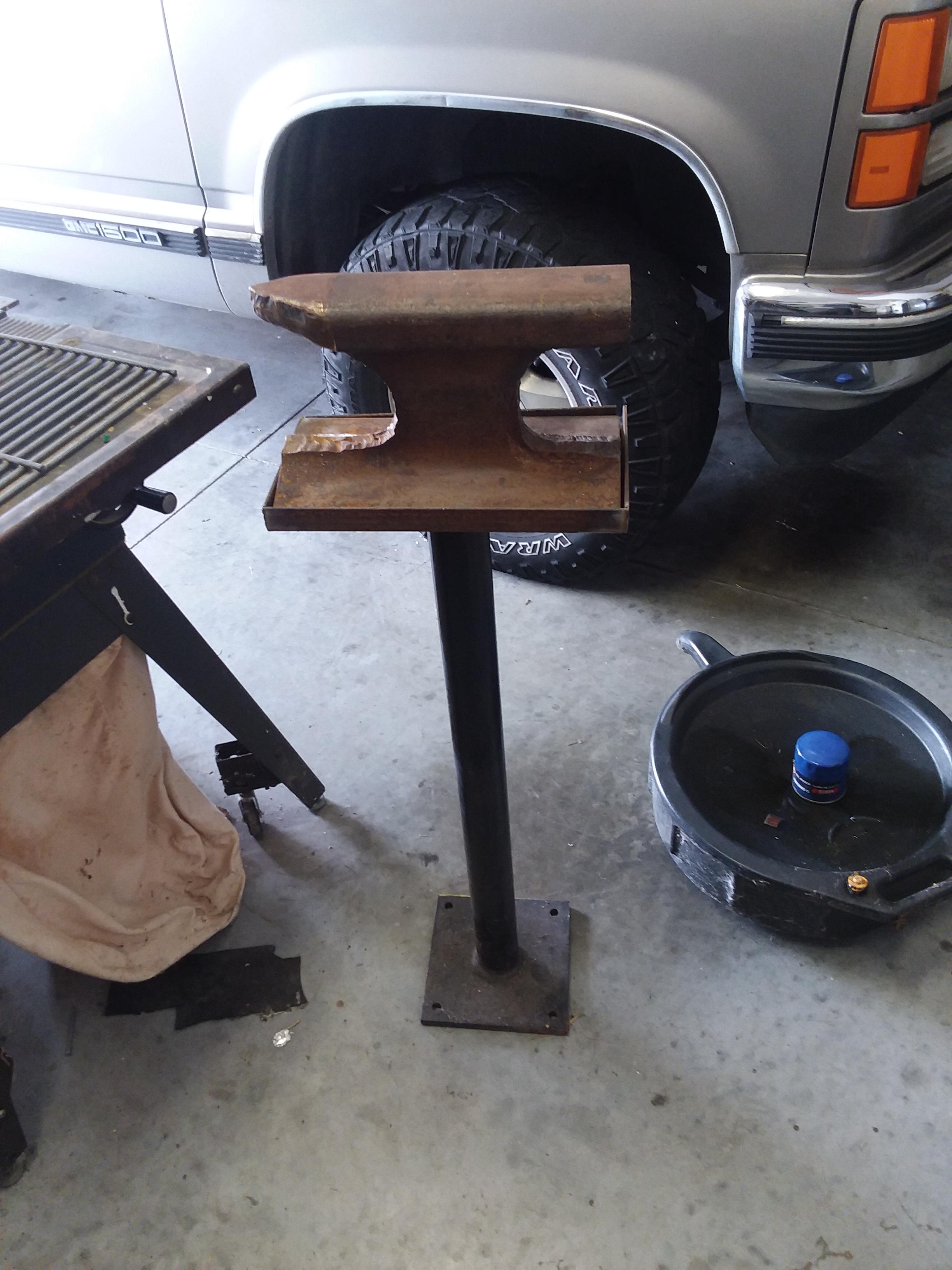

ALCON, Just a little update on the forge progress. As discussed before, she hasn't been proven yet. Its been a fairly busy summer around here. Anyway as far as construction, here's what went down this past weekend... ...added some stainless expanded metal to the doors. We will see if it holds up to the heat. ...oh and I made a stand for the DIY Anvil stand too. I know its top heavy. I'm going to beef the base up later.

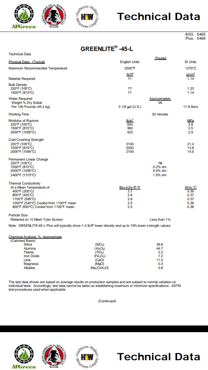

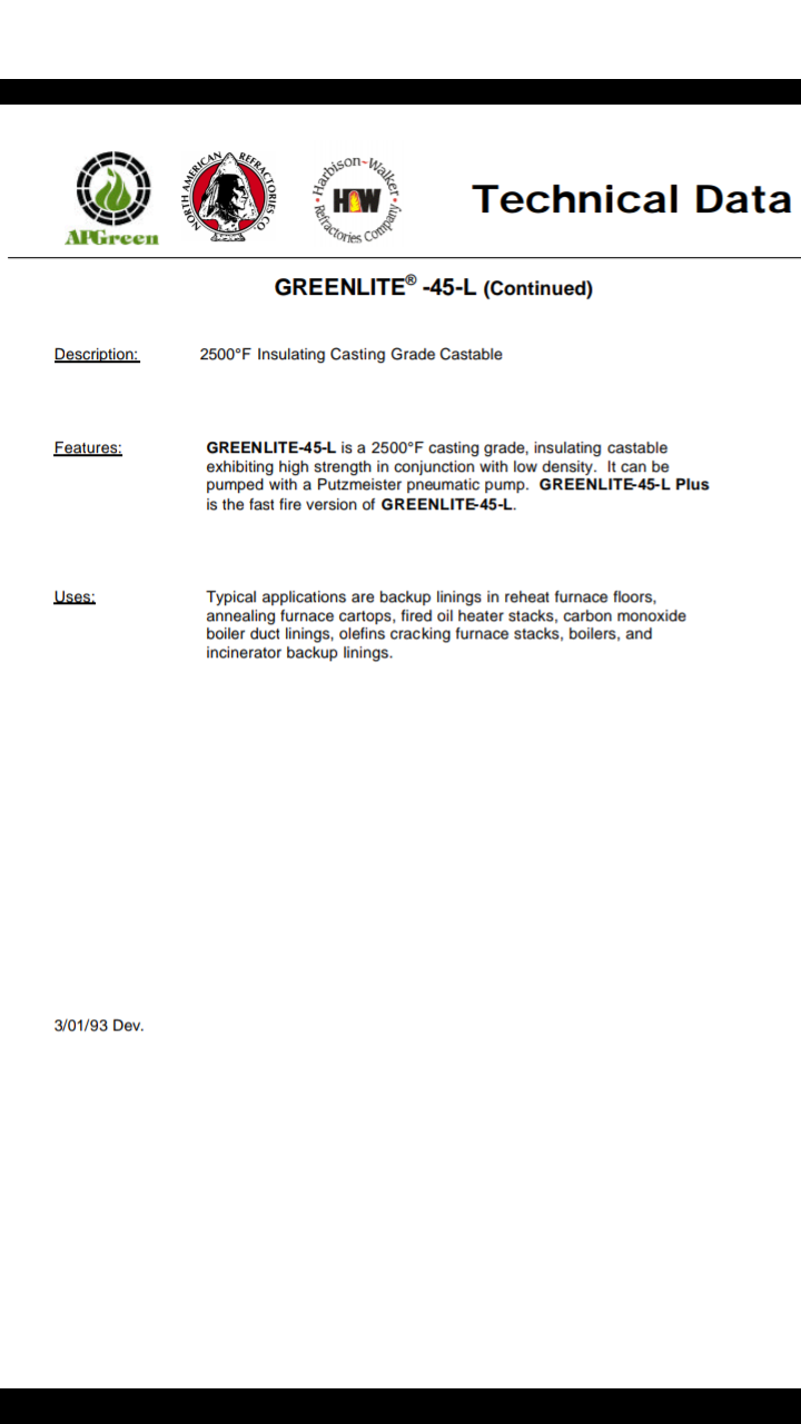

Buzzkill, thanks for the encouragement. Thomaspowers had me thinking my forge was jacked when he didn't know exactly what I had, but in his defence, nor do I totally. Being a noob is tough sometimes. Since the refractory in the boilers at work is designed to keep the heat inside the firebox, and thus enhance efficiency, my logic said it should do fine. We will see. Who knows, if I have to eat crow, I guess I could just it out and start over as per IFI instructions! Standby for function test!
Genuinely, thanks for the helpful advice. I know that that the sages of IFI consider not taking their advice as anathema, but be assured, the mistakes that I may have made were comitted before I found IFI. Alas, since i have made it this far, I guess I will give it a whirl as is and see what kind of heat retention I get. Since the variable in question is the type of refractory I used, we will just have to see. I have been looking for a formula for calculating forge efficiency, but have come up dry. Is there a sticky for that? I know the area of my forge, so if u can find the formula, I can plug in the specs from my refractory info and everything else. Thanks again for the help.
...and nothing I mentioned had anything to do with being an educated on heat transmission, expansion and calculation. When I find a formula I will try to see if my set up is satisfactory. In the mean time, here is the tech data from my refractory.
Thanks for the advice, ThomasPowers. I admit i am a greenhorn, but the technical data on the stuff I have says it is rated for 2500° F. Being new to the forge universe, I can't confirm or deny this. The only YouTube advice I have used is on the burner, which i took with a grain of salt when I had to modify it.

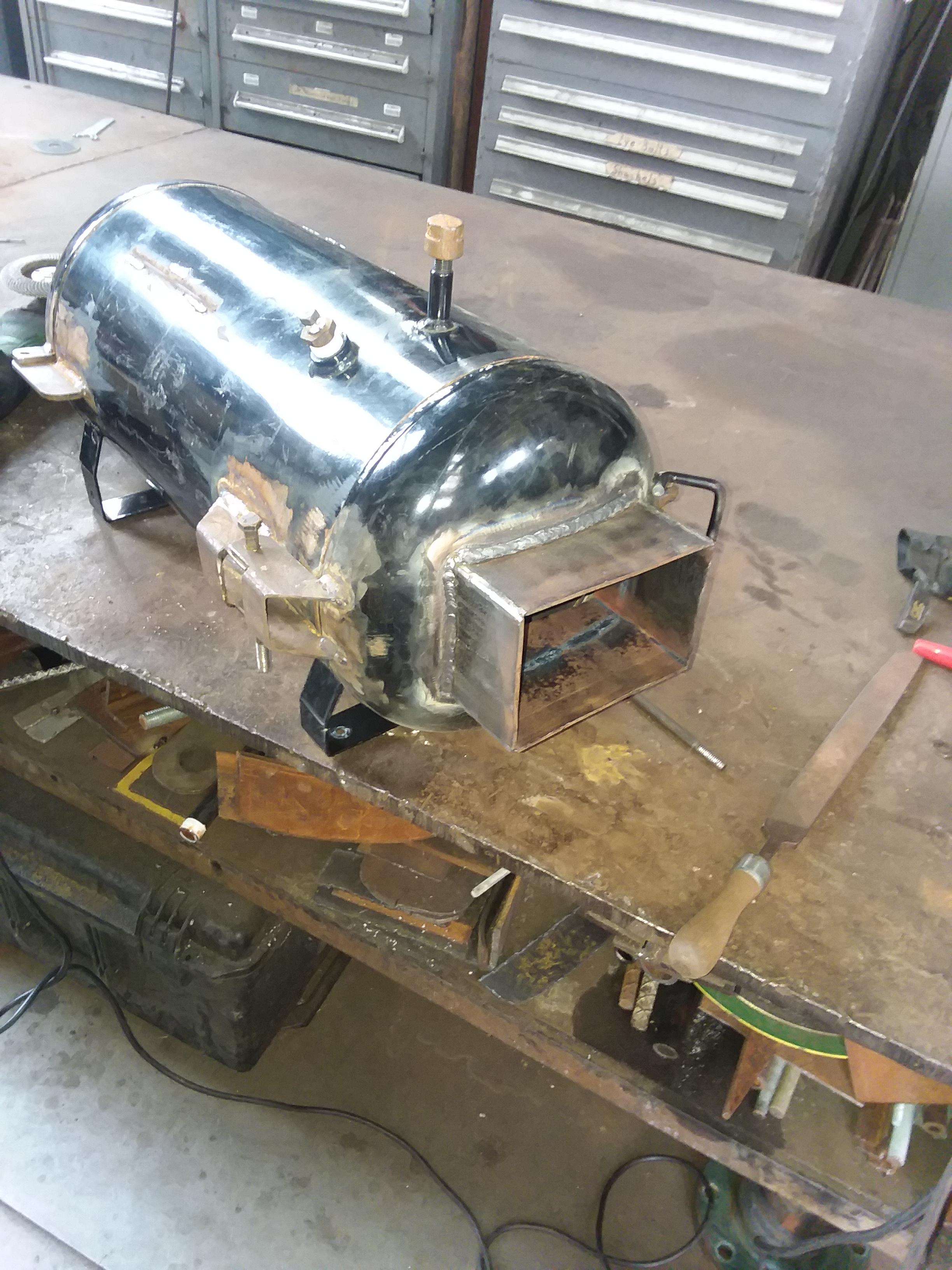

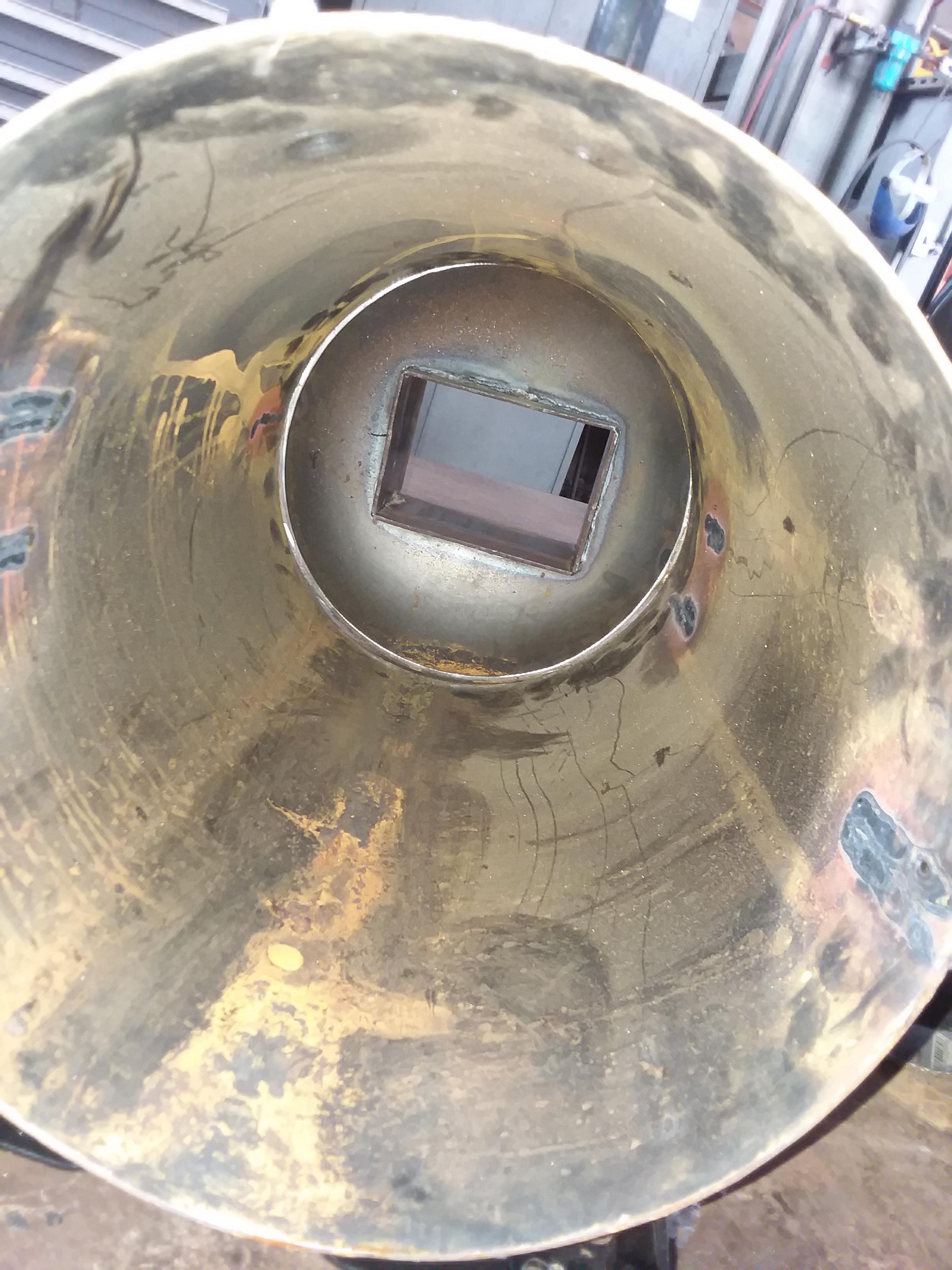

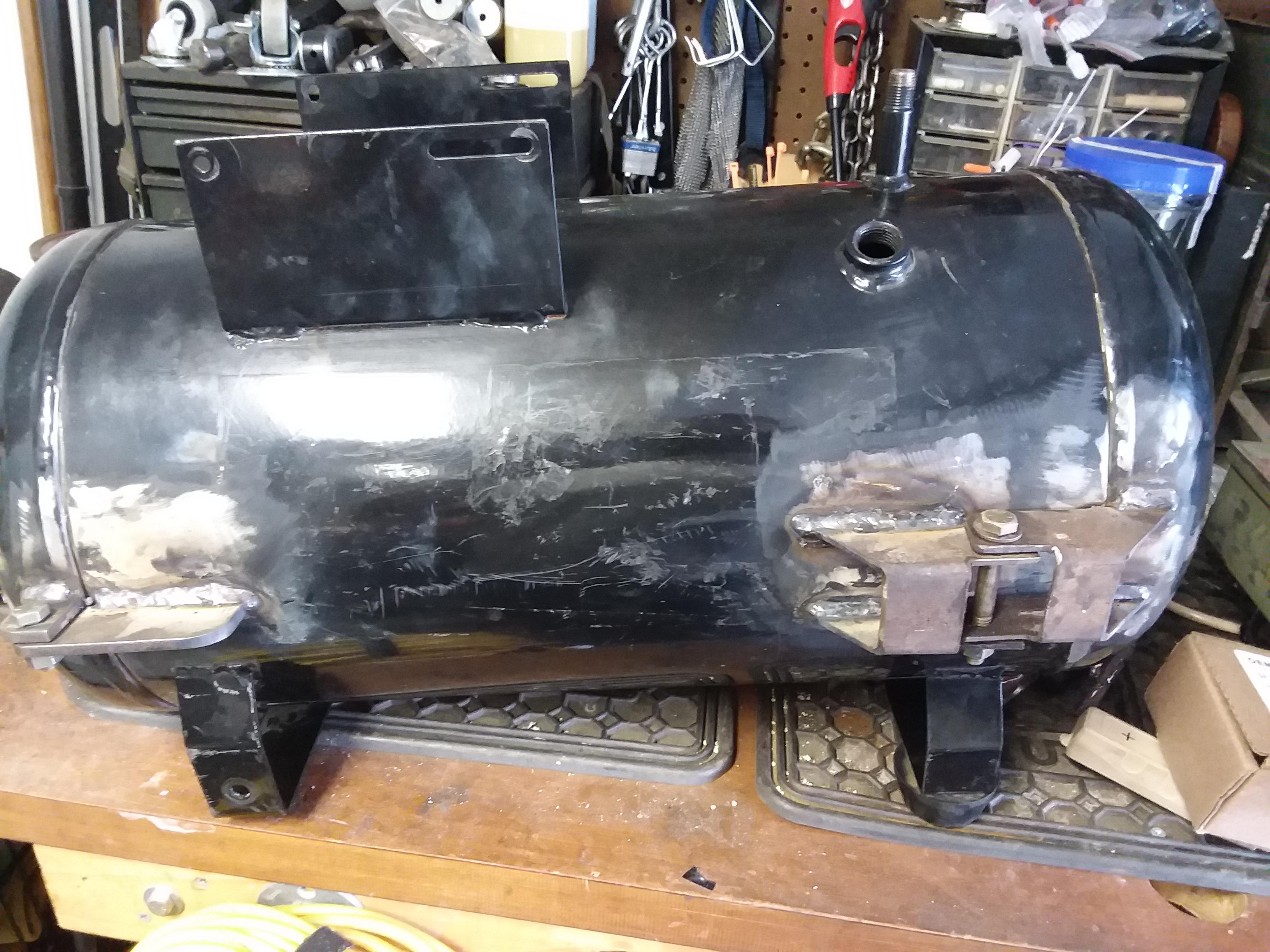

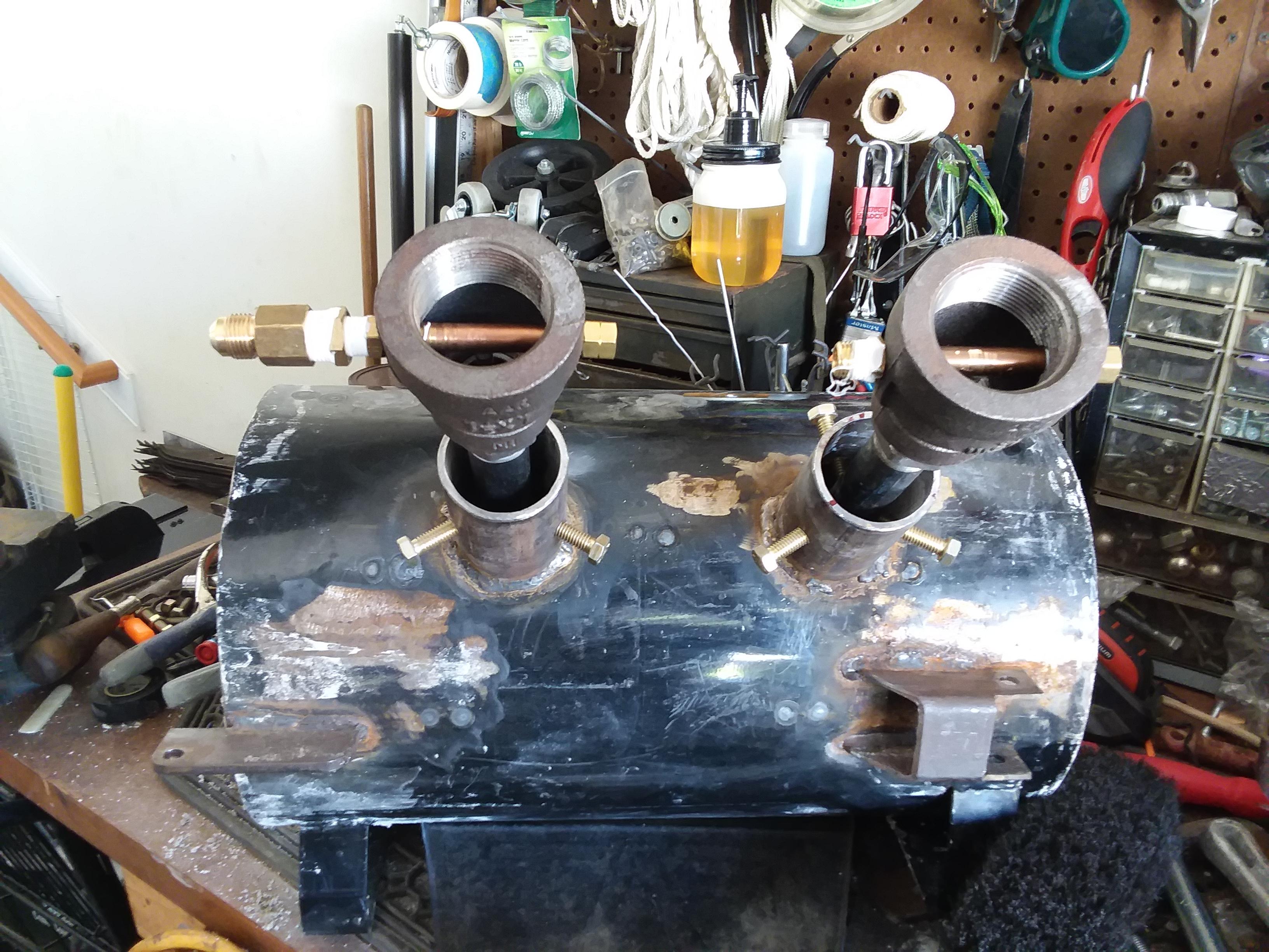

Well, having always had a desire to learn metalworking (See my post in the intro section to get my story.), and being frustrated with the progress I was making, then throwing out all of my accumulated parts for my original plan, I stared over. I settled on this propane burner set up. Thanks to whomever credit belongs. I made one slight modification, though. I found trouble with getting the flame to hold her own with that 3/4 nipple on the end. So i deleted it. I will most likely grind out the threads on the flame end reducer to enhance the flame by reducing any turbulence. I got a 10 gallon air tank off a compressor that was flooded in hurricane Florence, from my local junk man. I used scrap pipe for the burner guides which I tapped and added 3/8" bolts to hold the burner(s) in place. Not knowing how much heat one burner would produce, I planned for a second burner. After I cut off the ends, I again used scrap 1/8" plate for the openings. I used some 2" square tubing scrap to make the hinges and some 1/4" flat bar for the latch. Luckily, I work at a boiler plant and we had some contractors doing some refractory work inside our fireboxes. I was able to get some left over Harbison Walker (Greencast I believe)refractory and 2" Inswool blanket. I used the refractory on the body and the Inswool on the doors to reduce weight when opened. While I havent had the chance to run her through the paces, I am fairly pleased with the results thus far. I have some light weight 15" fire brick that I plan on cutting a belly in and use to make the forge floor. Please let me know what you think. Your most wise and holy counsel is appreciated! Following are pictures along the way. hopefully they will load in some form of chronological order.
