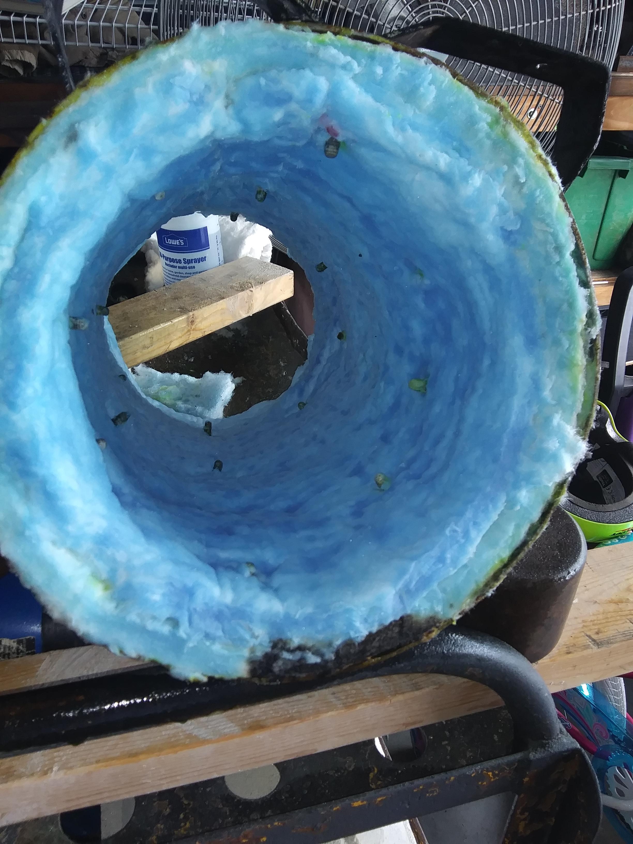

  7. In the name of an update, our HVAC went out this past Wednesday! Here in Eastern NC, it has been in the upper 80s! I hadnt planned on spending a few 'thou' on a new unit, but its always something. I hope to be installing a new system by the end of the coming week. I did, however, figure that if I was going to be hot, I may as well be productive, so I added the second layer of 1" ceramic. I found the blue food coloring this time! I am currently waiting on the silica solution to dry before i set it with the propane torch. See pic. Also, for those who have done it before, how "spongy/soft" should the wool be after rigidizing? The surface of mine sort of feels like hair thats been sprayed or moussed, but still has some give to it. Also, is there a good thickness to shoot for on my refractory? I liked the way it was before i had to start over, but if I go 2", it will make the fire box a bit tight, i think. Whata you guys think?

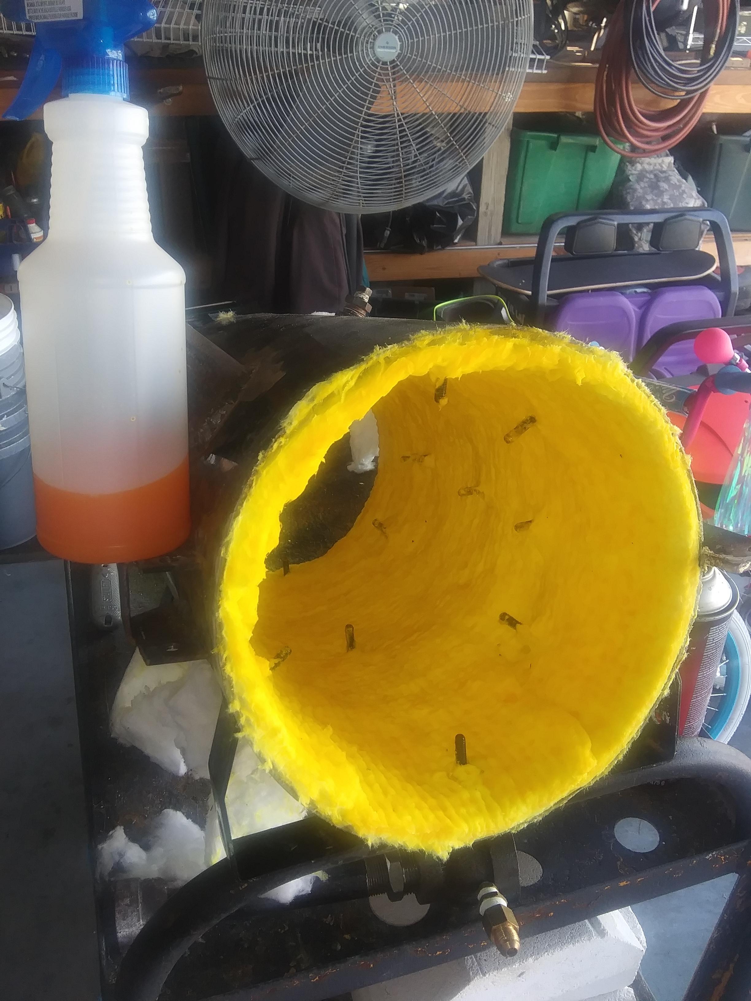

  8. Pnut, you know what they say, theres nothing new under the sun! As for the yellow, heres the deal. I looked in the wifes cake decorating stuff and the yellow one was missing the cap... So i dumped ALL of it in there! Maybe a couple drops would have done just fine. A little bit does a lot of good, a lot must do a WHOLE lot of good!
  9. Right, Mikey. Good to know! Frosty, actually, i think it was PNUT or someone who has replied to this thread who suggested the food cooring so that you can tell which areas had been hit by the rigidizer and which had not. Pretty cool tip. The colloidal silica from West Marine is white powder and renders just a cloudy mixture when mixed into water. This would be extremely hard to tell being the ceramic blanket is white as well! I like thw way you think though. A "butter shot" would be cool. Like going to the movies every time I fire up the forge!
  10. Oh cool, Mikey. I thought I had read somewhere on here that 2" was the goal in wool thickness. Mine is currently approx. 1" thick.
  11. Update from Eastern NC: We survived hurricane Dorian. Some areas endured major damage, but on average we didnt see near the effects as for Florence last year. Please continue to think and pray for those who fared worse than we did; the Bahamas, Eastern FL, GA, and SC. As for the forge liner re-do, I got the West System 406 Colloidal Silica. Following the ratio found in the refractory reference earlier, I mixed with yellow food coloring and sprayed the ceramic wool. Full disclosure, I used a 3M cartridge mask type respirator while mixing. I had read to do so by even with it on, i tried to measure amd mix with no airbourne particulates. Let me say, Im glad i had the mask on! When the more experinced fellas tell you to do something, it is for good reason. That mess gets everywhere! I am currently waiting for it to dry so I can wash over it with the propane torch. I suppose I will add another layer of wool after I torch the current one. Wish me luck! As always, thanks for the advice.

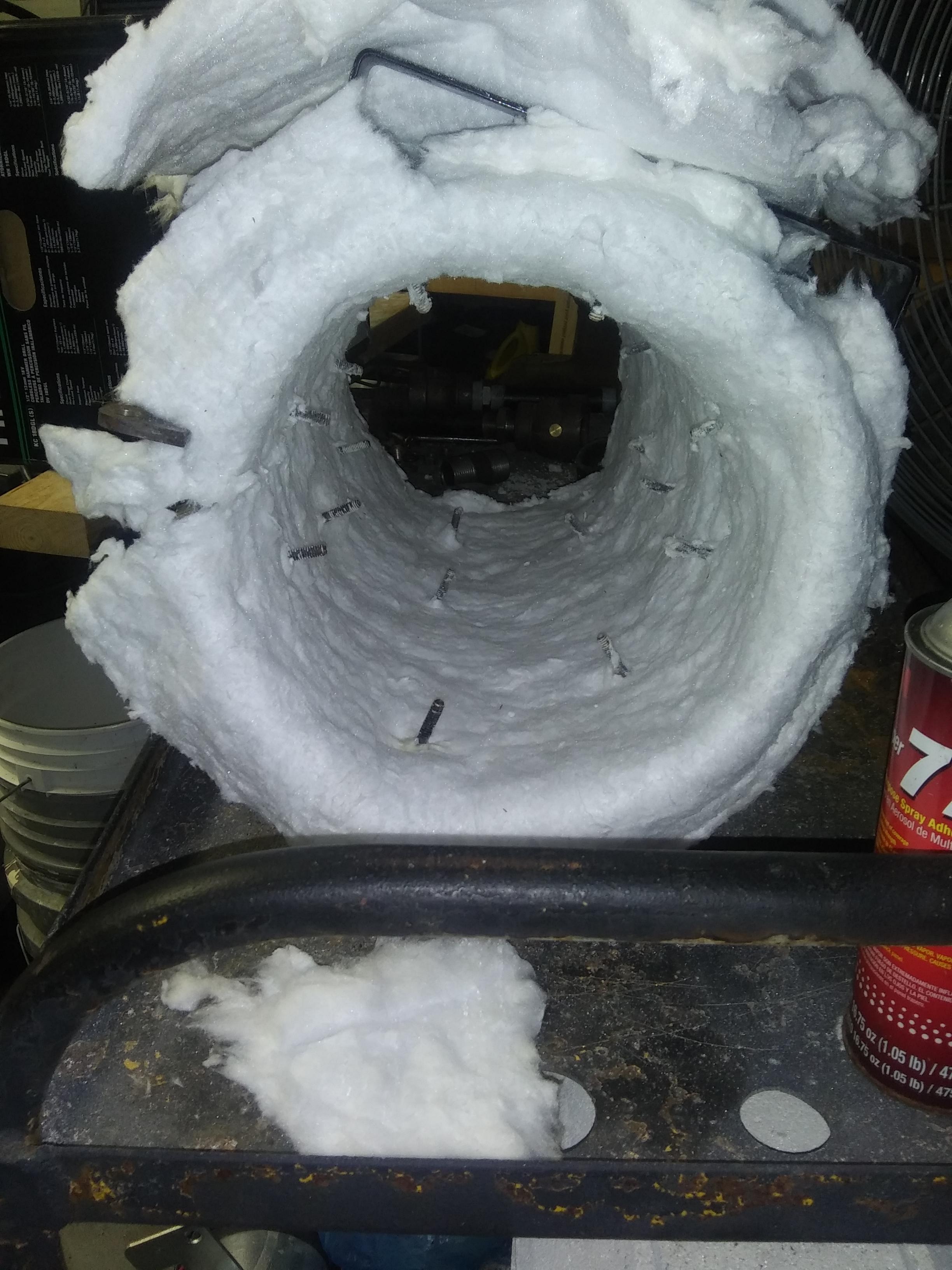

  17. Thanks Frosty. I found like 5 quarts of fumed silica on a particular online marketplce named after a large South American river for around $20. Seemed the best deal I have been able to source. I m going to run with that and see what turns up. Also, if you compare this photo with the one before i busted out the castible, you see i still have the bolts tacked to the shell for support. With the bolts, my previous form left a forging cavity or fire box aproximately 7"x19" cylindrical. I took my 2" wool and split it into around 1" thickness. I plan on rigidizing that 1" and then add g another layer of 1" wool as per previous posts, then apply castible on top of that. My question now is, is it ok if my cylinder shrinks to around 6" diameter by the time I get the castible in? Or should I not go so narrow? The 7" felt really good as far as my limited experience goes. I just dont want to get too small...
  18. Very good explanation, Mikey98118! I had read something about that, but your confirmation and laymen's terms made sense! Thanks!
