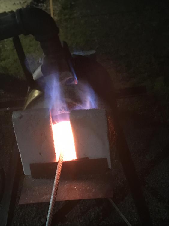

  19. Alright so after going all over I wasn’t able to find a blast gate and being impatient I decided to build one myself. By all means the blast gate has greatly improved the efficiency of the force but I’m still stuck getting red hot temperatures albeit closer to yellow. I can get a good rich blue flame but again it doesn’t get the metal particularly hot. I’ve searched around both on the forum and google for a detailed explanation of how to tune one of the suckers as well as trouble shooting but to no avail. Maybe you folks can The only other thing I can think of is that I melted some of the Lao wool out when I welded the two halve together and that’s causing an insulation issue. Any ideas?
  20. It being my first forge I followed the instructions a little too religiously in some ways. I cut it unnecessarily in half because it was originally designed for Venturi burners. That’s welded back up now and sealed. The biggest thing besides the airflow supply would be my ribbon burner holes aren’t super specific I just kinda threw crayons in there and hoped for the best. Tomorrow night I’ll check out what one blast valve does to the oxygen mixture in the forge. Once my plumbing supply store opens back up Monday I’ll use that T design. I believe your assumptions about the environment being oxygen rich to be accurate. That blower shoots out a heck of a lot of air, it easily blows out any dust and can knock over my firebricks at the end of the forge. Would you mind elaborating the dragons breath aspect of the fire? Google isn’t much help and a search of the forum produces similar results.
  21. 6” by the length of the 20# bottle
  22. I casted firebrick from castolite and use that at either end, hence the stoppers to keep them from blowing over. I also don’t have a way to regulate air it’s just a shopvac.
  23. I recently completed a ribbon burner propane forge loosely following waynecoe’s design but I’m having some issues with getting it hot enough. A piece of 1/4 in round stock will barely get red hot even if left in for 5 minutes or so. The forge is lined with kaowool and castolite so it should be insulated well enough. In addition I’ve casted Some firebrick from said castolite to act as heat barriers on the end. Im scared to death that I’m going to have to sink more money into this but I assume I will need a oxygen source that I can adjust. The gas supply is a 0-30 adjustable regulator then a ball valve which finally goes into a needle valve. I was getting rebar to start sparkling but XXXXXXXXXXXhad all the gates open all the way. The tank would also freeze up in about 20 minutes. Since then I’ve substantially toned down the propane I’m feeding it. If ya’ll have any ideas it would be tremendously appreciated.
