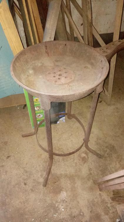

  2. Let me add that I have seen numerous comparable blowers sell in my area recently for around the $200 mark. My question is more so about the combo with the rivet forge as I haven't seen many good comps sell recently. And we all know what prices have been doing with anything blacksmithing related.
  3. An antique picker I know sent me some pictures today of a champion forge and hand crank blower that he is looking to sell. He had it in his shop when I purchased my anvil from him not long ago. Everything appeared to be in good shape. There were no cracks in the fire pot and the blower did work though there was a little play in the bearing of the crank. Anybody know what these are going for these days?

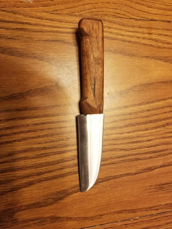

  11. Thanks Latticino. And yes, I tempered the knife in the oven at 400 for a total of 2 hours. I also did a series of 3 normalization before my quench.
  12. Medic Zack posted a topic in Knife Making
    So I am very, very new to forging. And my plan was to spend a significant amount of time learning the basics of blacksmithing making decorative pieces and tools. But my fiance had different ideas... Her birthday is today and despite multiple attempts to convince he to let me make her something simple and decorative, she had her heart set on a knife. And of course you have to give the lady what she wants. So this is my first attempt at making a knife. It is forged out of 1080 1/2 inch bar stock and modeled after one of her favorite kitchen knives that she uses to chop vegetables. The blade is 4.5 inches long by 1.5 inches. It has a hidden tang that is 4 inches long by 1 inch thick. The handle is made out of an old sledge hammer handle. Overall I am very happy with the knife for my first attempt. The heat treatment took some trial and error, but in the end the blade will pass a file test and did not warp. I feel like my fit and finish leaves something to be desire. But this ended up being a wonderful learning experience. I would like to say a special thank you too all of you on here that have shared your knowledge of blacksmithing and blademaking. Especially Steve and Rich for the knife making classes. They were invaluable.
