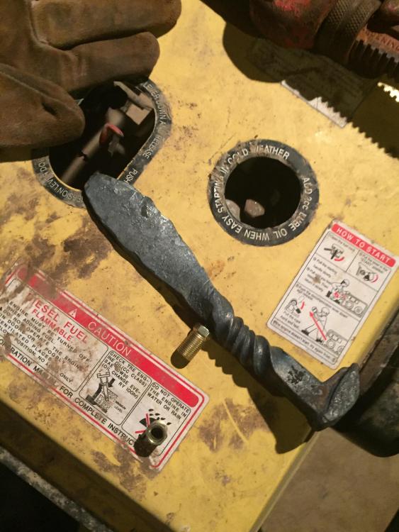

  1. Forgehermet posted a topic in Gas Forges
    I would like to thank everyone who helped me with putting my forge together, with all of your help and advice I have finally become a true blacksmith!( the first three pics are after using it for four or five hours and turning the flame off) I would like to especially thank frosty Thomas powers and buzzkill for the advice
