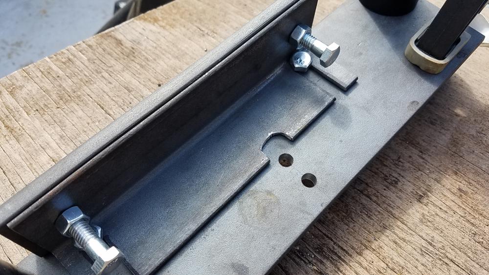

  3. Today I pulled the grinder apart and addressed some issues I found in the test assambly. The first was the fit of the platen. As you can see in this photo it is proud of the large plate. The bolt heads are pressed on the angle iron. I drilled two new holes to fix the problem. in this photo you can see the screw adjuster for the tracking wheel. Near as I can tell I let the tap cut the threads at a angle. After some drilling and file work it now passes through. As you can see in the other photos some of my tubing came from some rusty stock. I would welcome any advise on removing it before painting. I was thinking wire wheel might do the trick. Thanks Mel

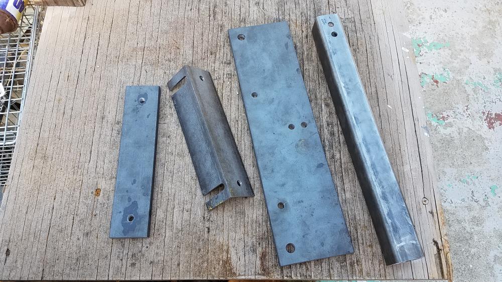

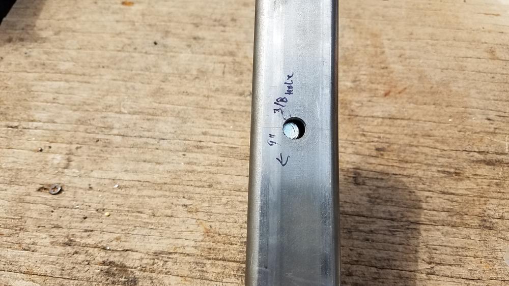

  21. Yesterday I made the tension arm and the tracking wheel parts. Today drilled the mounting brackets for the tracking assembly. I also cut the clamps. Still need the 3/8" holes in them. Here is a photo. Mel

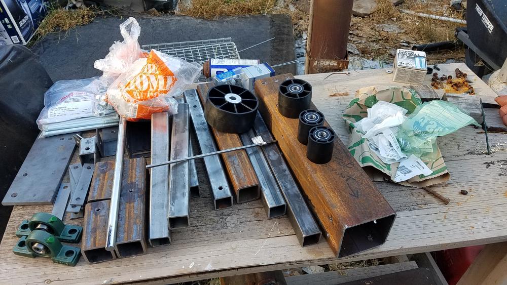

  22. Worked some more on my 2x72 no weld grinder. I am getting quite the pile of steel tubing with holes drilled in it. Mel
