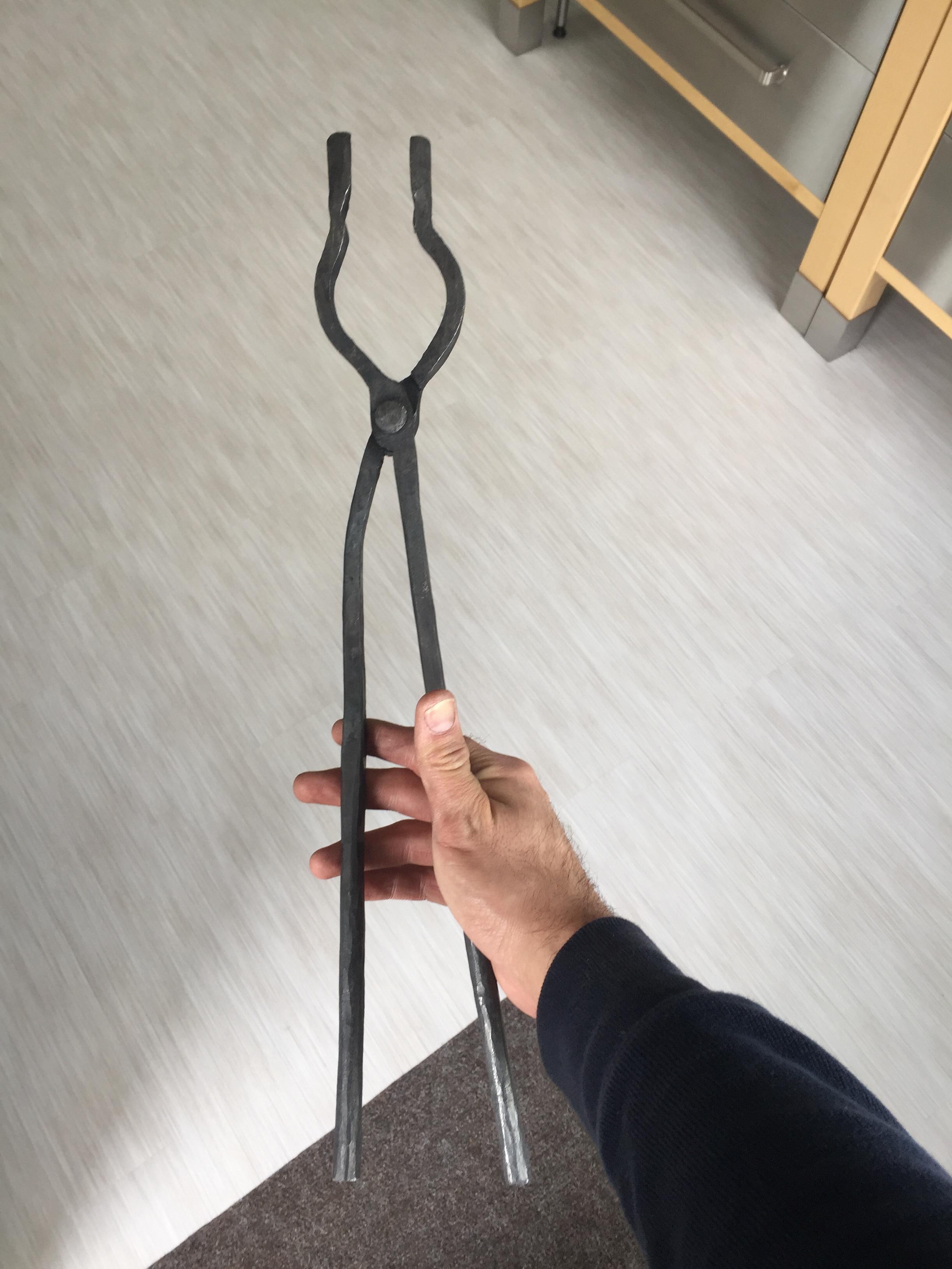

Well I had a few hours in the shop today and wanted to work on making a pair of bolt tongs, I looked at a few plans online and watched a few videos then gave it a shot! I didn't have any 3/4" square stock so these started from 1/2" square. They are a little thin in a few parts and a bit lopsided and I don't expect that they will hold up for a long time, but I made them and I learned a great deal in the process. What do you all think? I should also mention that this is the second pair of tongs I have ever made, the first were so ugly and wobbly that can't really use them, these new ones don't wobble at all! Yay me
