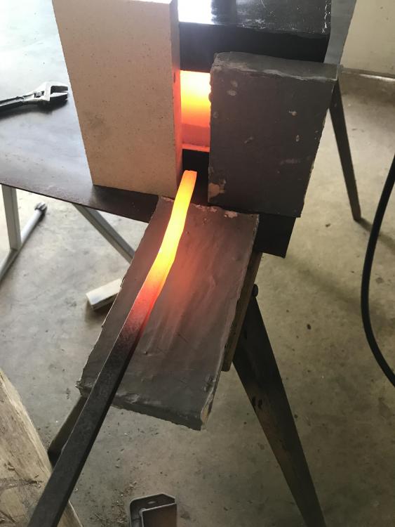

  4. Changed to a 1"x3/4" T and left more space between the mig tip and beginning of the nipple, tried it with a .030 tip and couldn't get the flame to stay steady but went back to the .035 tip and work much better. Put a piece of 1/2" wrought iron and got it red hot fairly quickly it was easy to bend and hammer on but don't have an anvil yet so I can't do much but I think I'm making progress

  8. There is no gauge on the regulator just the red adjustment knob so I can't say exactly but the dial should be right around 5psi maybe a little higher, I played with the dial a bit and it seems like any lower and I have a weak red flame, any hire I can see and hear the pressure go up but the flame stays about the same distance from the end of pipe. Wondering if a longer nipple might help? It's currently 6-1/2" from then base of the tee and is flush with the kaowool on the ceiling
  9. Still waiting on the plistix but got my box welded up and insulated with 2" of kaowool and I'll have to pick up some fire brick for a floor and baffle doors, burner is all together and working ok it's burning hot for sure but It may need some tuning it's not a great picture but lmk what you guys think
