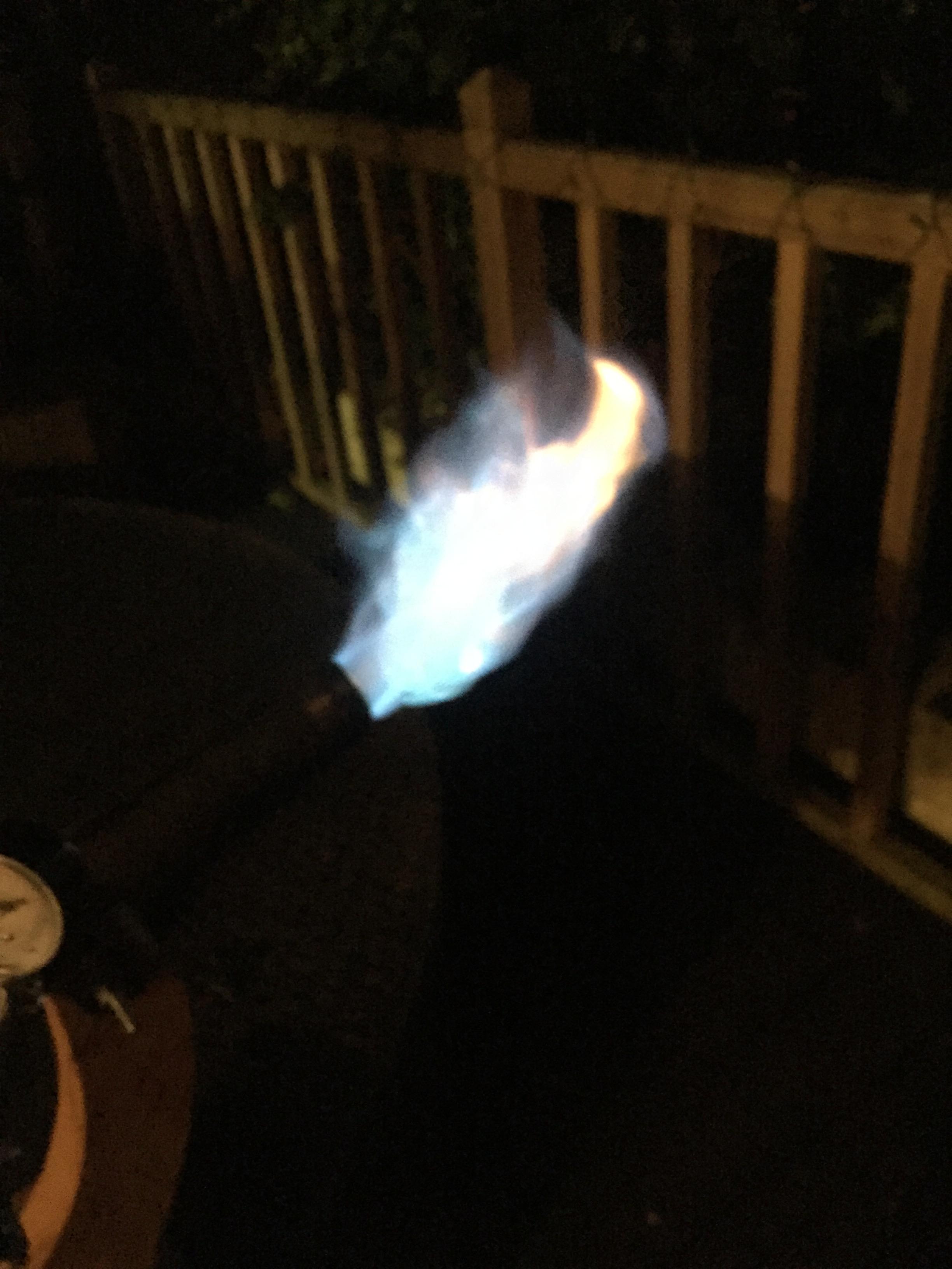

  6. I can get a regulstor that's 0.5-4 rather than 0.5-2 I know the design calls for 15 but I don't know where I can get that regulstor, would 4 not work?
  7. Would you advise moving the mig tip further back as I have it basically inside the burner tube now? I can get it lit and "stable" with around 0.1 psi would you recommend cranking to the full 2psi that my regulator can give? My refractory mortar arrives tomorow (5th in memory old England) so I have that to do first possible issues I can think of: 1.burner tube is wrong length 2.burner tube isn't smooth enough insude 3.intake reducer isn't smooth enough inside 4. My tip is too far in the reducer 5. My 1x1-1/4 reducer is not a good enough flare 6. My flame tube being 1" is too big 7. My intake reducer is too small of a change if you believe it's any of these do say something!
  8. It's not that there isn't room, I'm just wondering is it too far into the reducer to work properly, at that point it's almost inside the pipe. Ive just changed from a 1mm hole to a 0.6mm mig tip but I'm still getting burning inside the tube, any suggestions as to why? I currently have a 1-1/2x3/4 reducer coming and plan to switch to it, out of 10 how much do people think that will help? As for tuning inside the forge im still waiting for customs to deliver my HT mortar
  9. So for my 1" pipe you'd recommend aiming for 3"x1" reducer? Can I put you in camp "get bigger reducer" rather than "get smaller tube" i think my first port of call is to change from a drilled hole to a MIG rip, obviously this wouldn't work with the Bordeaux modification as the tip would be too far inside the reducer... right?
  10. My reducer is 1"X1-1/4", wouldn't this create a rich burn rather than burn inside the tube? i plan on using a 1"X1-1/2" when it arrives, and dremeling out the threads to make it nicer for air flow, would the 1x1/4 make an adequate flare? i know my burner tube is shorter than asked for but surely a longer tube will exacerbate my problems also, would you recommend changing to a 3/4" pipe, I'm not looking for a massive burner but 1" was easier to source. Would I be better to have a 3/4" pipe or a wider reducer??
  11. Yes I do in fact mean 0.5-2 bar, mike It burns quite happily at 0.5bar just inside the burner tube, I've heard there's a burner tube ratio that should be like 9:1 where as I'm below that at 6:1, I have a 1"x12" being delivered soon, and I'm going to dremel the inside of the reducer to make it smoother, any other tips?
  12. Hello everyone I am back to cause headaches for all you nice people! I have committed to following the Ron reil ez burner with Bordeaux modification and I have still run into issues. Mainly the issue is im getting burning down inside the burner tube, I am using a 1x1-1/4" reducer for both intake and flare with a 1"x6" pipe, I have followed the design as closely as possible other than direct sizings, also I have a 1mm hole in the 1/8th nipple rather than a #60, I'm also using a 0.5-2 psi regulator call me stupid and tell me how to correct it! Thanks!
  13. I believe 0.6mm is close to 0.023" but I understand tolerance could make it closer to what the 0.8mm is design to let through. i think I'm doing my self an injustice with saying I can't manage to drill a #60 hole and with UK drills it will probably be closer to 1mm (whatever # that is called) i'll try for pipe straps but for 1/4" is already giving me a headache! I do plan on switching to propane for any real usage im just impatient
