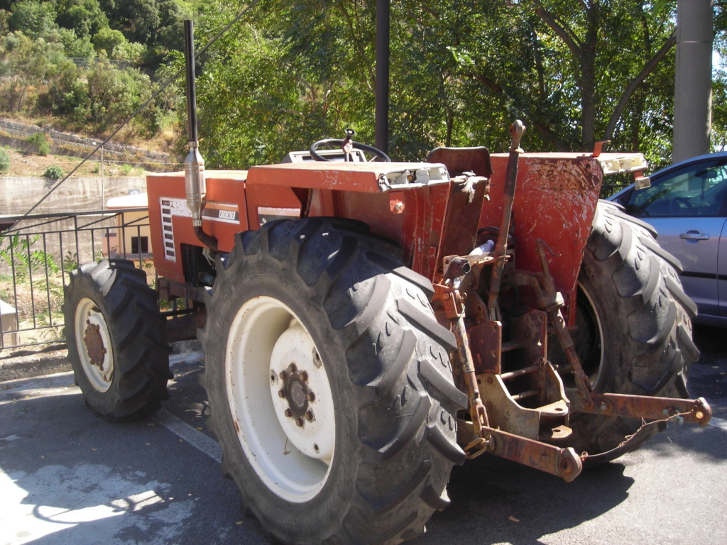

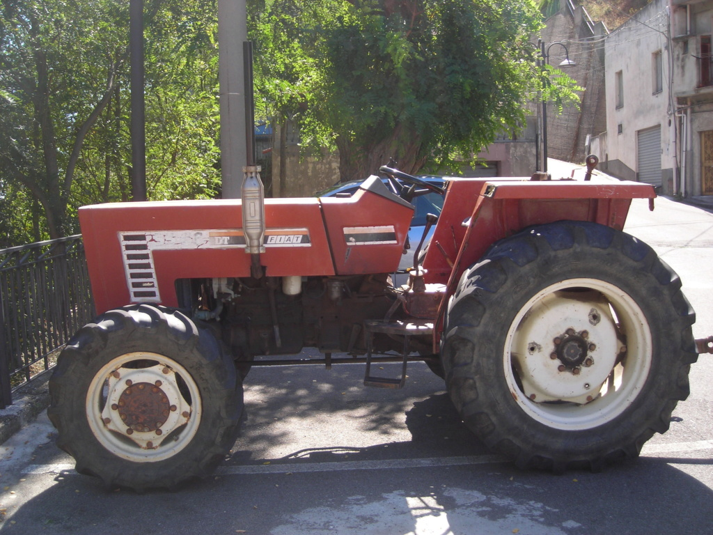

  13. Point Carry-All Fork Attachment hello sorry if I disturb, could you kindly suggest me how to build a self-loading rear bucket fork for this old fiat tractor, in my part it is called the pruning fork, as you call it. how do I make it to be light and sturdy?
  14. better round or flat iron? I have a welding machine, I do not regulate myself in giving the right shape to the ladle, the same is used to collect the stones and accumulate them, and at a later time shovel them and maybe load them on a wheelbarrow to transport them elsewhere and set them aside. what would you suggest?

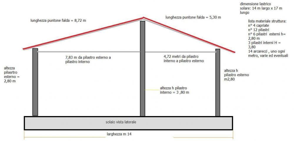

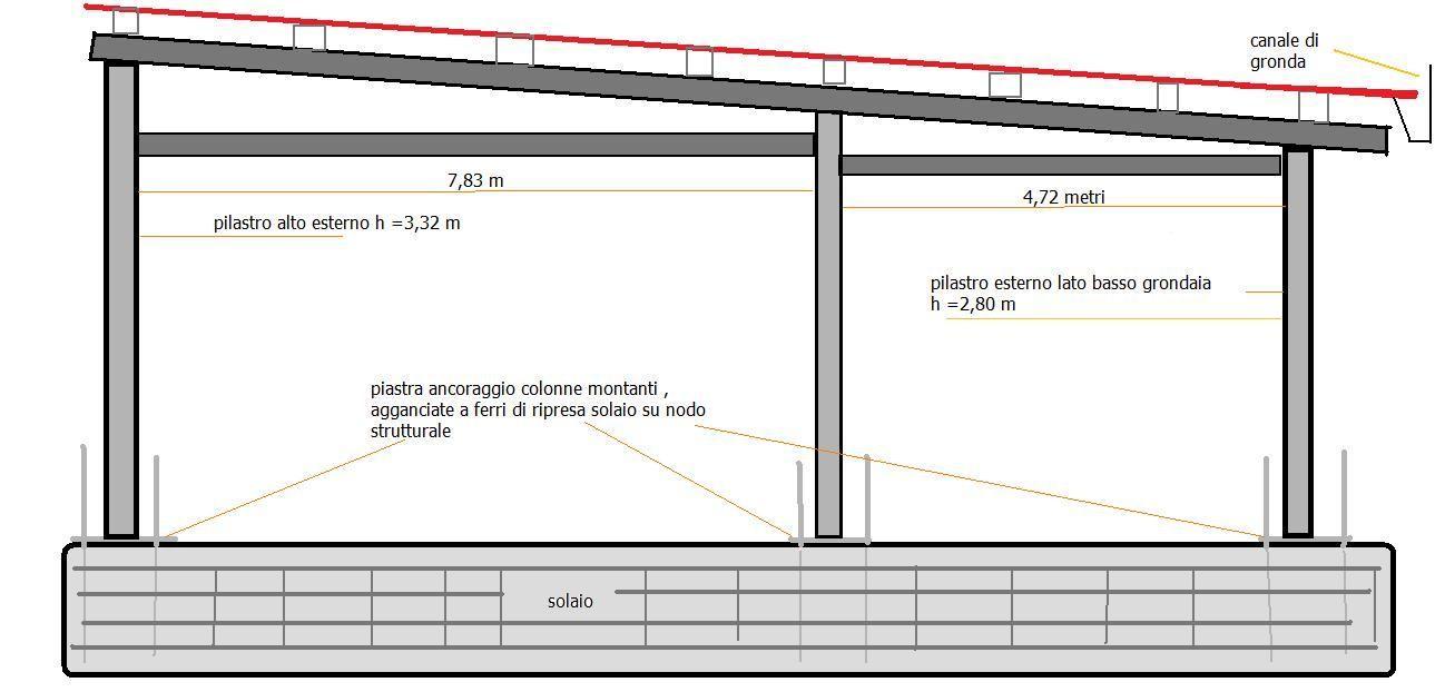

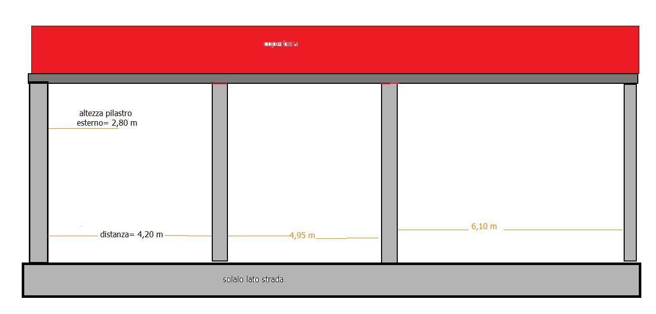

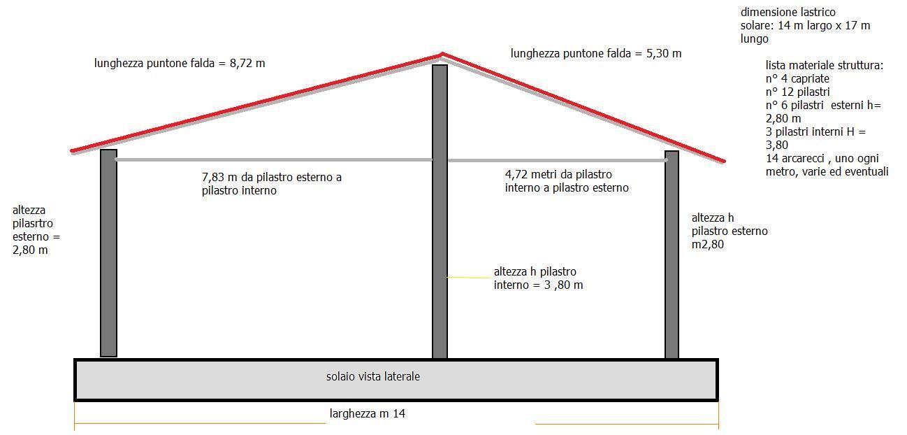

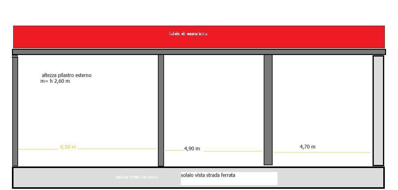

  19. but I was a metalworker, I manage to weld, instead of building the trusses in the workshop or construction site and putting them in place on site, I would like to bring the bars on site and segment them and put them in place as I proceed with the work. were you referring to the master plan at the technical office I think?
  20. the shed I would like to make it with a pitch as in the side sketch, climb the beams, cut them, weld them and put them in place and move forward, the truck would cost about 800 € uro per day. the reticular structure, if I make a pitch I could make inclined portals and above it fix the beams on which to screw the roof panels, momentarily I would like to make only the roof without lateral infill. ps DennisCA you could be kind enough to attach some photos and explain to me how you did the job, thank you excuse me if I'm picky and boring, thanks again.

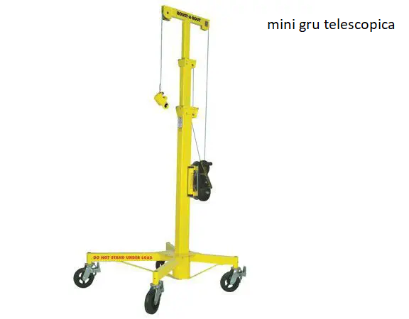

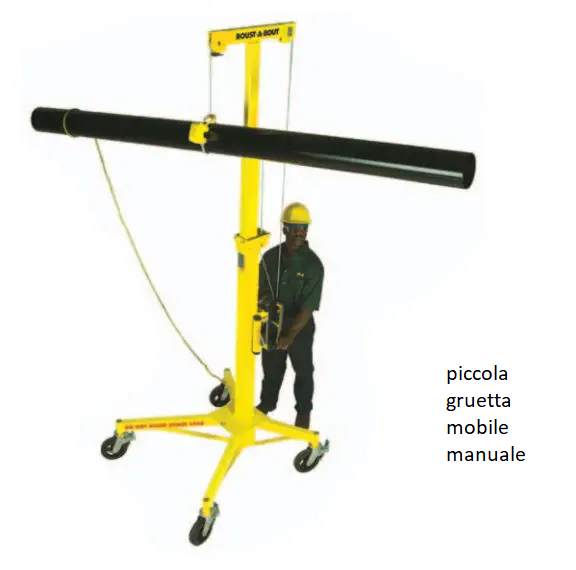

  21. hello, sorry for the unusual and odd question, I should close a terrace a flat concrete floor, to eliminate water infiltration when it rains, to overcome this inconvenience we had thought of installing a metal roof, or pillars in the H beam and metal trusses. the truss would have a span of 14 meters, the surface to be covered is about 240 square meters, the attic is on the second floor at about 12 meters above the street level. for logistical reasons, we would like to avoid using a truck crane or forklift, I was wondering, is there a self-erecting solution such as stage for concerts or circus structures, with structure pulleys, winches and hoists, a do-it-yourself solution using waste material, such as scaffolding reinforced similar, thanks to those who want to provide more information. thanks for your kind attention.
