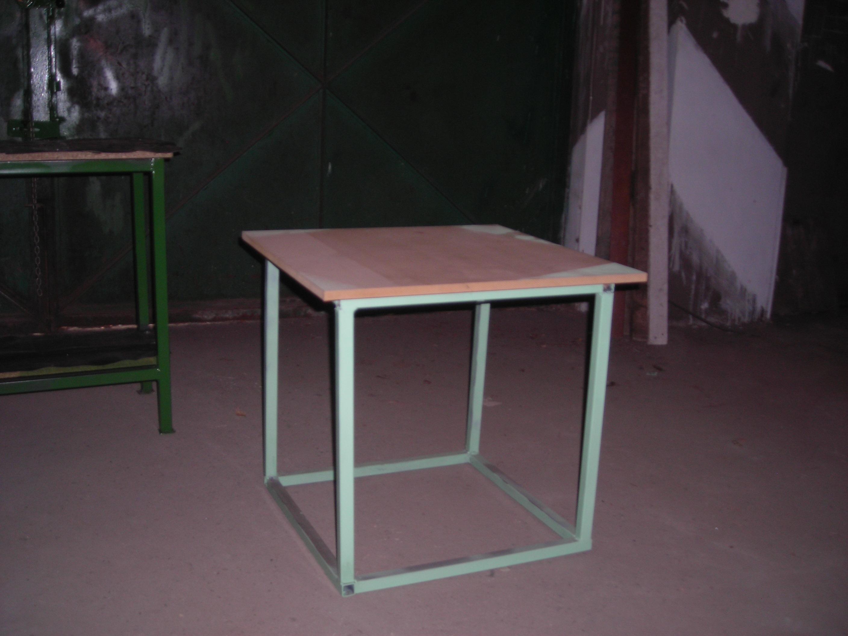

hi sorry if I disturb, in my shelter laboratory I have my workbench welding station, I would like to create a study office corner, a corner where to put a sturdy table a desk to have fun reading the newspaper, consulting books designing sketching, supporting the computer, or a workstation versatile multi-purpose to my personal needs. therefore I thought of creating a personalized desk table, the measures would be: 70 cm wide, 80 cm high h, 120 cm long, you will tell me buy it, I would like to create a banquet, light versatile robust useful for any eventuality, perhaps to disassemble delicate objects, what can you suggest to me, I state that an emporium was selling 80 € therefore between material and time I should save, perhaps by recycling objects or other materials. what do you think, thanks greetings. -
