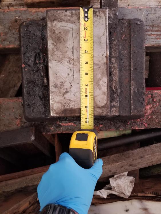

  1. Bottom die. The top die is also 5.5" wide, but 9" long.

  3. I'll have to measure. Not quite that long. From memory i think the bottom die is 10" long, and maybe 5" wide. The top die is just about the same. I'll measure later this afternoon. Your 300# would work an entire bloom gloriously.

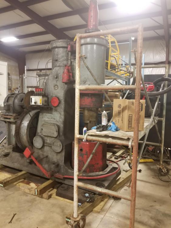

  6. Cleaning up, hoisting ram up to move out of way to set sowblock and die. View underneath compressor, oiling system.

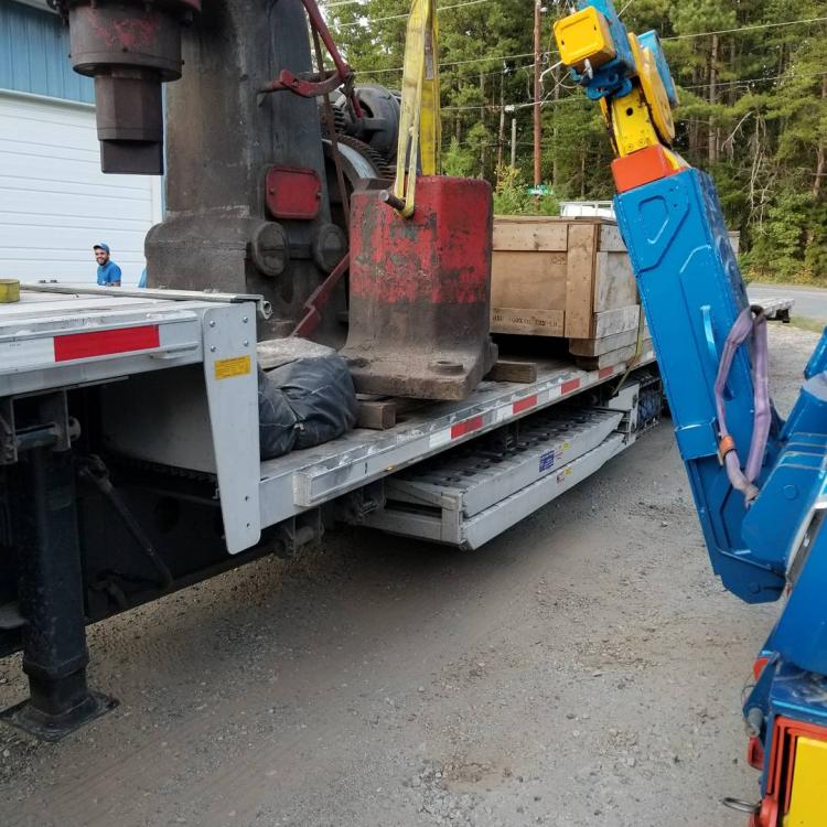

  7. Take note anyone moving a machine this big. Our shop ceilings are 20-26ft high. When that truck with crane was moving the hammer and lifting over a 3' anvil, we still had limited clearance. Infact, the crne had room to lift it over the anvil and not much more. If you happen to get a 4b, you will also find out that United Rental especially in rural areas will have a hard time renting you a 12,000# capacity forklift. They told me they would have to truck one in a few hours away and the cost was going tk be nuts. Not only that but they could not coordinate with their truck driver with my delivery driver, so i would have to rent it for extra time i wasnt using it. And this is a united rental we have been doing business with for over a decade. The forklift rental was going to cost well over $1,000. My local wrecker has a $1 million 75ton crane truck thats used to lift tractor trailers out of revines, and did this for me, over the course of 2 hours for $400. Of course we do a bit of business with them, but it was well worth it. Still, it was sketchy knowing if we were even going to be able to lift it over the anvil or not. When i take this home, im pouring foundation first, setting hammer, then building new shop around it. Then truck crane driver was also not new to moving big machinery with it. He showed me a picture he took earlier that day moving a 55,000# Trane A/C unit for a hospital, so my hammer was a toy, lol. 4b frame = 12,000# 4b anvil = 7,000#

  9. This machine travelled from Seattle Washington to Salisbury, NC lol.
  10. This was Larry's 4b that had trouble half stroking without a blow off valve. I plan to have Mark Krause fix it one of these years. I initially had more immediate plans for this, but life changes. Right now it will be stored and tweaked in my family shop until i pour a foundation for it at mine. In the mean time, its hard to not appreciate such an imposing figure. Also it is crazy to think that in 2012, i joined this site and this world, and 5 years later i own a Nazel.
