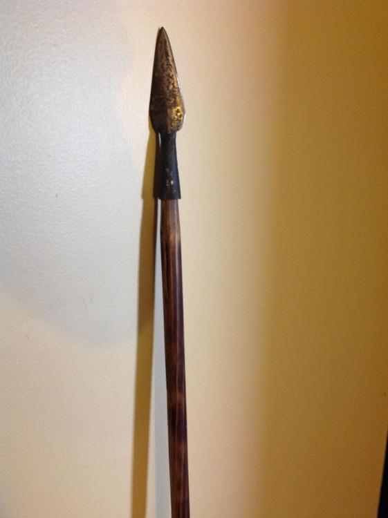

  2. Yeah, thanks guys for all the advice... sorry for the curse earlier, I just type how I talk sometimes (which is sometimes done rather quickly, as I'm often on the throne, and my butt goes numb after a few minutes). I just want to clarify again though, this was just something I cobbled together out of scraps while I was making a knife. I never set out to make a spear, I just looked at the left over chisel nub after setting the rest of the blade to cool and thought "I bet I could make a little spear out of that" and started hammering. Prior to that I'd never researched or intended to make a spear. Since I thought this little toy turned out cool, I did go watch some videos on spear forging and determined that I didn't yet have the tools for it; but that it was certainly possible in the near future (indeed, the tools for making a spear head seem easier to make or acquire than the stuff I currently am lacking for knife finishing and handle making)... After reaching this determination, I made the OP you can see here. So, when I said "going to try spear making again, the right way, once I get the proper equipment" it was a statement of fact, not one of defeat... and when I posted this here, it was not to say "look at this amazing spear I made, there is no way I can make a better one until I win the lotto"; but more along the lines of "hey I just cobbled this together half on accident, it came out prettier than I had hoped for, and now I'm interested in spear making." And no worries lads, no one is charging into battle with this rake handled little guy... In fact, the lady and I have determined it will make a cool curtain rod/conversation piece in the den.
  3. Yeah... I mean, 30 second in he's using tools I don't have... I get it, I can make them, but one thing at a time. , just delete this thread I guess. Sorry guys. Foul language is not permitted on IFI

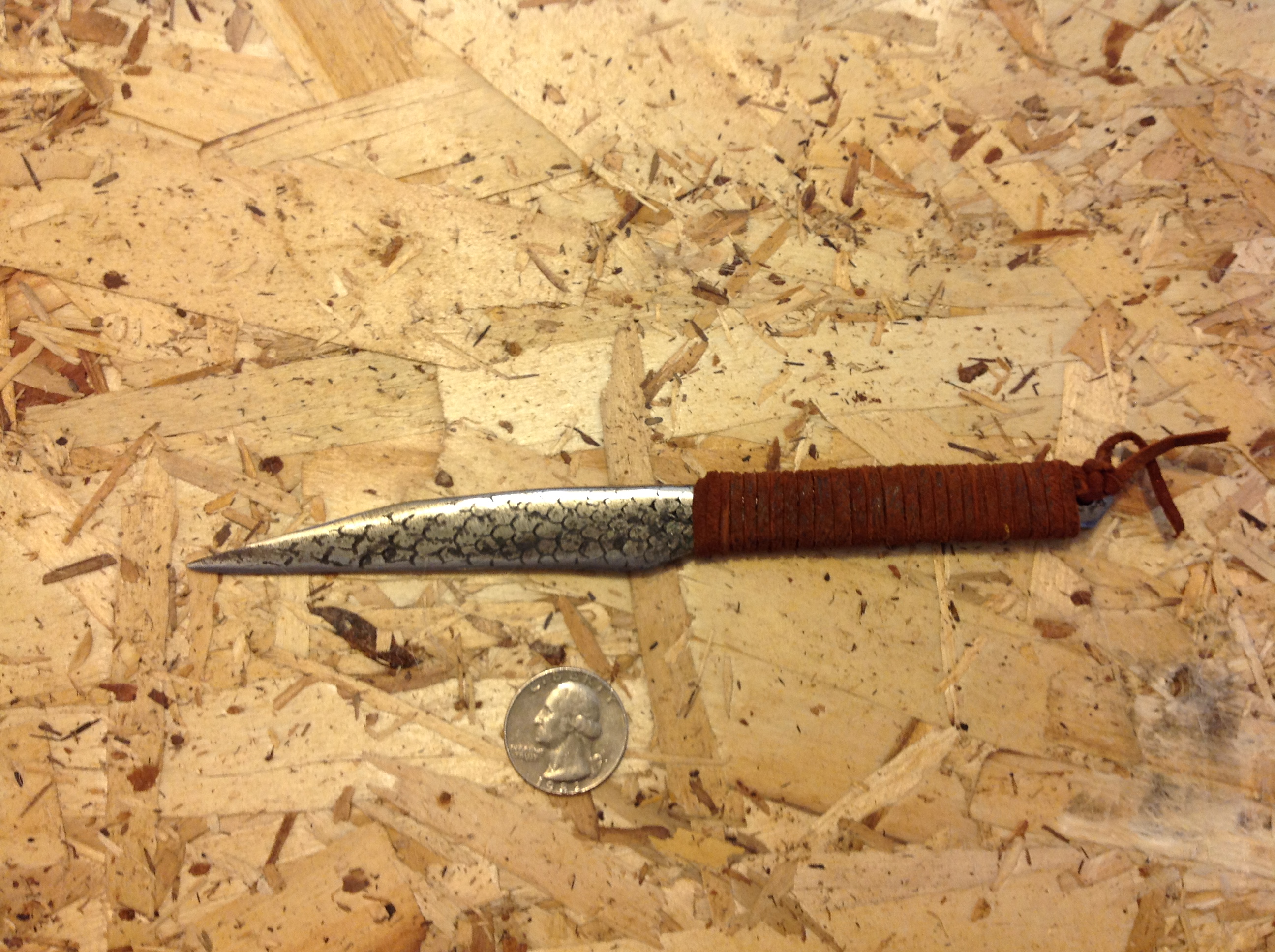

  4. Well, it could just be my ignorance, but I have no idea how I would make a solid socket with just my hammer, tongs and anvil (which is the totality of what I have aside from the fire part). I've seen tutorials where you just sort of wrap and weld (technically I don't have the stuff to weld either, but I can visit my buddy's shop for that), but even that leaves an opening where the socket and blade meet.... Not to mention, I have only one set of tongs currently, that makes any project where I don't have a long extension "handle" difficult until I have it hammered to fit the set that I have. With the wrap and weld technique that seems like it could be problematic. And again, this was just screwing around with some scraps, wasn't trying to brag.

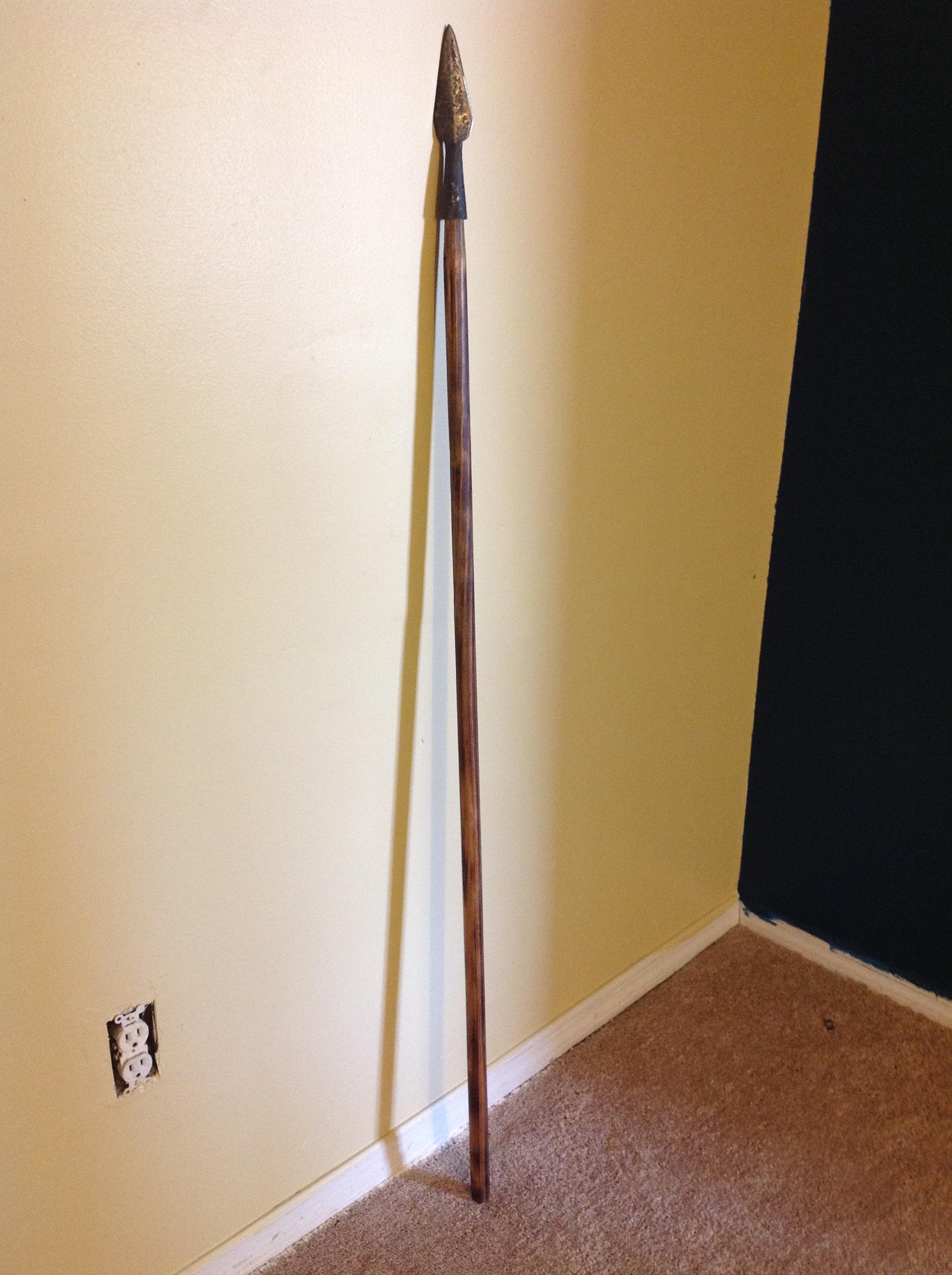

  5. This started out as a half round file... I don't know if it was hard to get it into shape because it started out as a semicircular shaped object, or if it is simply that small, thin knives are more challenging than the big choppers I've been making... But this thing's size is no tell of how hard of a time it gave me, nor the sense of accomplishment it gives me as a baby knife maker to be able to say that I hand forged my latest edc knife (which fits better in pocket than a thick bodied pen). And look at the snakeskin pattern the half round file gave it! I figured it would be an uggo when I first started hammering it into a square rod... but it ain't bad compared to some of my others.
  6. So I was making a Christmas gift out of an old chisel with a rotted handle. After drawing out and finishing the blade, I was left with the round socket and a short but rather thick "nub" from the base of the chisel. I knew the socket was a bit small for a spear, but in between cooling period from other projects I started drawing out the nub into a blade. I didn't think it had enough metal to make a normal looking spear head, but as always, there was plenty once I started getting it flat. As it happened, I also had a broken rake from this year's fall cleanup in the shed, and its handle fit nearly perfectly into the socket. So, I sanded it, hit it with the torch to give it an aged look, then rubbed in a little stain, and pinned the head on. The end product isn't exactly what I'd call battle ready (really only because of the comparatively flimsy rake handle, the head is solid, if only a little small)... But for something that took an hour of my time (not counting tempering, obviously) and is literally made out of my garbage, I'm actually pretty tickled about how it came out. DEFINITELY going to try spear making again, the right way, once I get the proper equipment.
  7. I think I'll do that on the future^ So, it sounds like I need a metal pipe that roughly matches my handle... Wrap, weld, HT&t, then put it on the handle. I'll report back once I'm done screwing it up :-)
