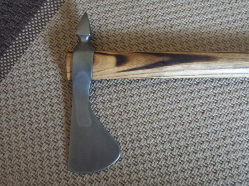

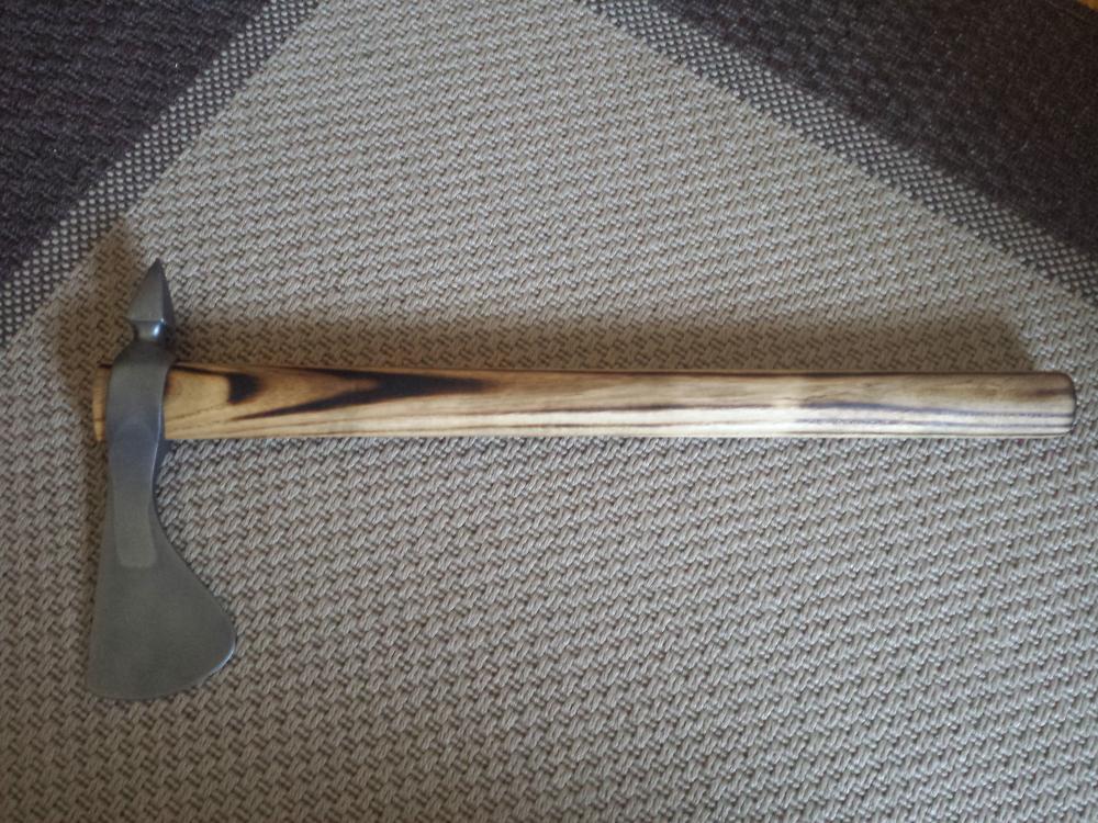

Hey Shamus, I would imagine that you could use almost anything of a suitable diameter such as a bull pin, truck axle, jack hammer bit, etc. Once you've found a suitable piece of material, then go to Crazy Crow Trading and look at their hawk handles. They give the dimensions of their hawk handle eyes, which will give you a good starting point. The first 3~4" of the drift are not that critical since you are just trying to open the hole you've punched, but pay close attention to the upper 6" to ensure the dimensions and taper are as good as you can make them. I believe that the taper is about 2 ~ 3 degrees, but you may want to research that further. Also, you don't have to forge the drift to "the perfect" tear drop shape and taper, just forge it as close as you can and file it to shape using stations along the length of the drift to guide you and check your work or heck don't even forge it at all, just blue the steel and scribe guide lines and grind the profile with an angle grinder. One final thought is that if you are planning on making your own drift and handle, then don't worry if your drift doesn't match a commercial drift in every aspect since it only needs to match your desired handle size. Good luck with this project, I am sure that with a little caution and a little confidence you will be pleasantly surprised how well your drift will work for you. I will try to post some dimensions of my drift for you to follow. Have a look at this link: http://brentbaileyforge.com/forgenotes/index3.html -

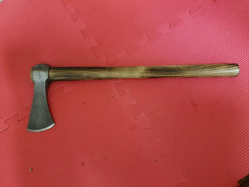

My First Tomahawk
Hunterbow Smithy replied to Hunterbow Smithy's topic in Axes, Hatchets, Hawks, Choppers, etc
Hi Shamus, As Frosty has stated above, making a drift has it's own set of unique challenges. However, you need not have to manufacture your own tomahawk drift if you only wish to make a small number of hawks. I bought my drift on-line from a blacksmith supply store for about $20.00 USD. The drift that I bought was cast steel and not of the best quality in my opinion, but it did the job and gives me a point of reference if I decide to make my own drift. -
My First Tomahawk

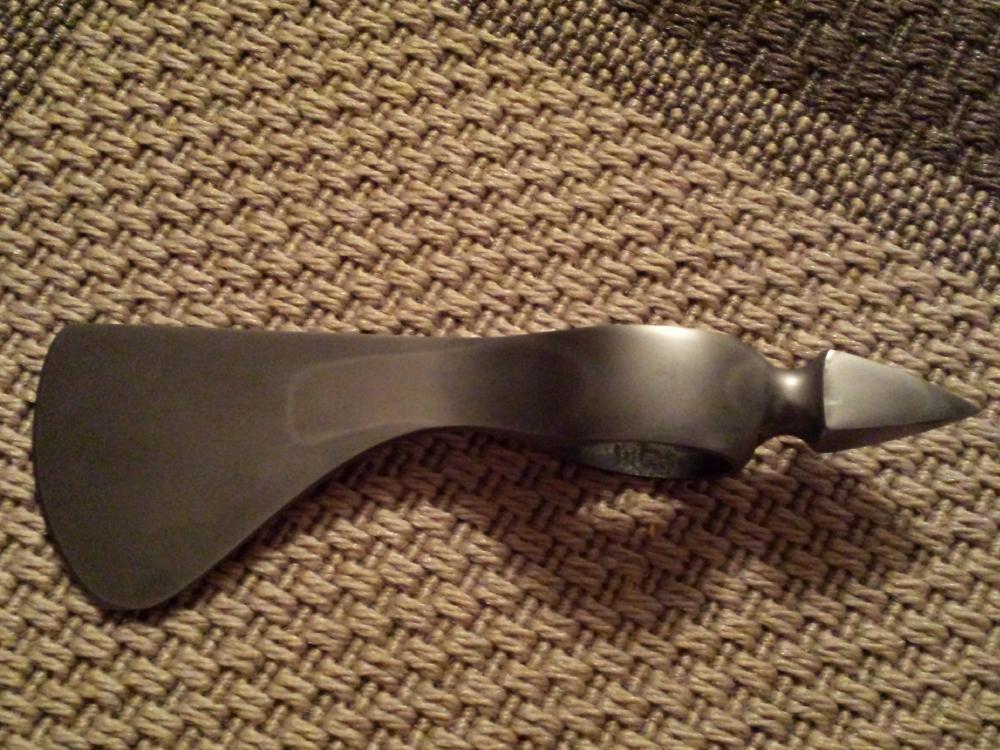

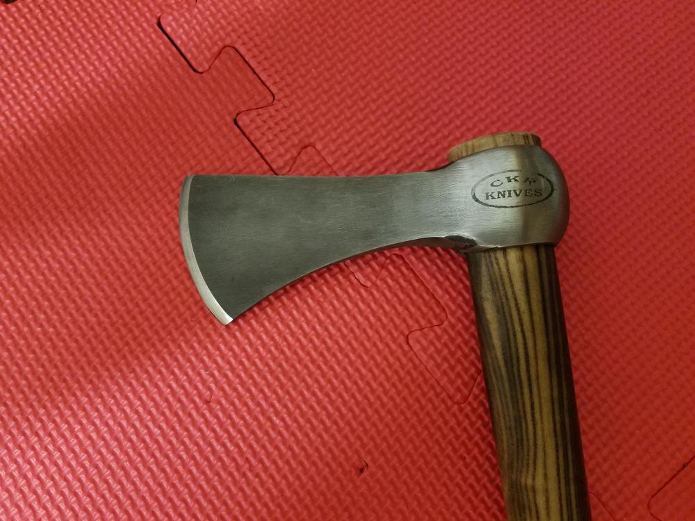

Hi Connor, What Frosty said. In my case, the ferric chloride produced the shiny patch that you see in the middle of the hawk due to the difference in hardness. Additionally, the etching coloured the steel to the gun metal grey as well. You could use vinegar or lemon juice or even a combination of the two if you don't want to mess with the ferric chloride. They will give a slightly different effect though. As for making a tomahawk yourself, I believe that if you take your time and work diligently at it you should be able to produce a hawk to your liking....or anything else that you set your mind to. Honestly, if you start with an old ball peen hammer and get a tomahawk drift it shouldn't be too taxing. My hawk was 63 Rc at maximum hardness and 58 Rc after I tempered it. -

Here is my first completed tomahawk. It was forged from a ball peen hammer, drifted with a tapered punch and then etched in ferric chloride.
