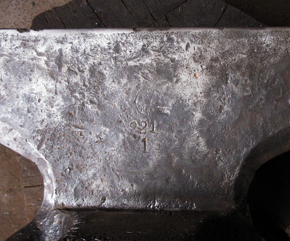

jgg48 replied to Daniel Lea (AKA 99pppo)'s topic in Anvils, Swage Blocks, and Mandrels
Hello from Virginia, You have a beautiful Holthaus anvil. The Holthaus family were apparently wonderfully educated. The overall proportions and form of larger Holthaus anvils are often like sculpture. In particular I love the logo with the triangle in the center and the three associated squares, which is of course the Pythagorean Theorem.- 11 replies
