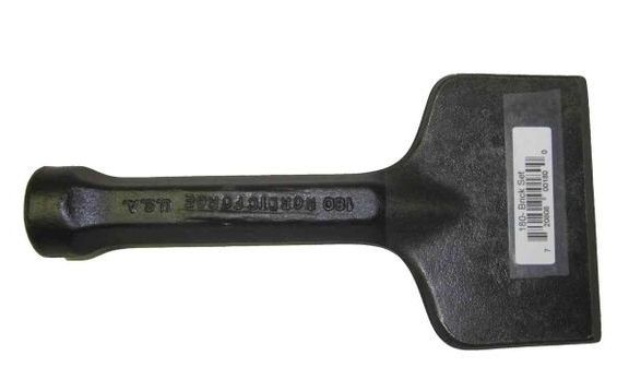

  25. Look for a brick cutter or brick chisel. And holder for the brick chisel
