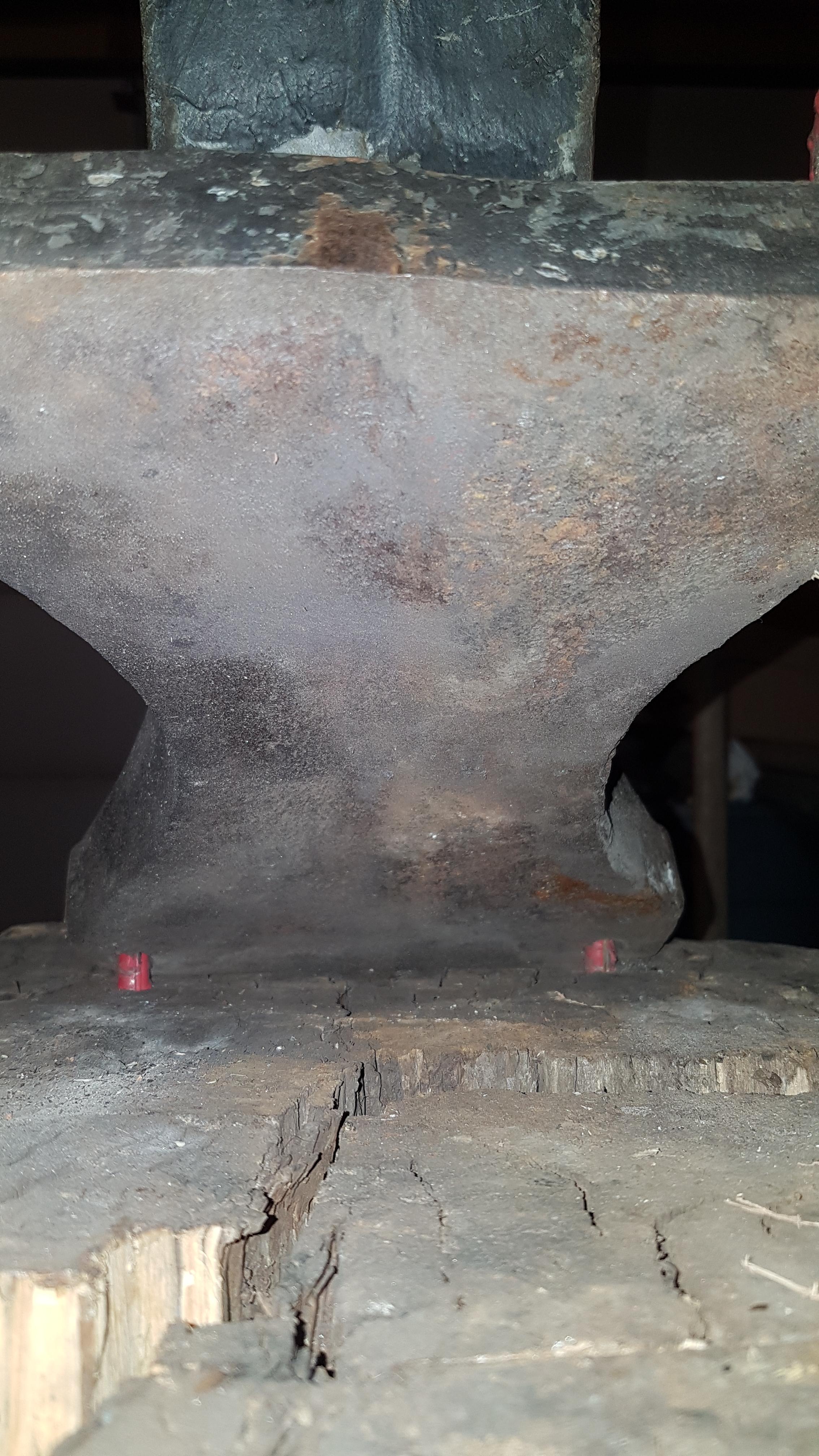

Okay, thanks. I'll look into this. As for the bottom, its nailed to this stump with bent over rebar. Seems to work well and I'll have to probably straighten them rather than pull them out. Anyway I'll get a pic of what the bottom looks like.

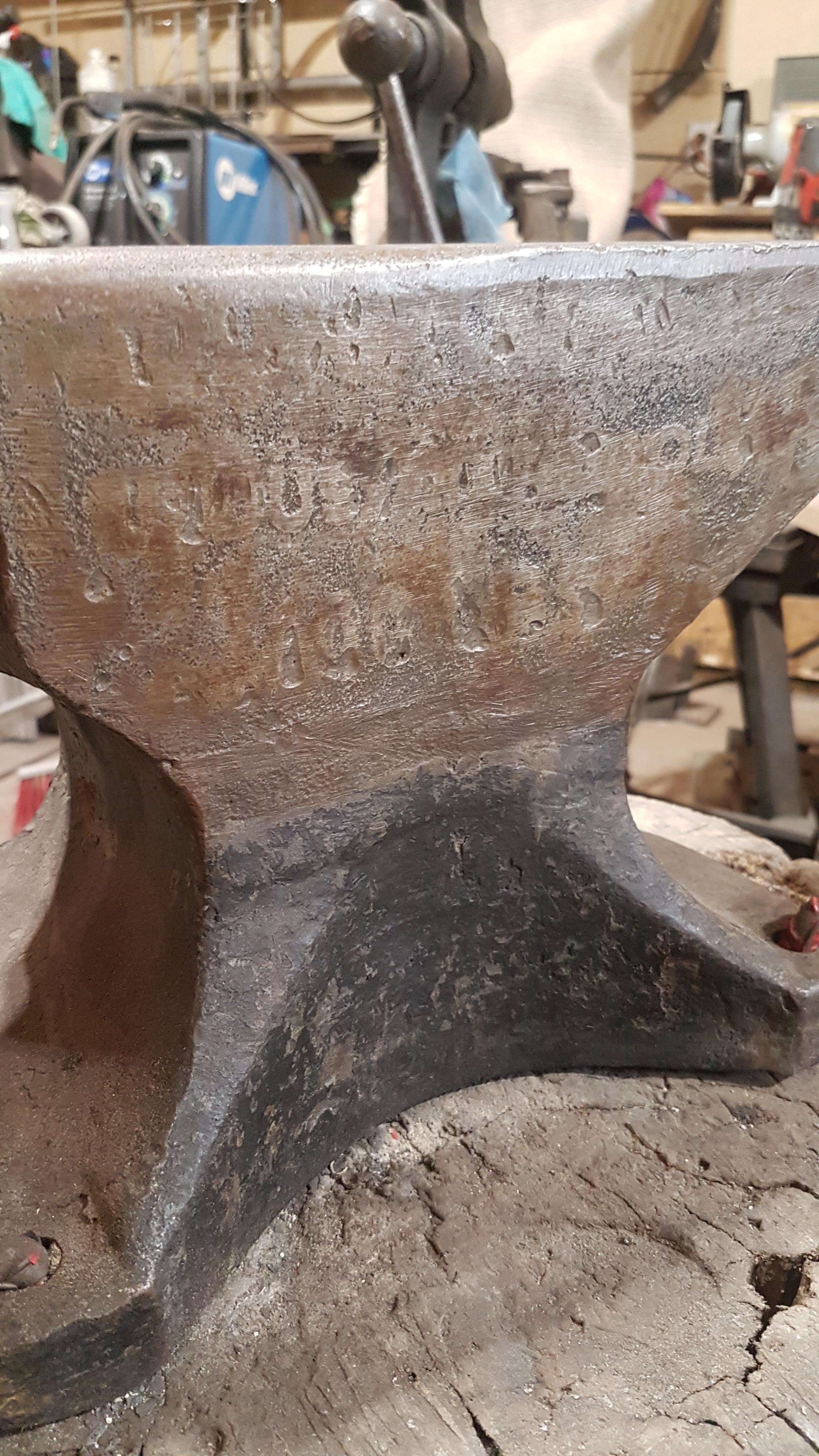

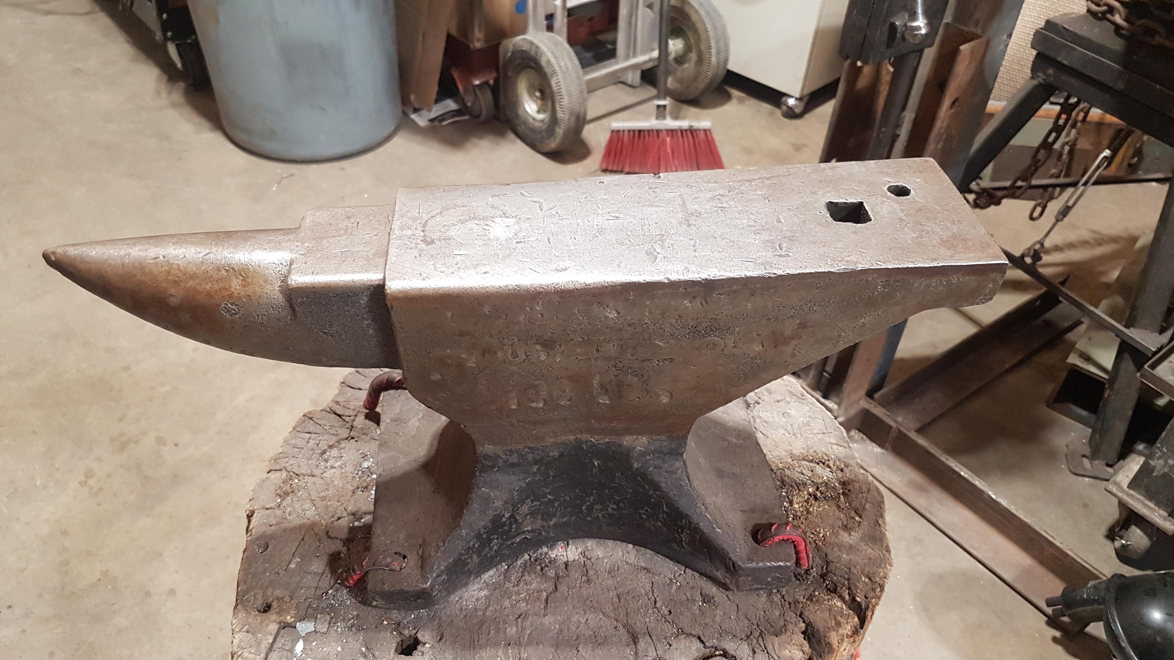

Hello people! I'm about to list this anvil on kijiji and I was hoping to identify it first. The markings have been ground away. All I know is that its 100lbs. It may have come from England as well, but maybe not. Any help at all would be appreciated. Thanks so much

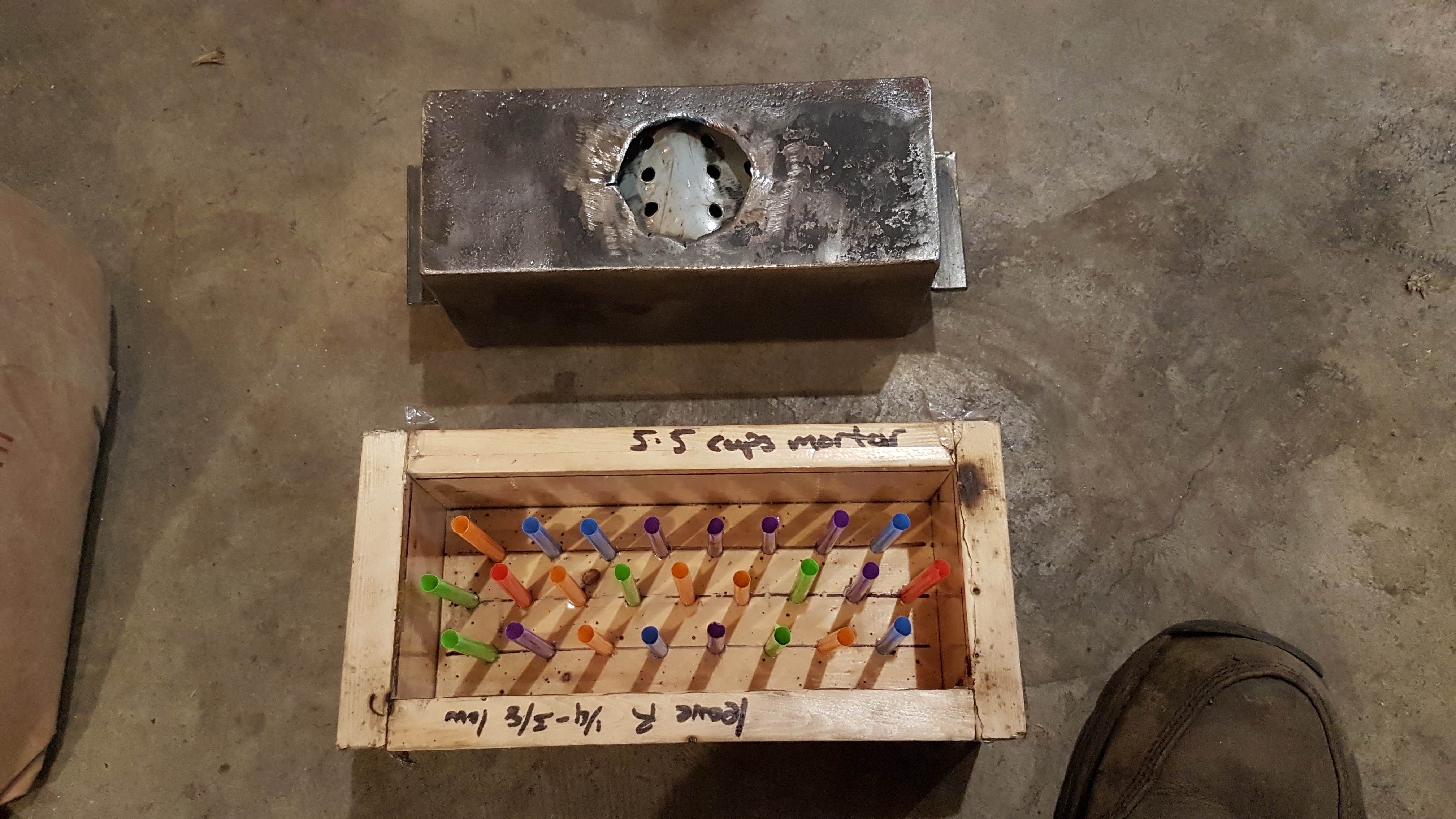

This is my gas forge. When i started sevenish years ago, this forum taught me anything i needed to know. Thanks a bunch everyone. I have now finished my newest forge. Hopefully it lasts. Roughly 1 1/2" thick cast with 1" wool wrap for added measure. Measures 10" wide on the floor by 8 " tall by 14" deep. I made the ribbon burner as many others have. With my 27 hole (i beleive) at 5/16", it has a 2" opening in which the air and fuel are stuffed. The gas orifice is 1/16". I have yet to fully bring it up to temp.

My bad. It's a sixteenth. The id of the forge is roughly an 8 inch cylinder maybe twelve inches long. I have about 20, 3/16" holes in the burner end.
