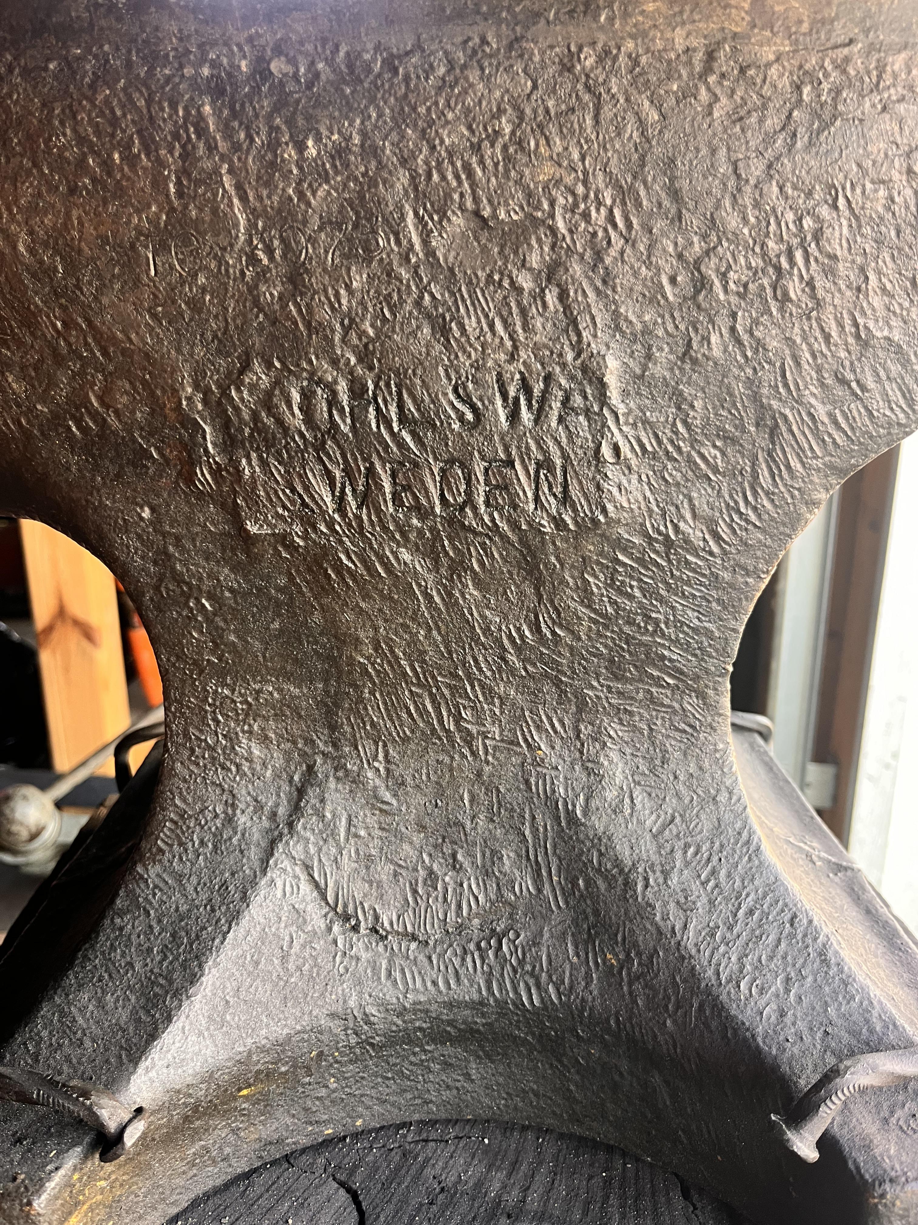

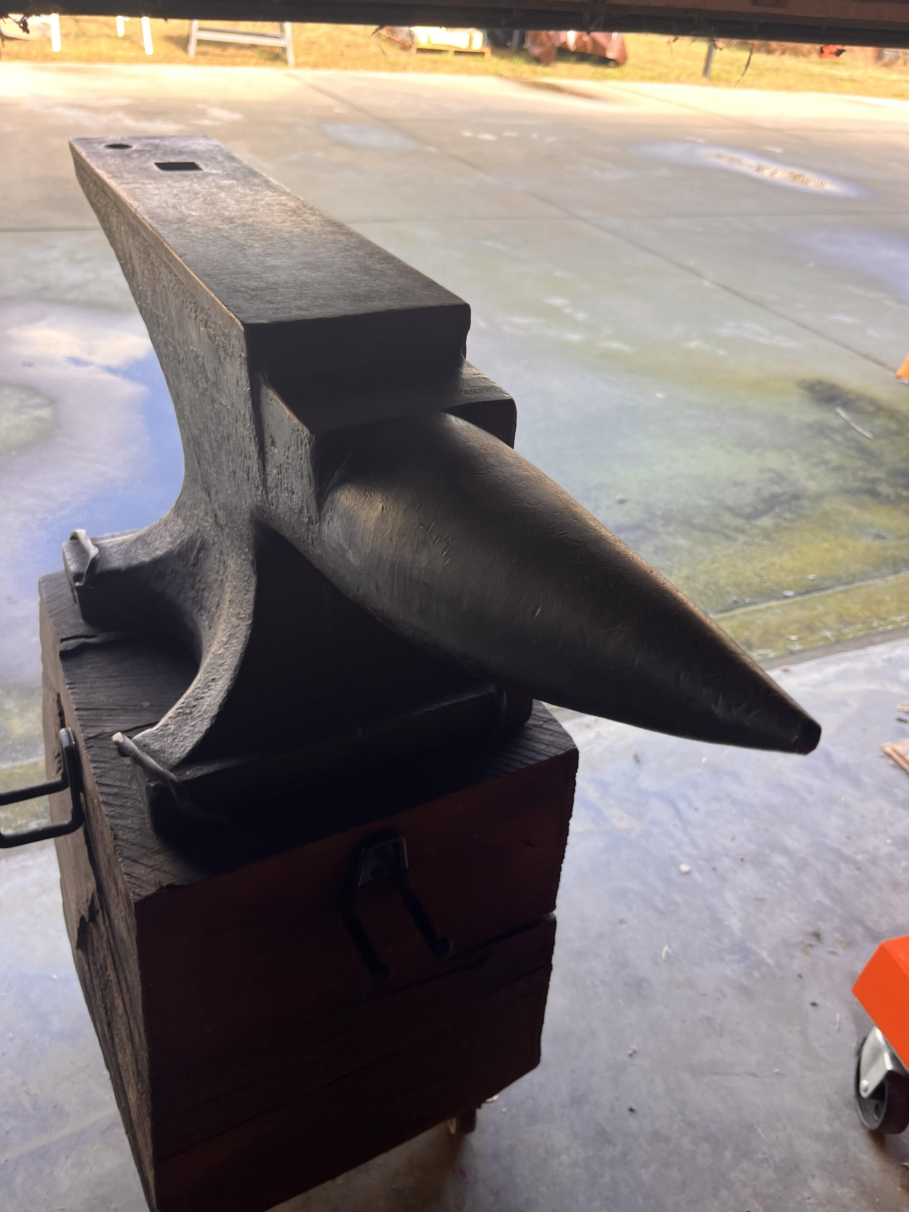

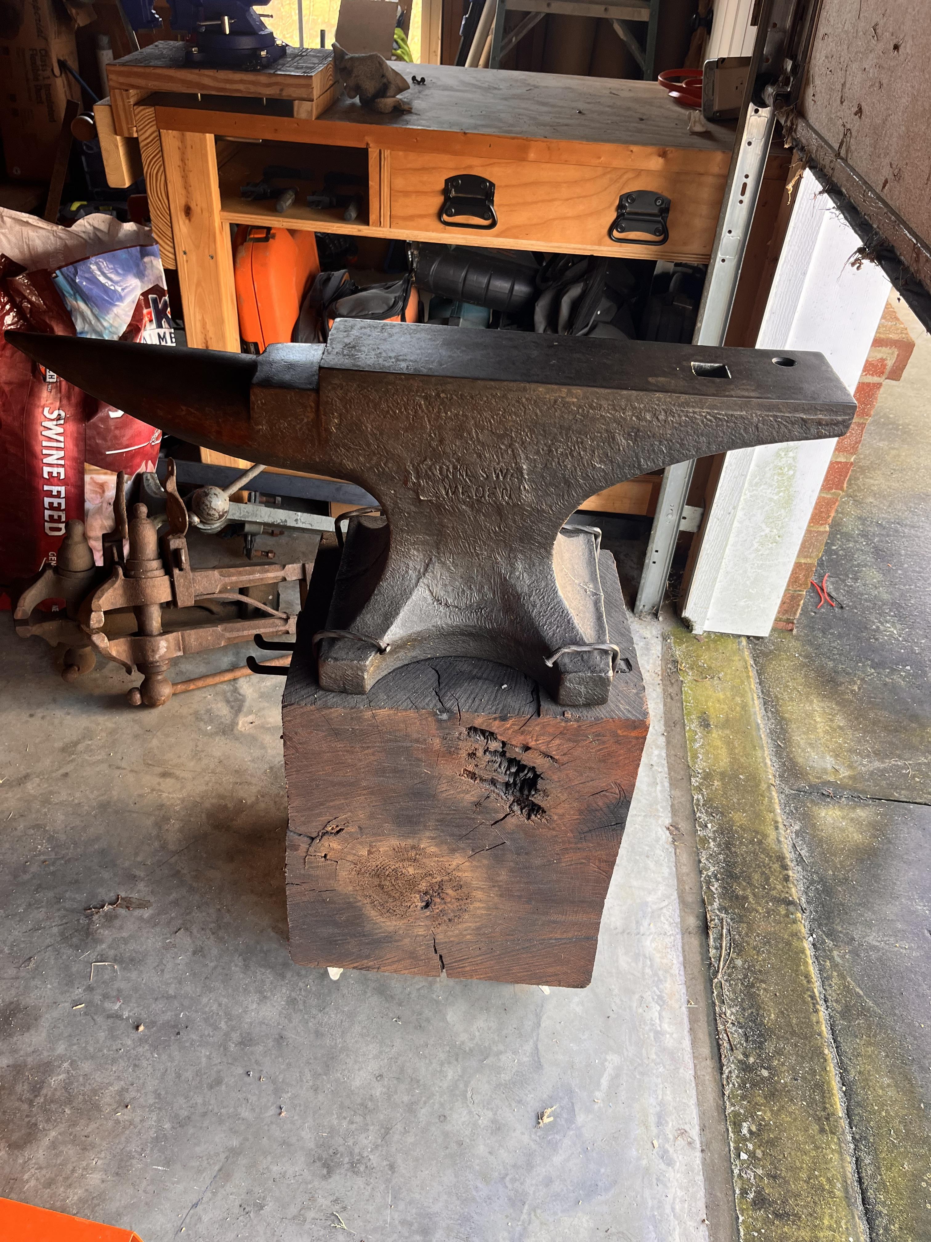

January 17Jan 17 Hey everyone, I am new to this hobby....never even swung a hammer, but eager to learn as much as I can. Hopefully this is my first post of many more. I have been looking to get into blacksmithing for almost a year now and decided to buy a few starter items (old leg press, used coal forge, used welding table and some new hammers, gloves and tongs). I also became a member to a local blacksmith group in Alabama (alaforge.org). With that said, I bought 248 lb. Kohlswa anvil. I don't know too much about anvils except that the face looks like glass with nearly sharp edges. I paid $1400 for it last month, which some might think is overpriced, but considering the condition, I felt it was a more than a fair deal. I did a 1" ball bearing rebound test, and it had a better than a 95% return. Not sure of the year or the value so I have posted some pictures.
January 17Jan 17 You got robbed, that thing is junk good only for a boat anchor. No, really. Seems like a nice score. Comes out at ~$5.50 a pound (if my math in the head is right) which is a little below average price here. Which brings me to this, put your location in your header. Not only will you be surprised how many of us live close to you but we also will not remember after leaving this post where in the world you are at. It does help becuase things like anvil price will vary from region to region. Next go down to the "introduce yourself" thread and, well, introduce yourself. Lets us know your other hobbies and likes. We love pictures of your work, your shop, your tools, your pets, family, whatever. We also love a good story so spin your yarn and tell us about the one that got away. Anyway , glad to have ya and welcome to the group. Oh one more thing, if you have not already go to "read this first" and read. Good info on the do's and dont's and not to use the built in search function.

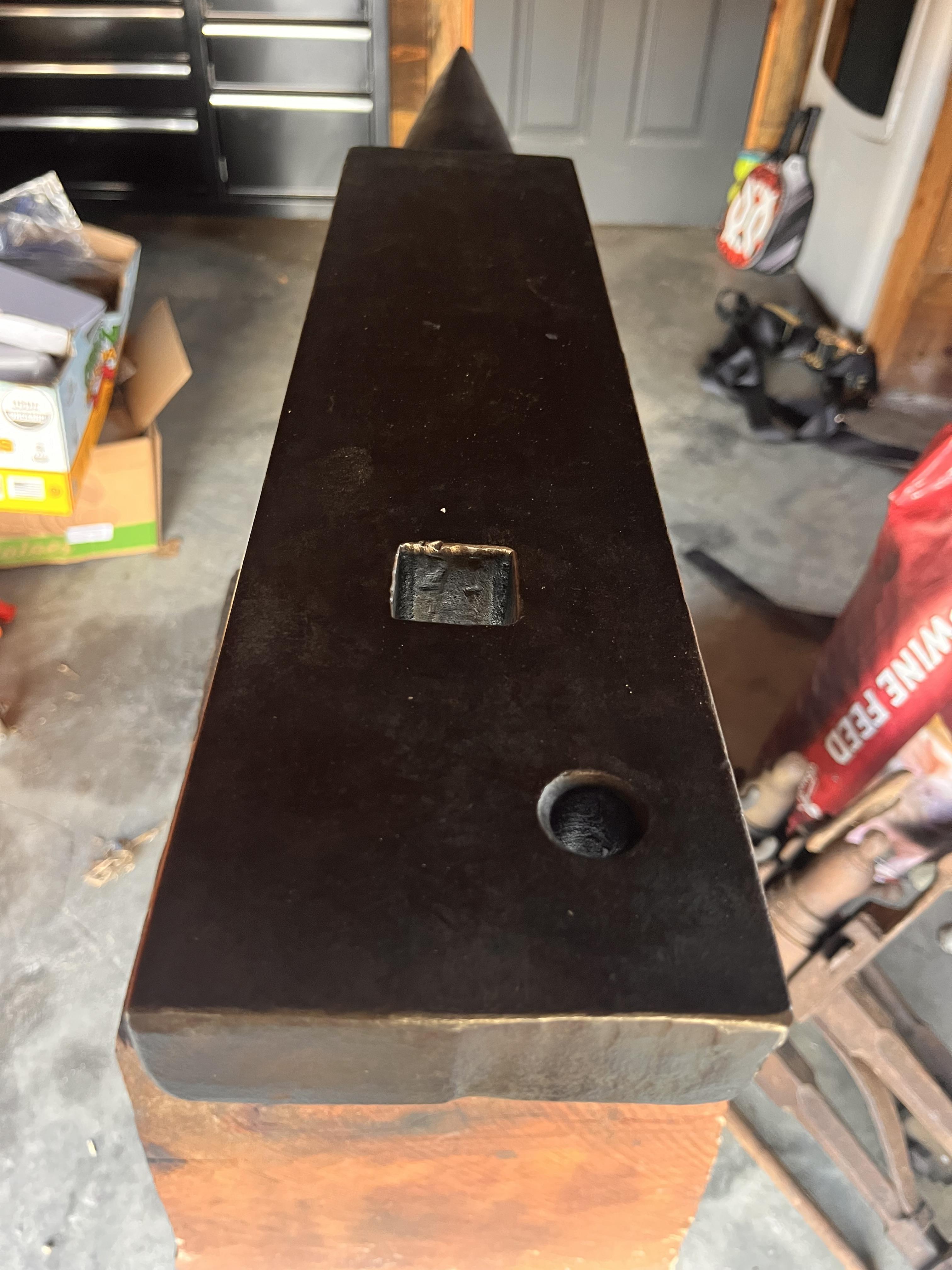

January 19Jan 19 On 1/17/2026 at 10:55 AM, JackG said: With that said, I bought 248 lb. Kohlswa anvil. I don't know too much about anvils except that the face looks like glass with nearly sharp edges. That looks like a barely used (if ever) anvil, and it's the little brother to mine. I think you got a screaming deal on that. There are varying opinions on this, but I (and most) smiths would recommend rounding the edges and I like a varying radius from about 1/16" at the heel to about 1/4-3/8" at the horn.
January 19Jan 19 Author 54 minutes ago, billyO said: That looks like a barely used (if ever) anvil, and it's the little brother to mine. I think you got a screaming deal on that. The guy I bought it from what to sell Kohlswa to put towards his double horned 460 lb RatHole anvil. I was a beautiful anvil. He had my Kohlswa for two years and was afraid to hit steel on it as the face look nearly perfect. He bought the Kohlswa from an old guy who never blacksmith but liked to collect Anvils. He had Kohlswa for 30+ years and never used it. On eBay prices seem pretty high for anvil but I am not seeing them sell. The same with FB marketplace; while they seem to be more reasonably priced, they are not moving. I looked at a website in Europe and prices are about 1 Euro to 1/2 kilogram (1 pound) per weight of steel. Yep, a nice 200 # anvil in Europe can almost be had for $200. Then, while surfing the web for anvils, I saw a new 132 # Vevor anvil going for $198. I understand Vevor are not the best anvils but still, how can one justify $5-$10 per lbs for an old beat up anvil is the US?
