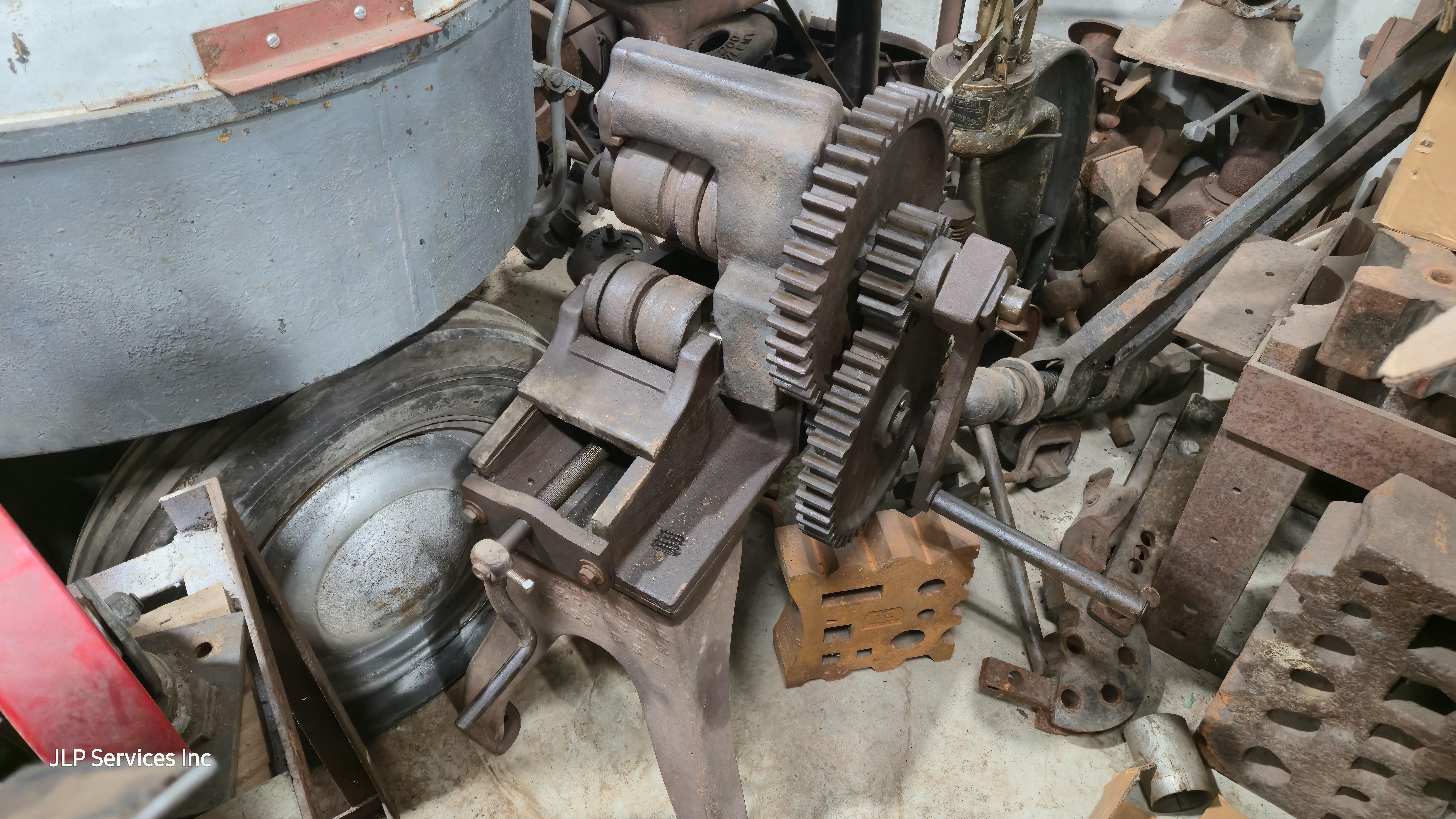

Here are a few traditional tire benders that are hand operated.   The side one is a Boynton and Plummer made in Worcester, MA, they had a how blacksmithing and wheelwright tool producer.  This is a single wheel drive like most of this time frame.

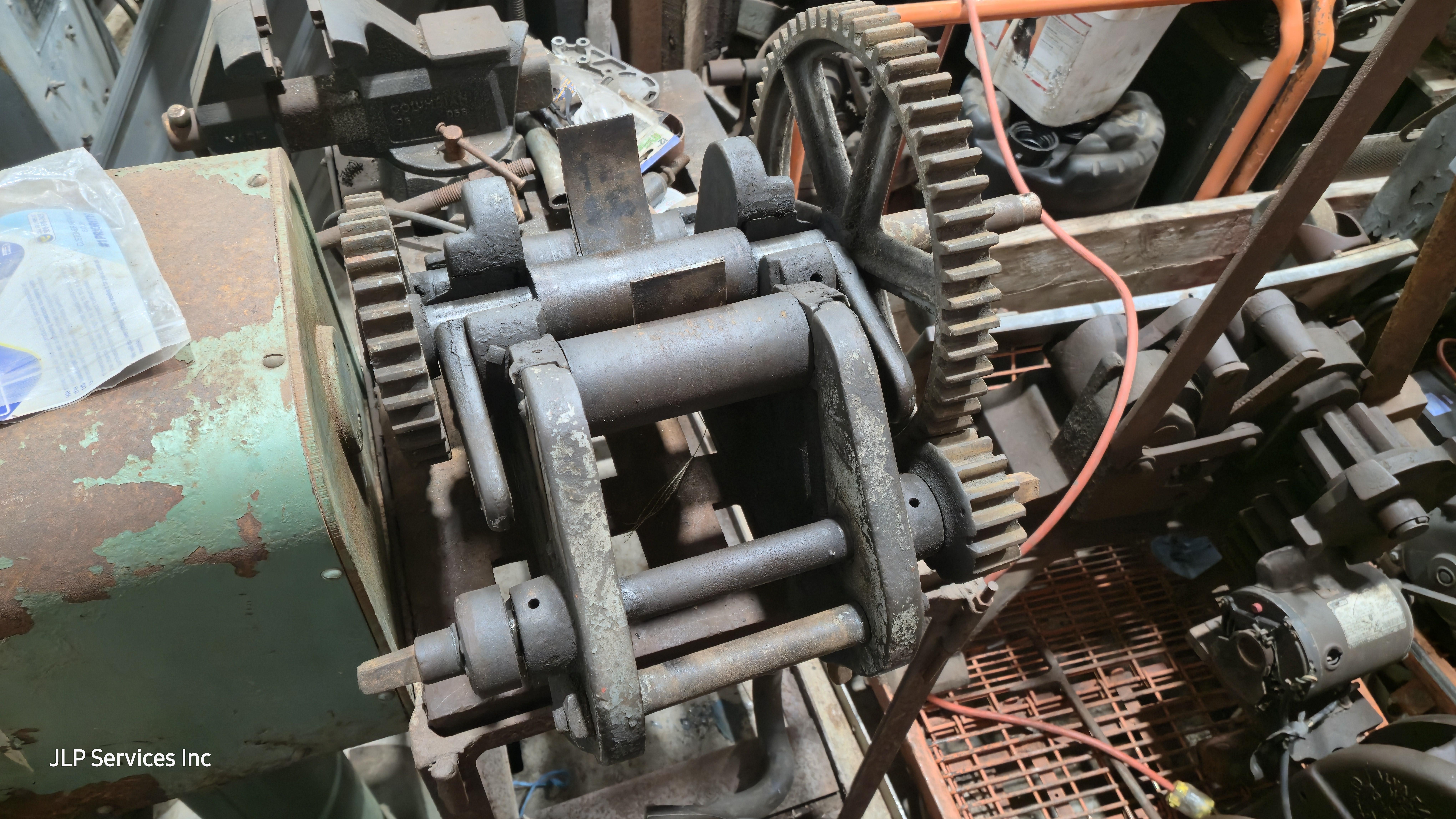

The second photo is of a dual drive wheel type where the hand crank powers 2 rollers..   This was a huge upgrade vs single wheel drive.

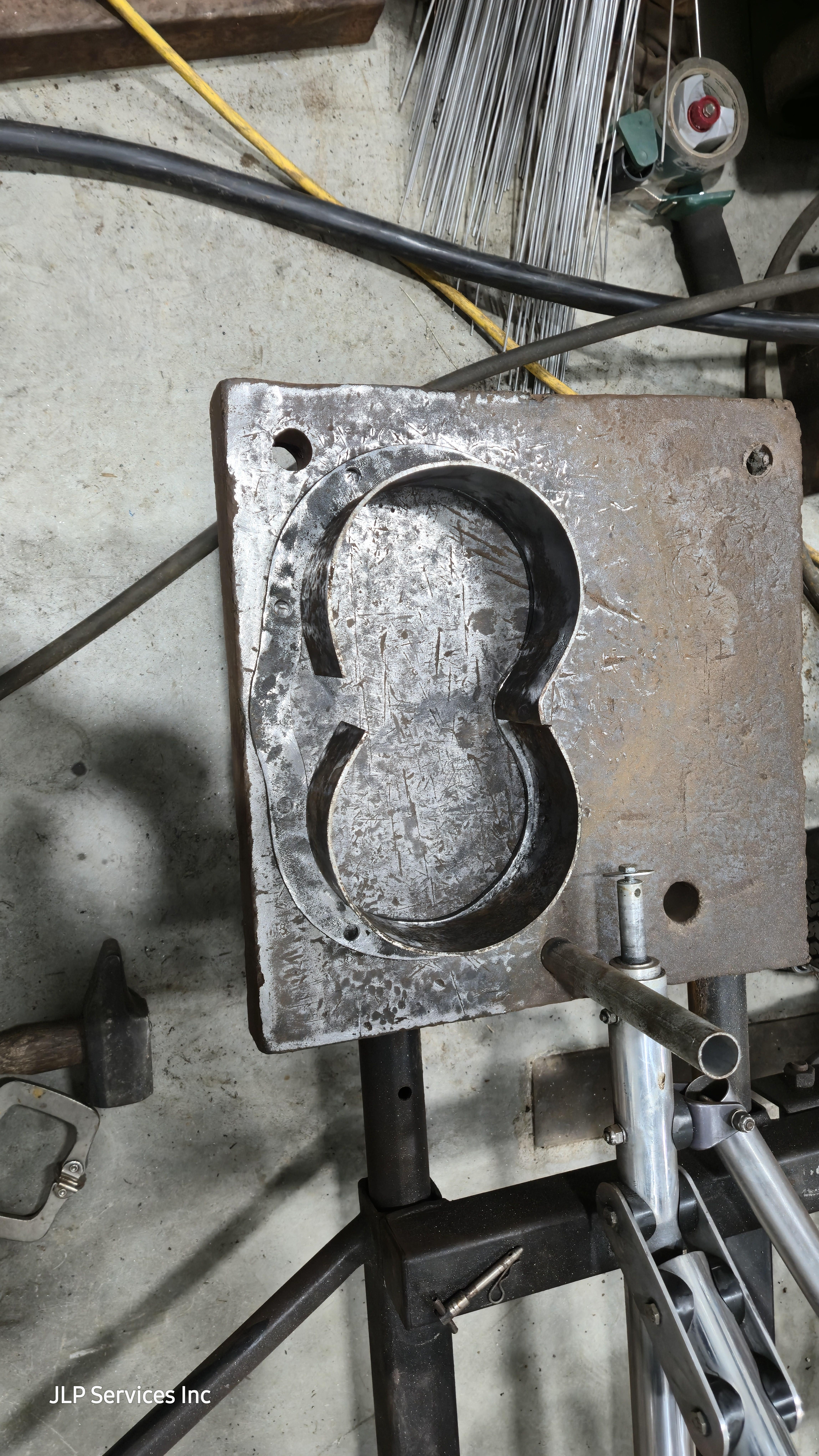

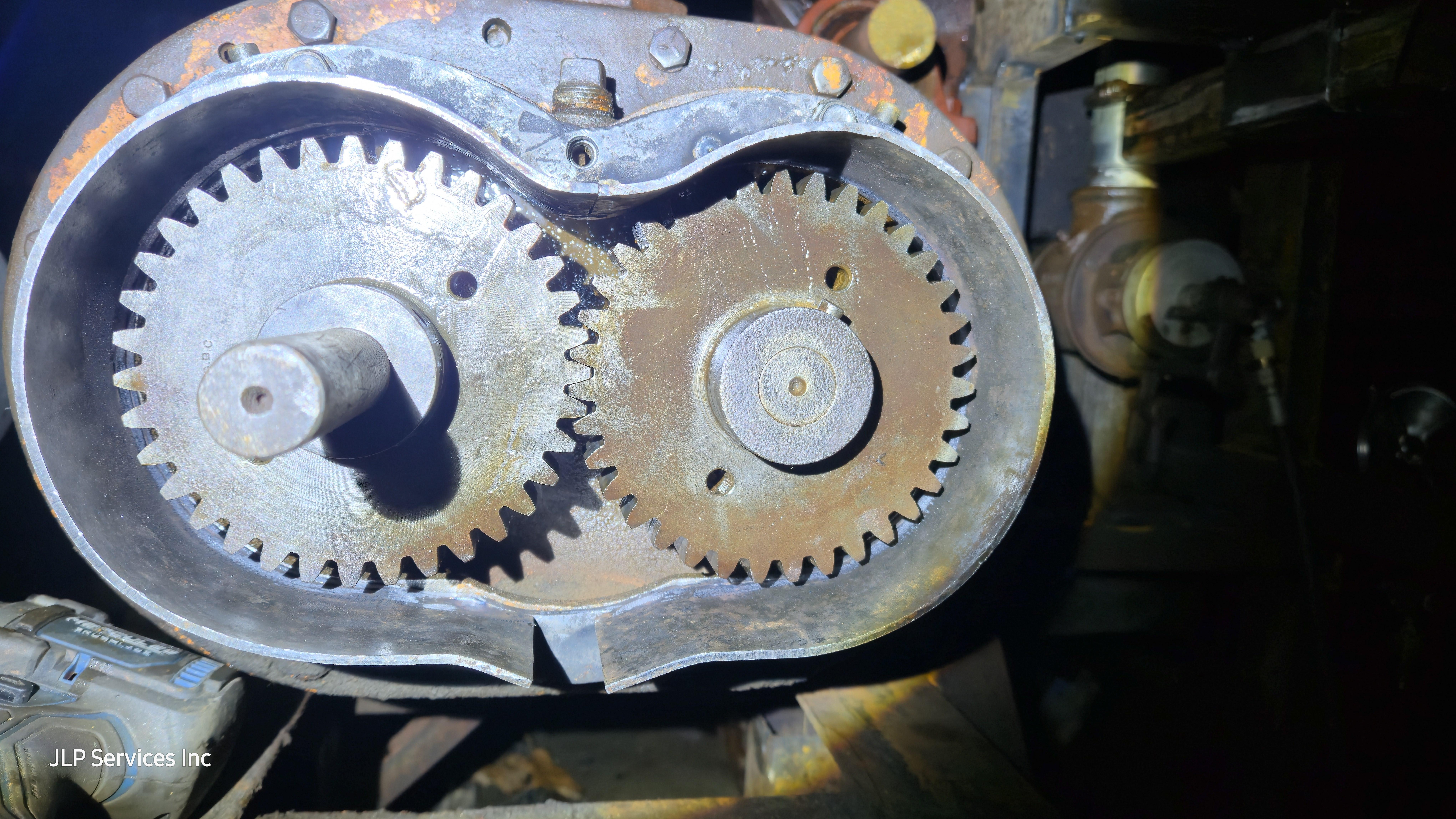

here are the 2 rings bent on the machine.
Same principal as slip rolls for sheet metal work, say rolling stove pipe or similar tube. Ring rollers are just narrower and usually beefier.

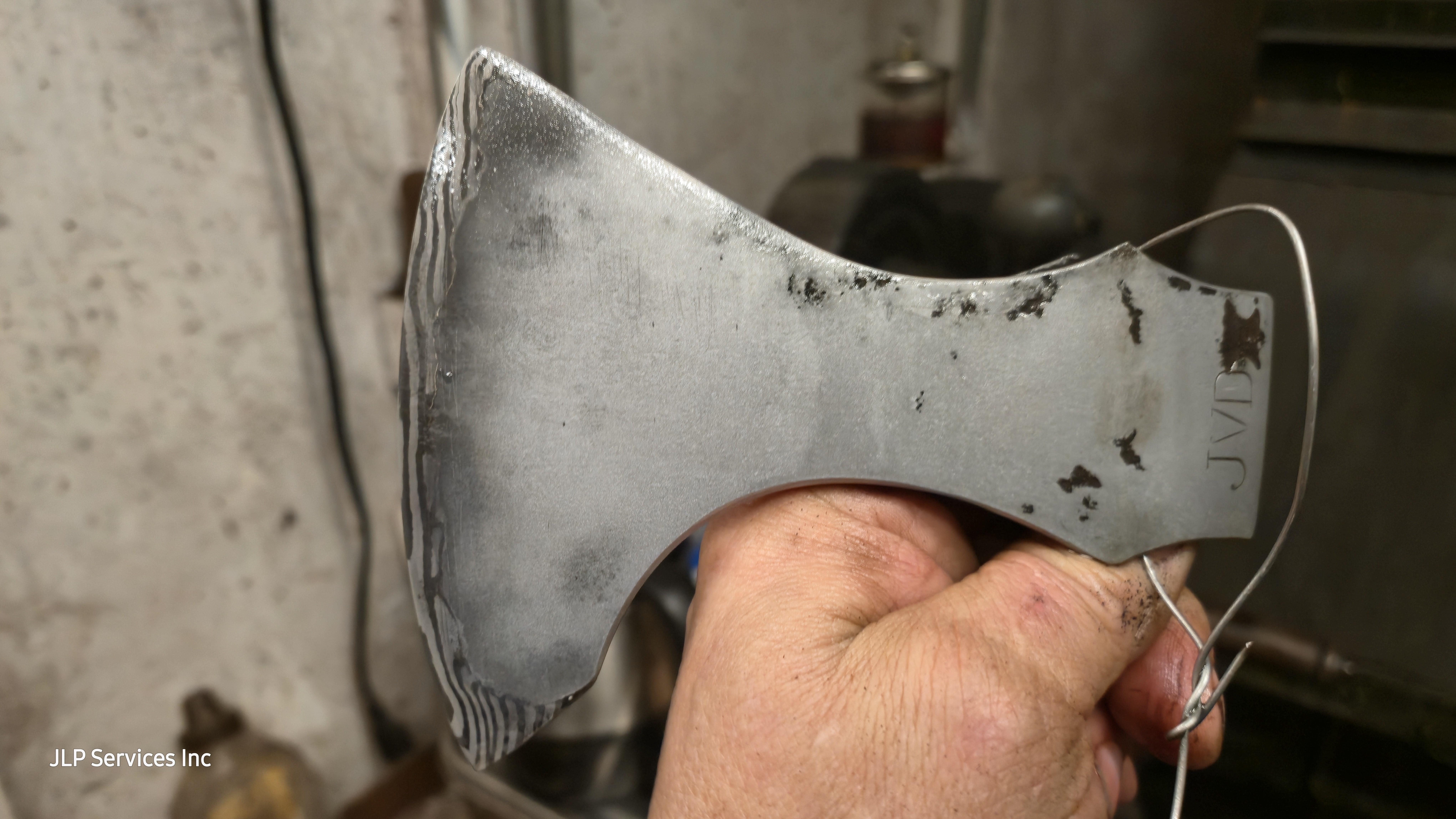

This axe is a perfect example..    There was an attempt to weld it about 6X and the weld did not take. I convinced the person to send it to me to fix..   Yet I was able to weld it and finish it up..   What a gift this person education wise would have received had they had some good teaching guidance.   Just sayin..
