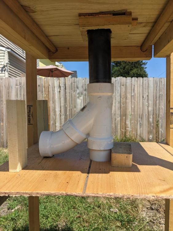

Good morning and/or afternoon and/or evening! I've gotten myself a better, non-galvanized pipe for my tuyere, but I need a grate. What can I use? Here are some photos of my JABOD as it is.

If you have the pipe coming in from the side, there's no need for a grate.
Exactly, what John said. A JABOD is a SIDE BLAST forge into a trench. What you've started on is an unworkable BOTTOM blast. Plastic directly below the fire will fail.
I had it as a side blast before, but I couldn't get that to work, so I thought it might work better as a bottom blast. Was I wrong? Should I make it a side blast again?
Yes. A side blast is simpler to make and to repair. See the original JABOD thread for a good discussion of dimensions and setup.
What didn't work with your earlier setup?
Yes. You have to learn fire management, the forge is literally just a fire place and can't do anything without the human hand.
Even a properly designed and built bottom blast takes more skill to manage and burns through charcoal like crazy regardless.

Good to know, thanks. I guess I have more work to do... Better than sitting around doing nothing. The way I had it before, it didn't seem to be getting hot enough. I was able to get some rebar to a red heat one time, and then I heard somewhere(I forget where, maybe I should be more hesitant to trust information from uncertain sources...) that bottom blast was generally superior, so I figured that might work better. I'm glad I did switch it though, because it made me slow down and stop trying to use galv.
Fire management is key, and will vary depending on what fuel you're using.
If you do keep it setup as a bottom blast, flip your “y” pvc coupler over and add a steel pipe section below it. That way any hot coals or clinker that falls in is more likely to drop straight through to a heat resistant section. PVC won’t last long with hot coals in it.

Maybe it wasn't clear in the image, the PVC is open at the bottom, so in theory any coals that do fall will just fall through and land either in a steel bucket, or in a plastic bucket filled with water. I'm not quite sure why you think I should flip the y over, if I did that, wouldn't the air go down?
Geoffrey: The plastic pipe WILL NOT WORK. I don't know how many times experienced smiths have told you that already but I'm pretty sure this is #3 from me.
Forget ANY plastic attached to the air grate, PERIOD, forget attaching it to the T in the air supply.
If you're taking a welding class you're in luck the drawing below is an easy to make low cost and very effective air supply for a bottom blast forge. All that's necessary to add to the below is a flange welded to the exhaust pipe vertical section and and screw or rivet the flange to the pan or firepot and it's a done deal.
This is a rendering of one I made before I thought of an easy way to make the ash dump. An updated version has you visiting a truck exhaust shop and buying one each. Exhaust cap. Those are the caps on top of truck exhaust stacks that open when the engine is running and fall closed when it's not. Yes? While you're there ask for a piece of exhaust pipe it will fit. The commercial versions clamp to the pipe with a clamp similar to an exhaust clamp so you need the pipe it fits. A shop that works on truck exhaust systems should have plenty of drops (short cut offs) kept for places they'll fit so they don't have to cut a short piece out of a new length.
The horizontal air supply pipe is 2" exhaust and only needs to be maybe 10" long and is welded to the vertical. It connects via a piece of vacuum cleaner hose to my hand crank blower or other smaller air supply, bellows, etc.
Things I learned making this one. The vertical pipe above the air supply only needs to be long enough to reach the bottom of the forge pan or firepot. The one in the pic is way too long. If you have hole saws simply drill a hole the vertical pipe barely fits through just far enough, 1/16" is plenty so it's easy to weld with a gmaw welder to make the mounting flange. Don't make the flange large, a couple inches wider is all you need for pop rivets and 4 is plenty.
Make the length of pipe below the air supply 8 maybe 10" below for the ash catcher, you want the hot clinker, coals, etc. far enough below the air supply it stays cool even if the air isn't blowing.
I welded the long extension to the exhaust cap thinking it would need the extra weight to close but the counter weight on the truck part is designed to close the cap and is long enough to reach under the forge with tongs, piece of stock, hammer, etc. and open to dump the ash.
Anyway, that's all it there is to it. pop rivet or use self tapping screws to attach it to the bottom of your forge table, firepot or whatever and your fire grate just lays on the opening.

I don't think I understand, what's the issue with using plastic? Even if coals fall through the grate, they won't touch any plastic, and if they do, as long as they don't go into the offshoot in the y joint, they won't touch it for long enough to do much if anything, since the PVC is open on the bottom and I'm going to put something underneath it that won't burn or melt.

I'd lay heavy odds that at any reasonable level of blast, the air will change directions and exit through the bottom before it forces it way up through the fire.  And of course if you block off the bottom, you'll be trapping hot coals in the plastic pipe.
If you're determined to try this, submerging the end of the pipe a few inches deep in a bucket of water might create enough of a seal to force the air upward.  In addition to coals falling down the wrong pipe, you'd still need to deal with heat radiated down the steel pipe and conducted through its walls, as well as steam from coals quenching themselves and probably some other factors I haven't thought of.  But it might work long enough for you to learn something -- just make sure there's a fire extinguisher handy.
In theory, the pipe might not come in direct contact with hot coals. However, that would only happen if the bottom were open, and as Mike BR points out, that would allow the air to escape and make the whole thing useless.
Even if by some miracle there were no direct contact, there’s going to be enough heat there to soften and degrade the plastic, and PVC gives off toxic chlorine gas as it degrades.

I don't think I'm going to use the PVC pipe after hearing this...
Thanks for the warning, I'll get some fittings that won't kill me.
