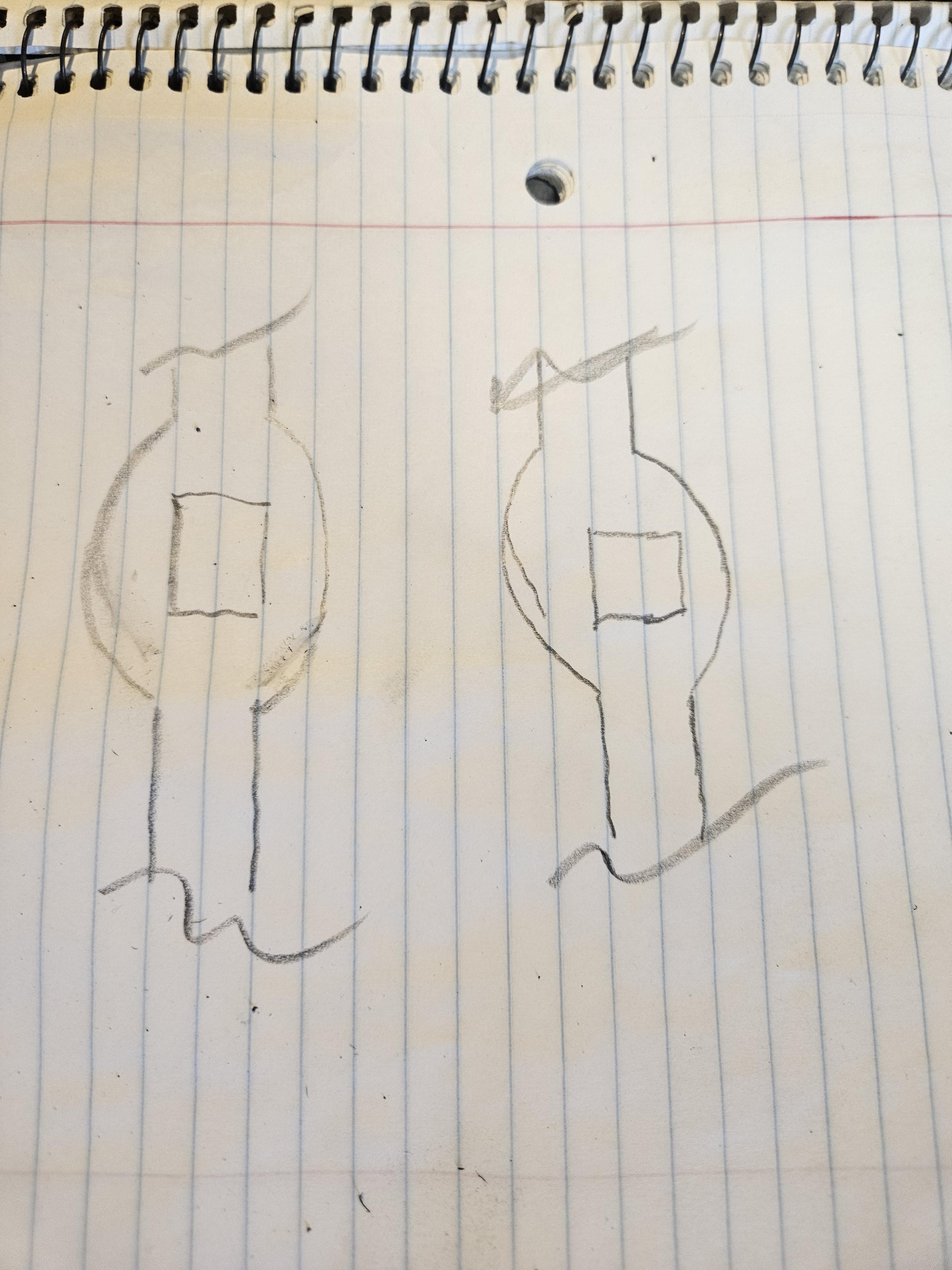

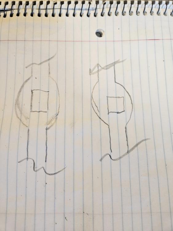

I have an up coming project that has pass throughs. While practicing i had one go wonky. One side of the bar went out of alignment with the other. The slot was center nicely when i cut, even swell on both sides, the flaw happened while upsetting to open the slot to get my drift in. I know where i made my mistake when upsetting, to much hot bar. I fixed using a combination of swage block, hardy hole, etc., etc. just working it a little at the time till it was acceptable, not perfect but acceptable. I see it still but most wont. The problem was it took me about 2 1/2 hours and many, many heats and spot cooling.
Since i got the bar "fixed" here is an illustration of my problem. Excuse my crappy drawing skills, but the one on the left is how it should come out and the one on the right shows how the bar drifted to one side.
So does anyone know of a quick easy way to fix this?

The "easy" method is to get another bar and do another. Seriously I'd do what you did, lots of heat and adjust as I go till it was right. If it were a round hole you can drive the hole where you want it within reason. Use your bar that fits the hole, and either drive the drifted bar from the thick side, truing it regularly. Or you can put the round bar in a vise or open the vise so the drifted swell bridges the jaws and using a block of wood and large hammer bump the bulge towards the thin (bottom) side, re-drift and refine.
There are as many ways to adjust a drifted bar as there are smiths who do it.
The problem is quite hard to explain, i should have taken a pic before i fixed it. But i am not trying to move the hole i am trying to move the bar next to the hole. If i move the hole then the other side of the bar where it meets the swell goes off center.

So, it was slit, then upset from the ends to open the slit to a semi-square shape before applying the drift, and it went off to one side?
Were it me, I would try to upset as much as needed for the piece before drifting (except that it will always spread wider when drifting) then use a more tapered drift or two drifts if needed, one to open the slit and one for the final shape. You can also upset a bit with the drift in as suggested above by Frosty and move holes and the material around them a bit; sometimes its easier if you apply the heat more to one side - the metal moves more where it's hot.

If the sides of the slit were a TINY bit different it WILL upset towards the thinner half, bending.
And there you are, an off center hole sometimes tilted.

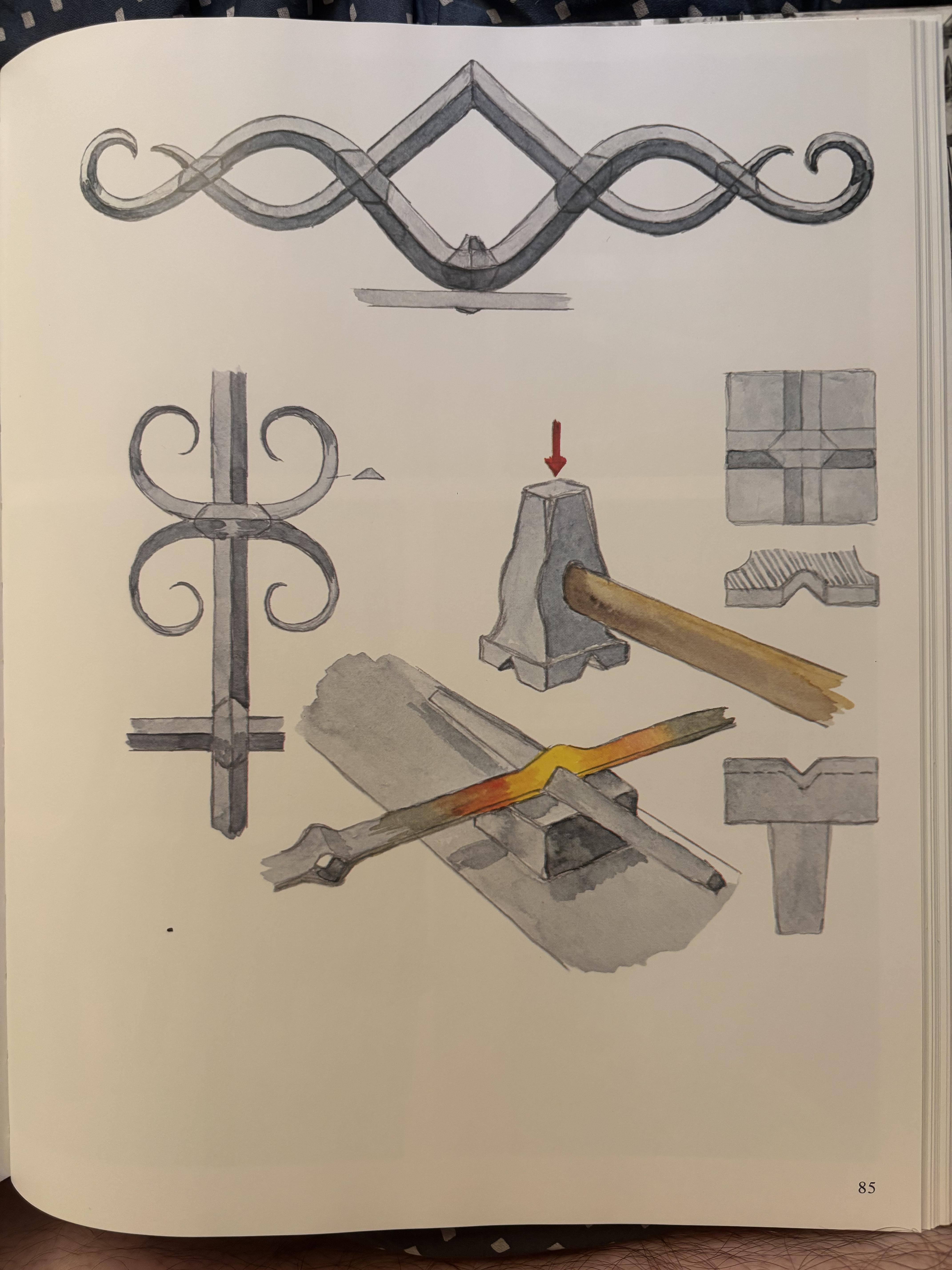

A bit late to the party here, but I see what you are trying to fix, and the only "easy" way I know to do this is to make and use top and bottom tooling to straighten the bar perpendicular to the drift.
Otto Schmirler's book has an illustration, IIRC.
I forgot to check my Schmirler book this week, but maybe it was from Mark Aspery's book #3 in the pass-through ring project...I'll try to remember to check today, but no guarantees.
Yeah, who doesn't have racks full of closed die type top and bottom tooling? Are there directions on how to make that kind of specialty tooling?
12 hours ago, JHCC said:
This one?
That's the one I was thinking of.  Thanks for covering for me, it was a long week in the shop with new members...
