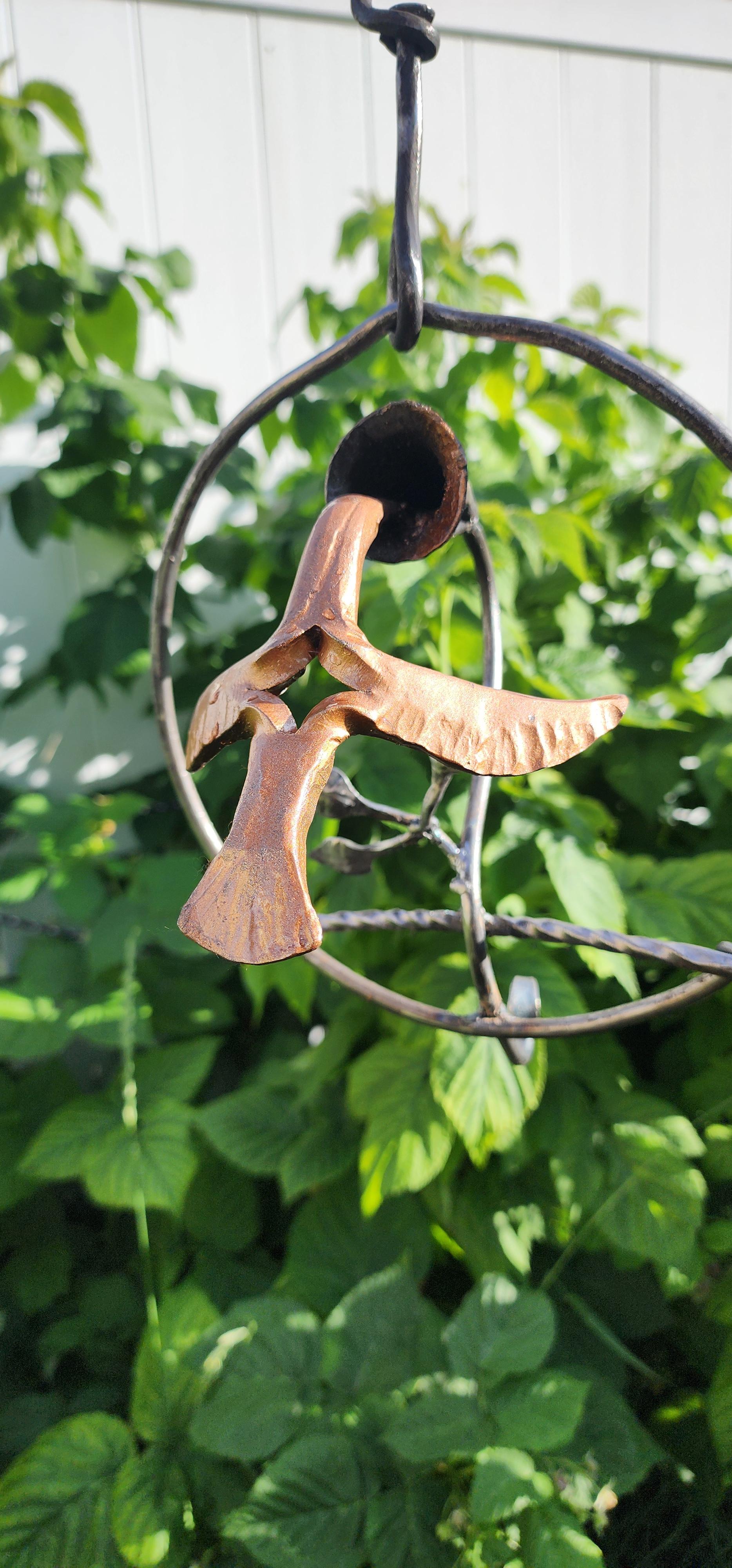

I've been doing the freidrich's cross hummingbirds and just wondered if anyone had tried melting glass and adding it to a piece.  I think that a piece of red glass in the middle of this would look amazing.

I'm looking to melt in different colors of  glass into the opening of my freidrichs hummingbirds.   I think it would be a great touch to make them stand out.

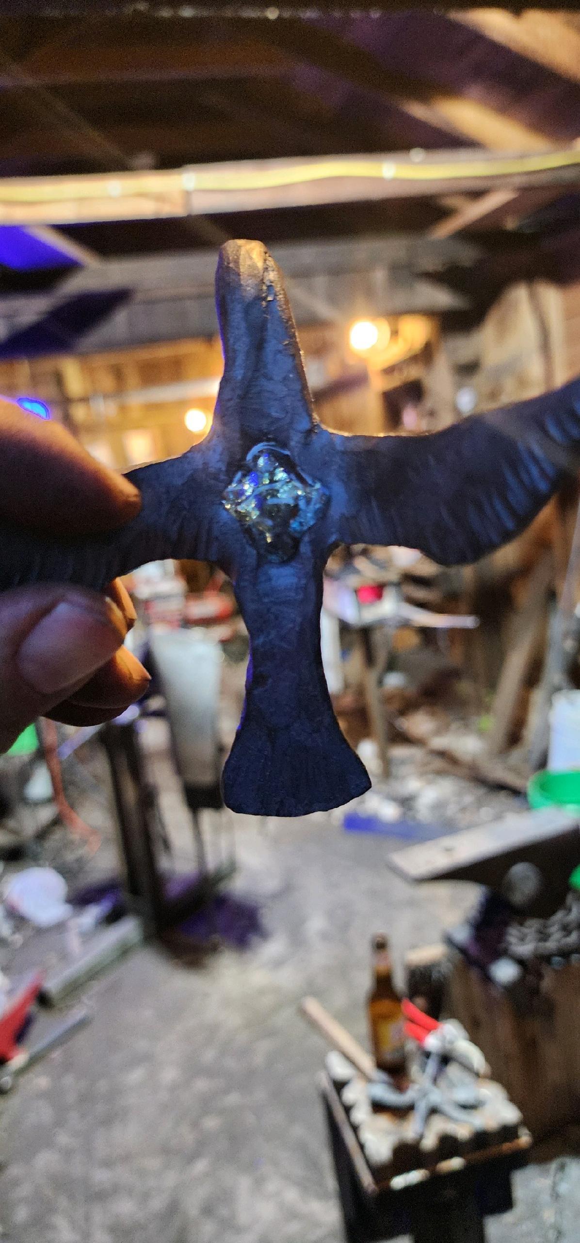

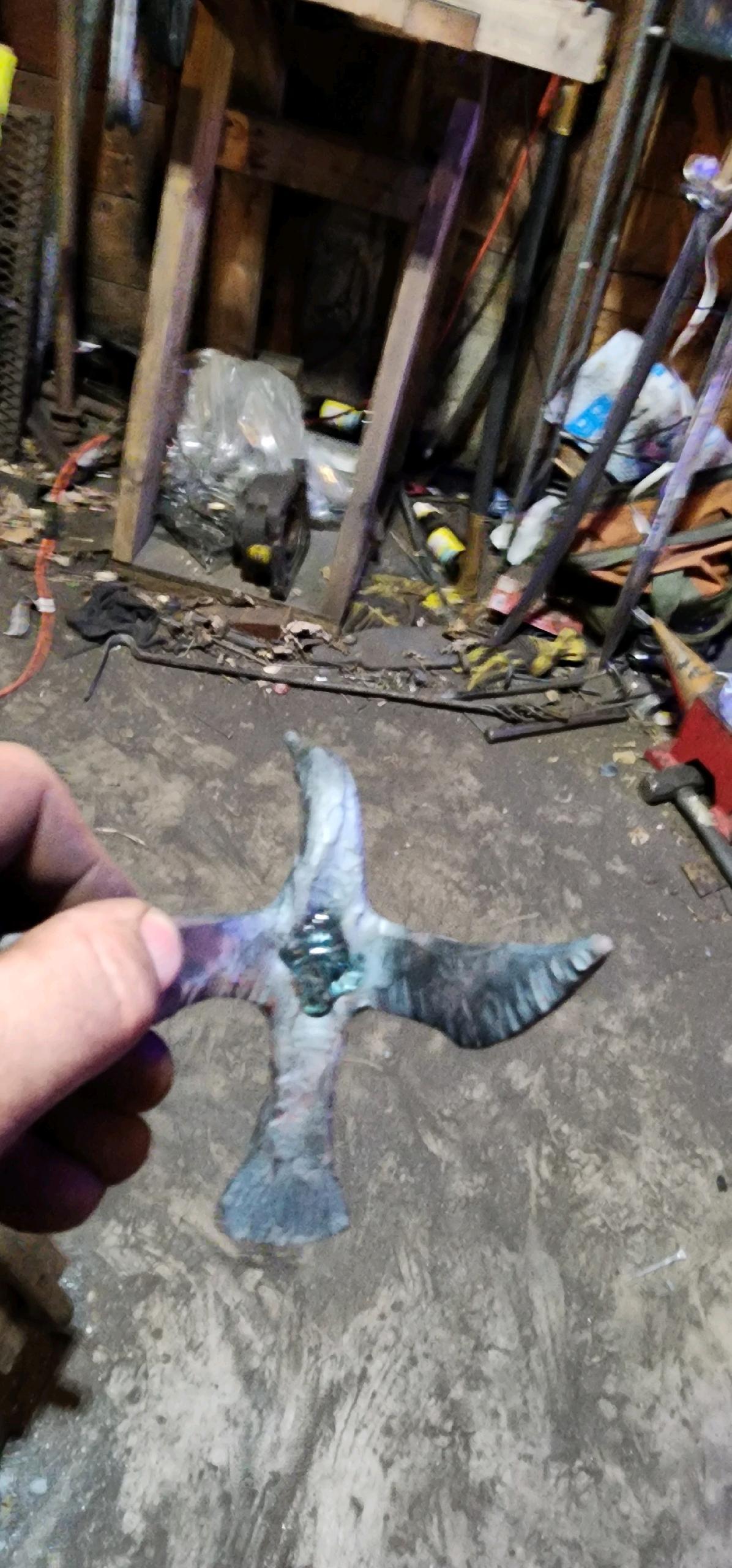

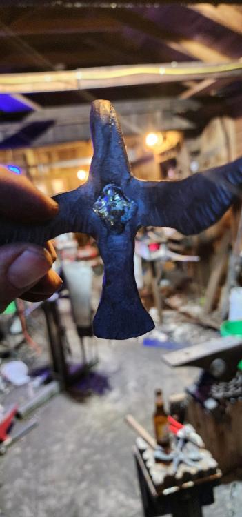

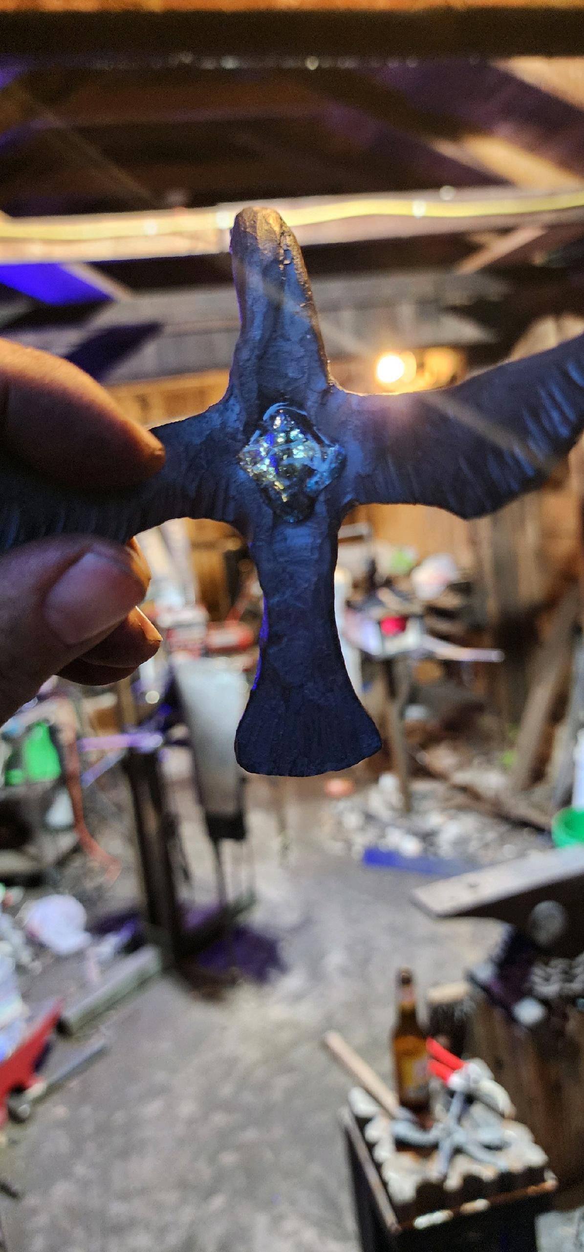

Ok, I went for it.  I used the glass pieces that people throw in the bottom of a fish bowl.   Heated them up in a large spoon I had forged and started warming up the hummingbird.   I had not cleaned the forge scale off yet.  I had the bird at the opening of the forge to start warming it put it on a piece of fire brick on my anvil and started pouring the glass in.   It moved like molasses so before I got it poured I put it back in the forge asking with the bird.   I grabbed a piece of scrap tried again and got it poured and it froze sticking about am inch or so above the bird.  I threw it back in the forge towards the front and let it start falling into place.   I grabbed my flat face punch and used that to push and shape the glass into the opening.   Heated one more time then set it outside to cool naturally.  I'll see if it has any problems overnight but it was cool to the touch when I took these.

Thanks for all the info guys.   I checked on my piece this morning at it was still intact but I'll attempt tp temper it this evening when I get home.  I'll fire up the forge,  get it to heat and shut it off, putting the piece in there.   It isn't as precise as it probably needs to be but it is what I can do.   I feel like I've opened a whole new can of worms trying this.  I'll have to re-read this all a couple times and see what I want to try and what I don't want to mess with.   I think slumping marbles may be as in depth as I get here.
