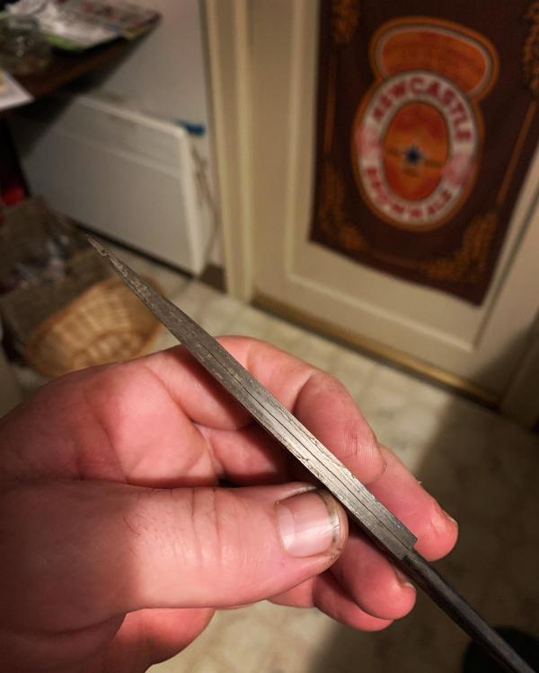

Greetings all, been gone a long time.  So I'm having a reoccurring issue. I'm making a laminate blade using an edge steel of high carbon, clad in 15n20, and that is clad in wrought iron.  I'm on episode 3 of explicatories and thought I'd ask some of you beautiful minds.  First attempt was using an edge bar of 1095 and it went great until the temper where the edge bar split down the spine as shown here.
Next attempt I used an edge bar of 1084 and everything looked really good.  I started hollow grinding the edge and found this.  I noticed it was only on one side of the blade so I began chasing the crack trying to get past them.
So my question is.. what the heck am I doing wrong?  I know my temps were good and the material was good.  Quenched in the proper oil at the proper temps and tempered twice at a reasonable temperature.  I'm about to run out of curse words here.  Thanks for letting me rant and I appreciate any feedback.

What are you fluxing with and how? Not that I'm a bladesmith guy but I've stuck a few pieces of steel together.
Hello Mr Frosty, good to see you still around. I'm using store bought borax and it's in a parmesan shaker. I use a brush to clear off the slag and sprinkle it on the edges before putting it back in the forge.

You might try a better, more aggressive flux. Hit the local welding supply and look through the torch welding section. I switched from 20 mule team borax and boric acid mix to Peterson's #1 blue, commercial flux, $26 / 1 lb. can. when I bought a can, it looks to cost a bit more now but it works as well as any "real" forge welding fluxes I've tried for about 1/2 the price or less. Peterson makes some real aggressive fluxes for stainless too.
I polish all the joint surfaces on the belt grinder, (400 grit) wipe them IMMEDIATELY with a light lube oil, 3in1 works a treat, DUST everything with Petersons and tack weld them together with the mig. Or wire them if you wish to go old school.
All you need is a prophylactic barrier between clean steel and atmospheric oxy. A light dusting BEFORE you apply heat will melt and coat the steel before the oil burns out. The oil leaves a pure carbon residue which reduces the melting temp of the steel AT the join surfaces.
You won't see molten borax squirting out of the joint and it's unnecessary because there won't be any scale to flush out if you flux before it can form.
After you set the weld, brush or file the edges and flux before it cools, capillarity will draw flux into any gaps. Reheat and refine the weld.

WIll you by chance be attending the Northwest Blacksmithing Association Spring conference in Longview Wa? Its this next weekend. Would like to shake your hand and buy you a lager.  Also, excellent advice on prepping welds. I'll steal this from you and try it. My issues weren't welds but the center steel being absolutely man handled by the cladding.. splits, cracks inside, questiong my life's choices. I appreciate the wisdom an be good Sir!
What quench oil are you using? You may have to move to a slow quench to reduce the internal stress. Also, are you going directly to tempering cycles after the quench?

Question: Is the weld delaminating, or is the core cracking? Those are two different problems.

Maybe nothing.   If you haven't already, you should watch the video that JHCC linked to above.  The first time I saw this phenomenon I thought it was delamination at the weld seams, but closer inspection revealed the hard core split down the middle and the welds held.
The only quasi-remedy I've found is to use a thicker core and thinner cladding if you want to use a non-hardenable material on the outside.  Unfortunately that means you have less material you can grind away and still get the effect you are after, so you have to forge pretty darn close to final shape if you go that route.  In the video he suggests that applying clay on and near the spine for the quench may decrease or eliminate the phenomenon as well.  I haven't personally attempted that approach, but it's certainly worth a try.

Fair enough Frosty. Southern vet so it just comes out without thinking. I’m going to give this laminate one more shot. I’ll do an edge quench on a mostly ground blade. Breaking down wrought iron in a propane forge is not as much fun as it should be but once more into the breach! Thanks for all the information and comments.

Bearing in mind I am not a bladesmith so my opinion is FWIW. I never really understood edge quenches except for shaping a blade. It causes a lot of stress. The few blades I've made were given a progressive temper by heating from the spine with a torch. The stress builds slowly enough it can distribute and relax during the process.
Quenching works because the temperature change is too sudden for the carbon to come out of solution with the steel. An edge quench focuses all the sudden stress in a narrow strip on the edge.
