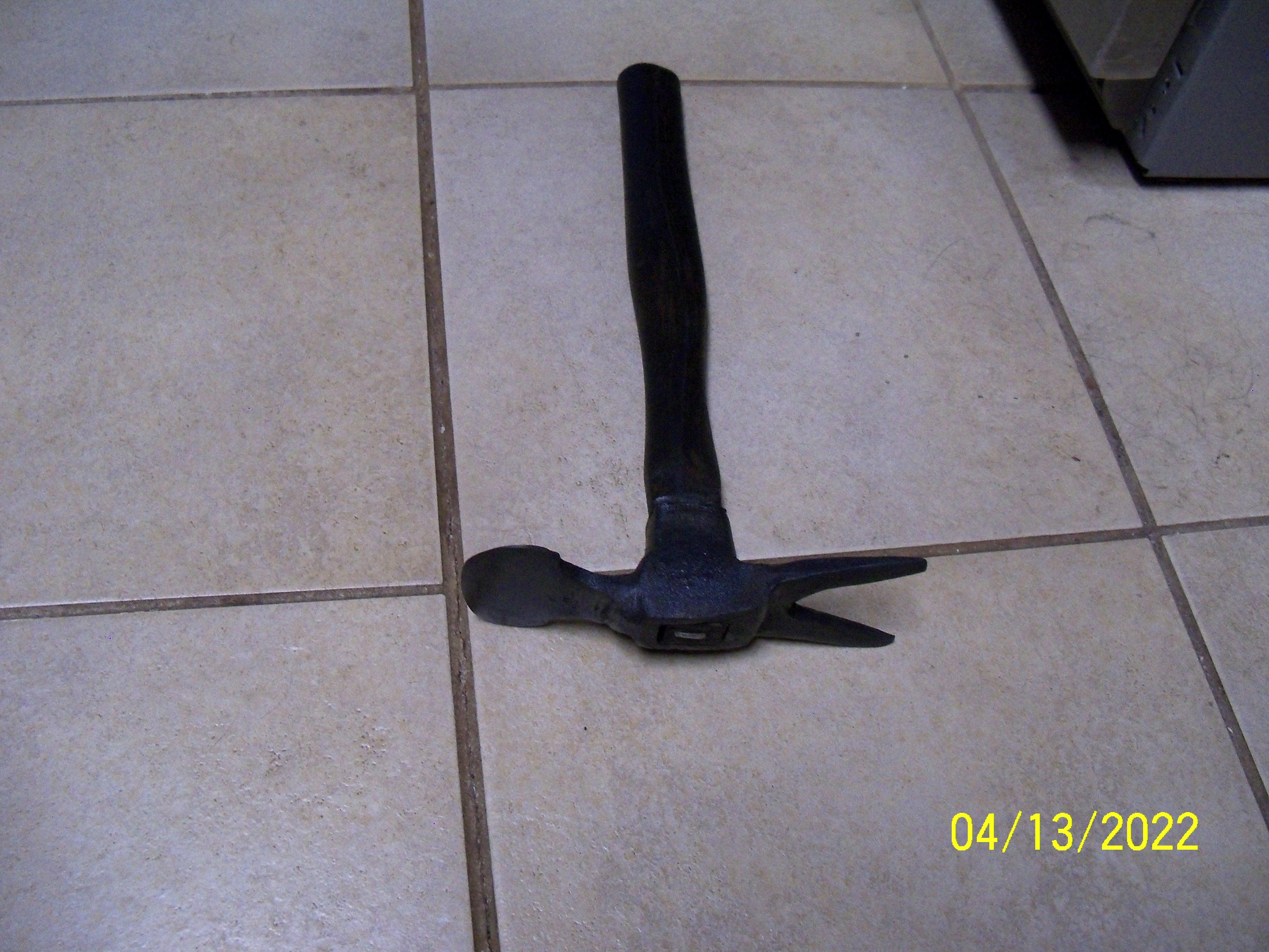

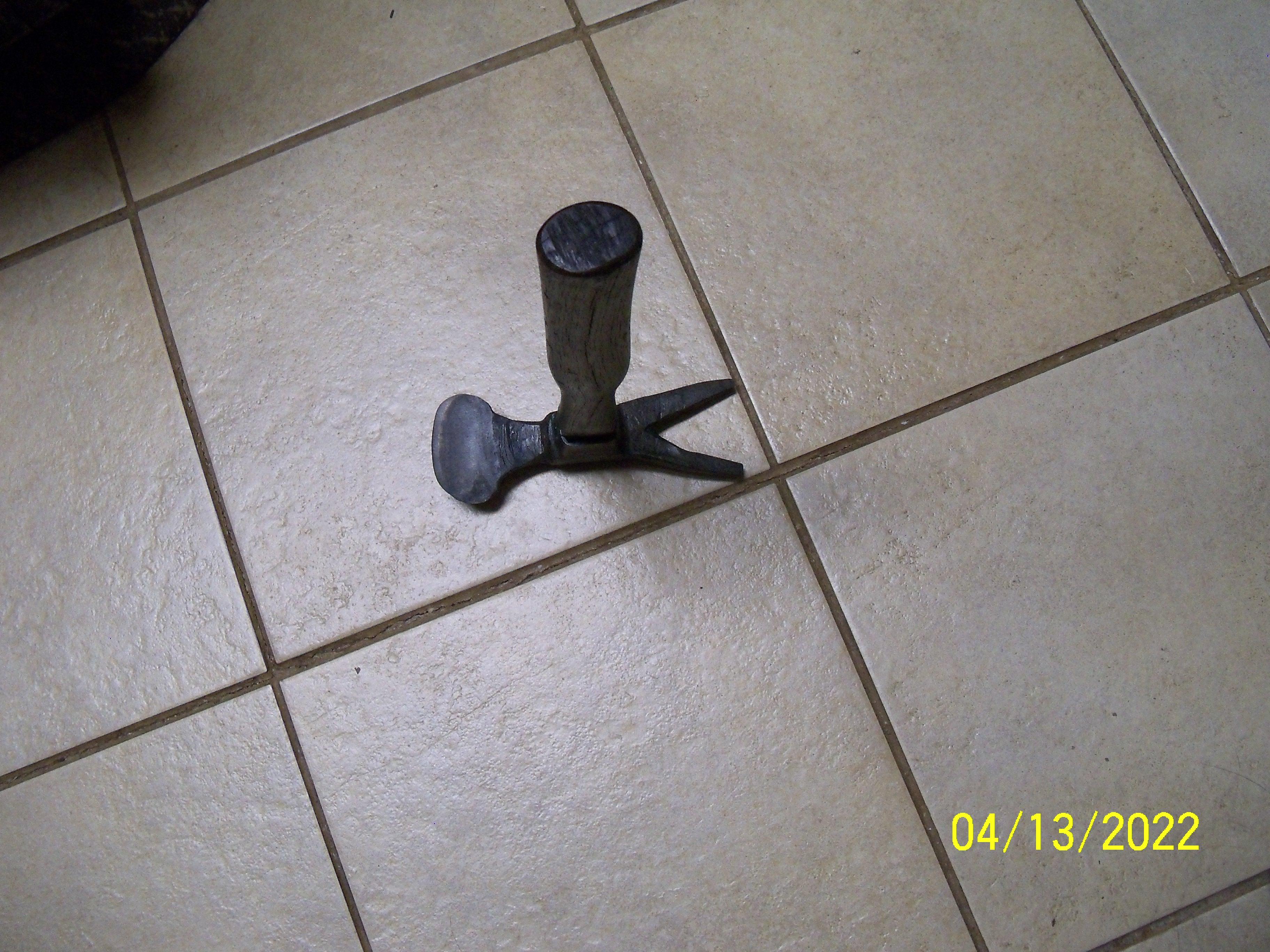

I have made some from old fifty cent yard sale claw hammers for my gardening friends and they seem to really like them.

it looks so funny it’s like someone dropped a anvil on a clay hammer. ill be looking out for stray claw hammers that look like they want to try something new.
