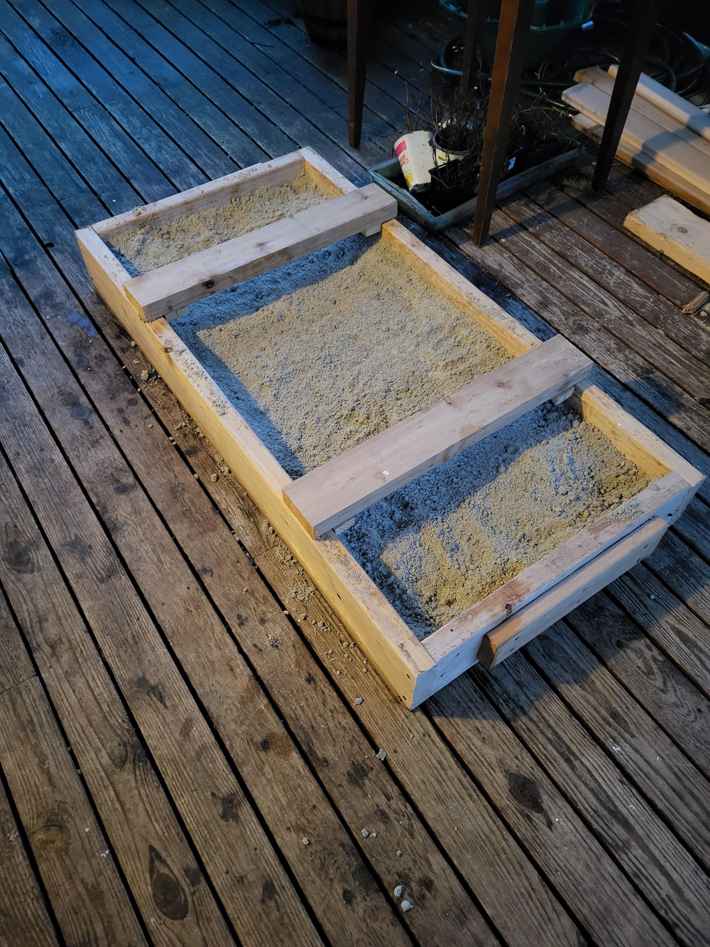

I've almost got my green sand casting set-up back and running, because my wife has been after me to show her casting. Thought I'd try to do the Gingery lathe, and if that works well, go through his series: the lathe, the shaping machine, etc. For those not knowledgeable (although I expect most of you are), Gingery starts with the idea of making a simple charcoal foundry, then pouring the pieces of a metal lathe, and using the partially finished lathe to turn the parts as you go.

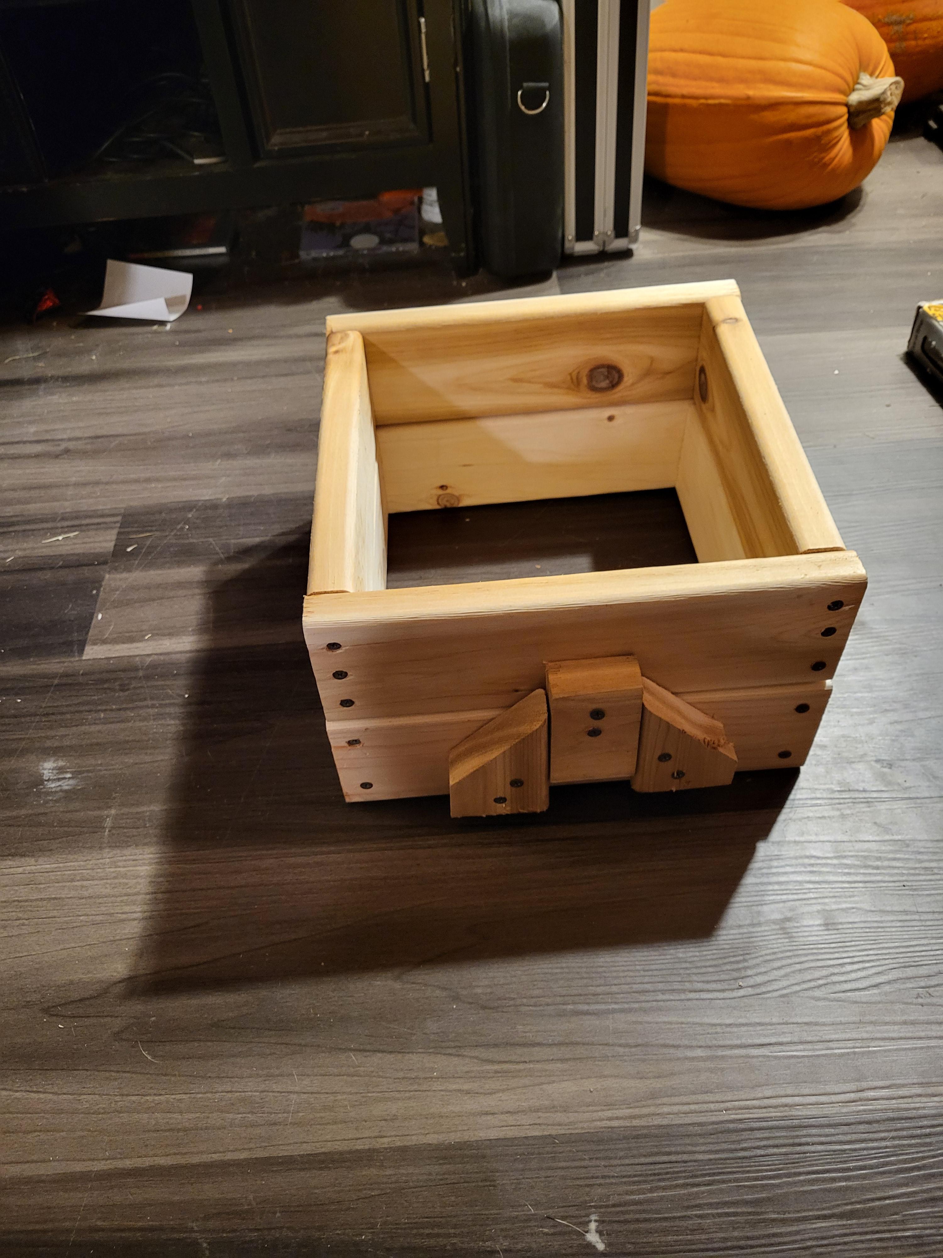

I've got a couple of small flasks made, and today I did the moulding table as well as mixing the green sand. It's not as fine a grade of sand as I would like (commercial medium grade), so I expect more scraping and finish work. Part of living on a bloody island, getting materials of any kind can be a pain. Otherwise, it's more or less out of the book: 100 lbs of sand, 11 lbs of bentonite, 1.66 lbs of flour, and a little more water than I would have liked - took three quarts.
I'm not touching it until I see how it looks after it goes through the riddle tomorrow and dries out a little if it needs it; I'm not fond of steam in my mold. It shouldn't need more bentonite either, but it sure feels like it does, possibly because of the greater porosity of the larger sand. I'll know better tomorrow when the clay has had a chance to absorb the water more evenly.
The big thing I'm still missing is aluminum. I've got a few lbs I can melt down, but not enough for the whole thing by far, or even much more than the bed. I may drive out to the junkyards in Sedro Wolley tomorrow and see if I can find a busted engine or transmission case, something that's only good for scrap value. They're a pain to break up but have a lot of aluminum. I know the Gingery design is imperfect and I don't mind incorporating improvements. If y'all have any suggestions, please feel free to shout or to just show your builds.

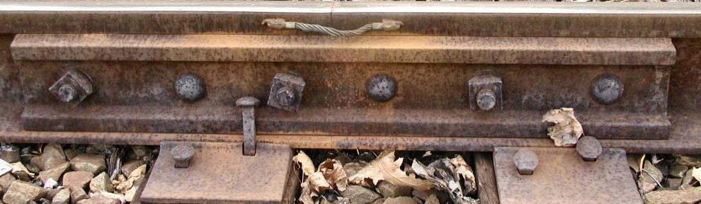

While technically illegal, I found a couple of these:
...on uncles farm.
Gonna use one for the ways and the other one for part of the miler or shaper (undecided now).

Fishplates? They're not generally illegal to own, although the acquisition might be. You can talk to road crews sometimes and they pop up in various places, including uncle's farms. As a former conductor, I strongly encourage everyone to stay off the rails; it's not the eight bucks in stolen scrap metal that offends so much as nearly killing people one in every two or three trips. I've got high enough blood pressure.

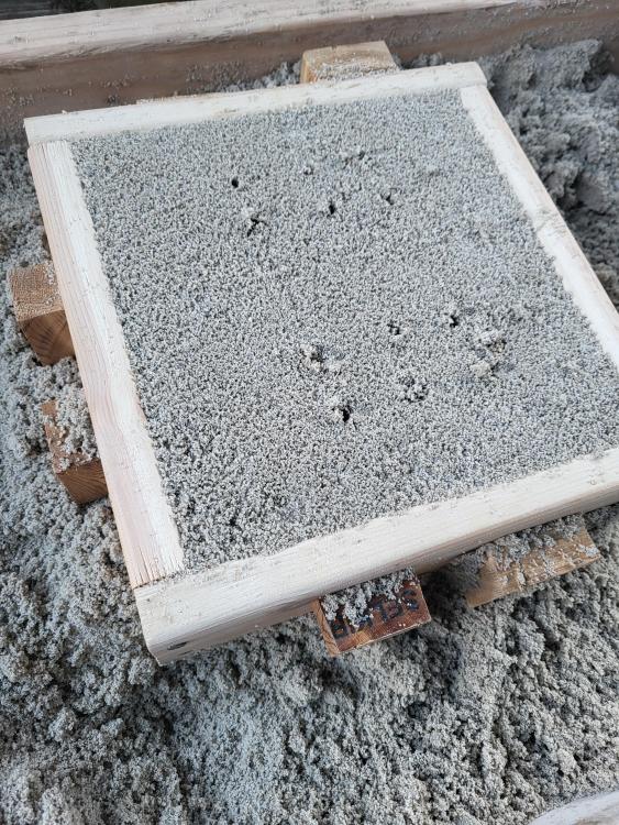

Nobody: You might want to sieve for finer sand and you need to let it temper (allow the moisture content to equalize through out the sand box) for several days at least. The feel will change as it tempers. The traditional test is to squeeze a handful hard and examine the results. If it leaves your hand wet or streaks it, it is too wet, add more dry mix a LITTLE at a time! If it crumbles it is too dry add a LITTLE water with a watering can to distribute it over the sand as much as possible. Mix thoroughly and let it temper for a couple few days. Retest. Keep notes on how much water or dry mix you added to make it right. It WILL dry out over time and use. A sealed box is the best but covered is necessary. You can leave it open to dry it of course.
About your flask. How are you going to lay the Drag flat on the table to mold the first half? The alignment pins should only be on the Cope with the receivers on the Drag. Or and my favorite is to have receiver holes in the table so you can lay the Cope on the table or pattern and it can't shift as you ram it up.
I've never seen a flask where the alignment system is proud of both Cope and Drag. Of course you could make a table with receivers for both, maybe at 90*.
Have you made your tamper? You have to ram up between the pattern and flask.
What are you using for release?

Frosty - honestly hadn't thought it through fully. Two solutions - either lower the alignment cleats on the drag (the ones on the cope still extend far enough) or use a moulding board the same size as the flask. If it's rammed with the moulding board on top of sand in the moulding table it shouldn't matter if the cleats go a little deeper than the board, but I'll probably just move the cleats a little. After all, I imagine I'll want to just use the table sometimes rather than have a board for each flask.
I was letting it temper for at least a day before use, and more if it needed it, as I have not enjoyed steam explosions enough in the past to do it again...accidentally. Right now, water is 6 lbs out of 118, say about five percent, which is more than I like but not out of the question since both the clay and sand were sealed and pretty dry. Squeeze test it felt damp, but not too wet, and broke okay-ish, but I wanna see how it does when the moisture has had more time to even out. It was a little sticker than I like last night. As a cover, I had a piece of plywood almost large enough, and tarped the rest; gonna cut a piece of plywood to size later.
Tamper for now is an old hammer handle, although I'll probably sand the end down into more of a wedge shape to fit the corners better. For parting powder, I was planning on something sophisticated, like diatomaceous earth in a sock dusting bag since I have a bunch of it already. If I decide I don't like the mild risk of silicosis, I may try chalk dust or give charcoal dust a whirl - I've been swimming in fines I started busting it up for the forge. I'm not sure that charcoal would work, but they use coal dust and graphite, and they're both similar-ish forms of carbon.

Check your sand's temper in 3-4 wide locations, one dead center, one bottom corner and one top far corner. Differences in moisture content will show better. With only 115 lbs. of sand you can use a mixing tarp instead of a shovel and hoe. It's a lot more thorough too. The only problem with that small a sand box is how fast the moisture content will change.
Unless you're flasks are really small you'll need a lot more than a hammer handle. This is where yard / garage / etc. sale baseball bats comes into play. I got something like 15 at a moving sale for the take all this stuff or nothing deal and when I stopped to think for a second lowered the price to $1. and I was more than happy about the $5 for half a dozen hammers of various description. Anyway, old wood ball bats make excellent mallets, twockers, feral dog discouragers, etc. and it doesn't make you one tiny bit sad to take a saw to one. Just show any interest at a ball bat at a yard, garage, etc. sale and they'll give it to you. NOBODY wants to buy old scuffed up bats. I see a beautiful tamper hidden in one, don't you? Hmmmm?

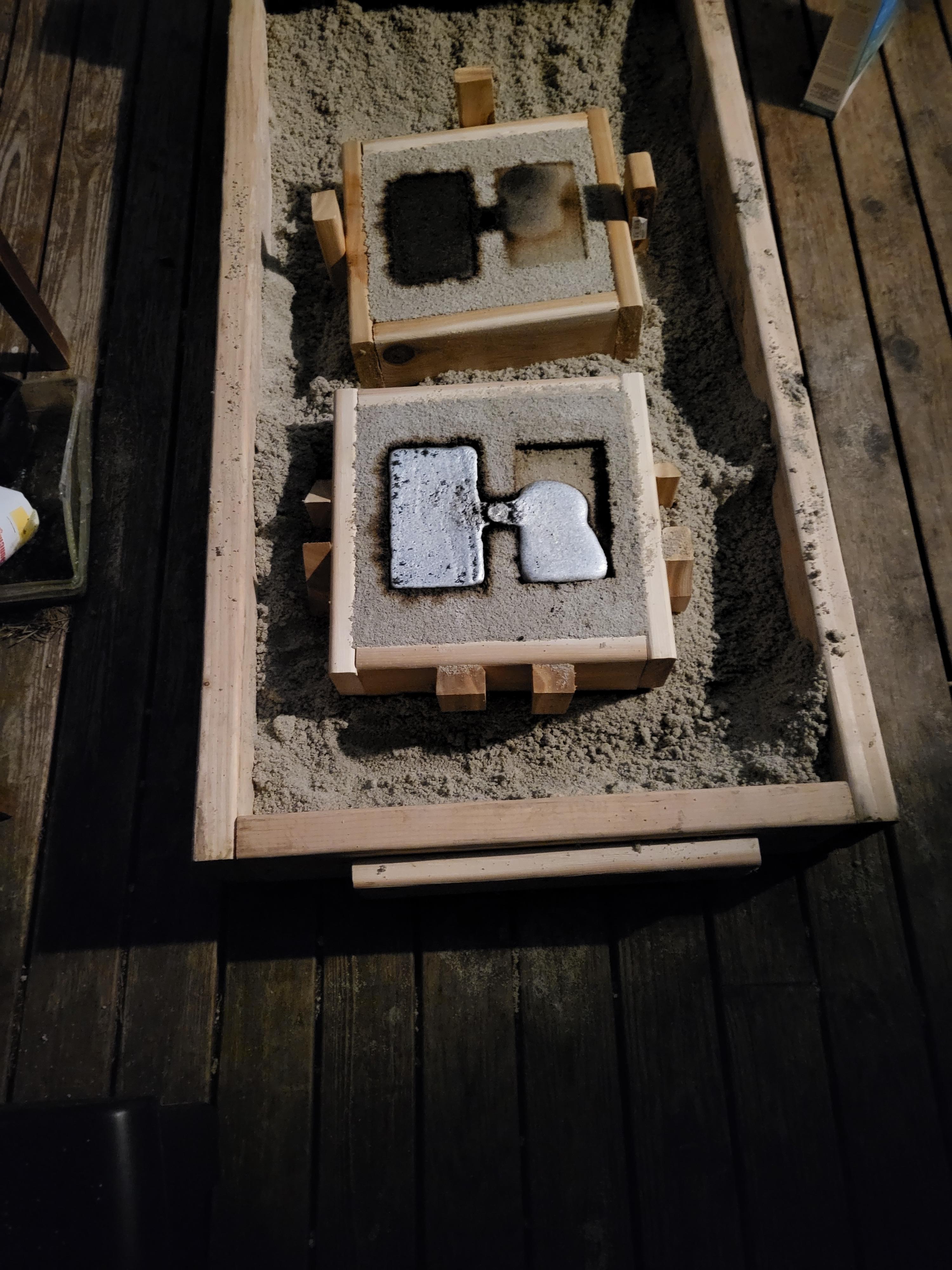

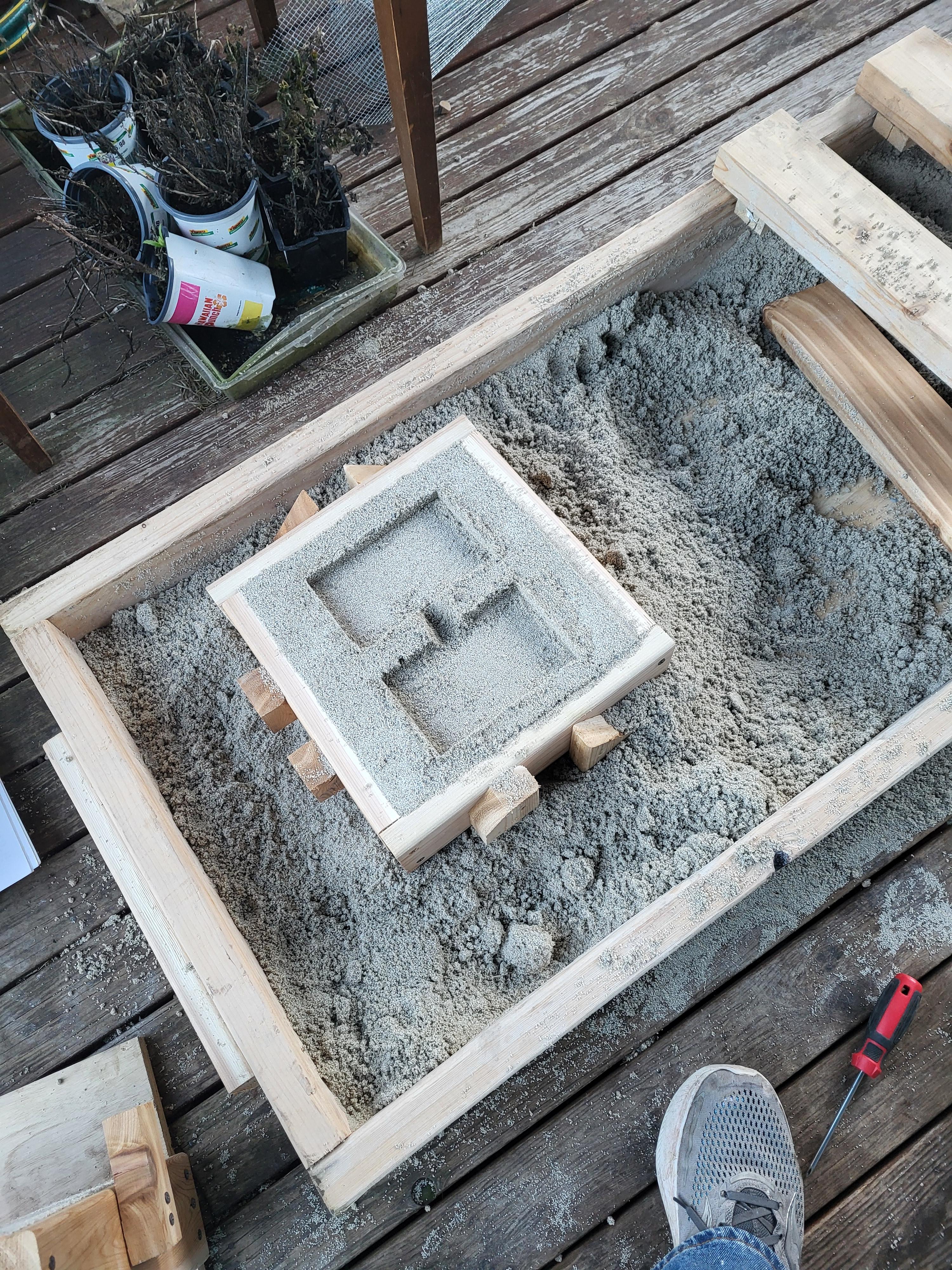

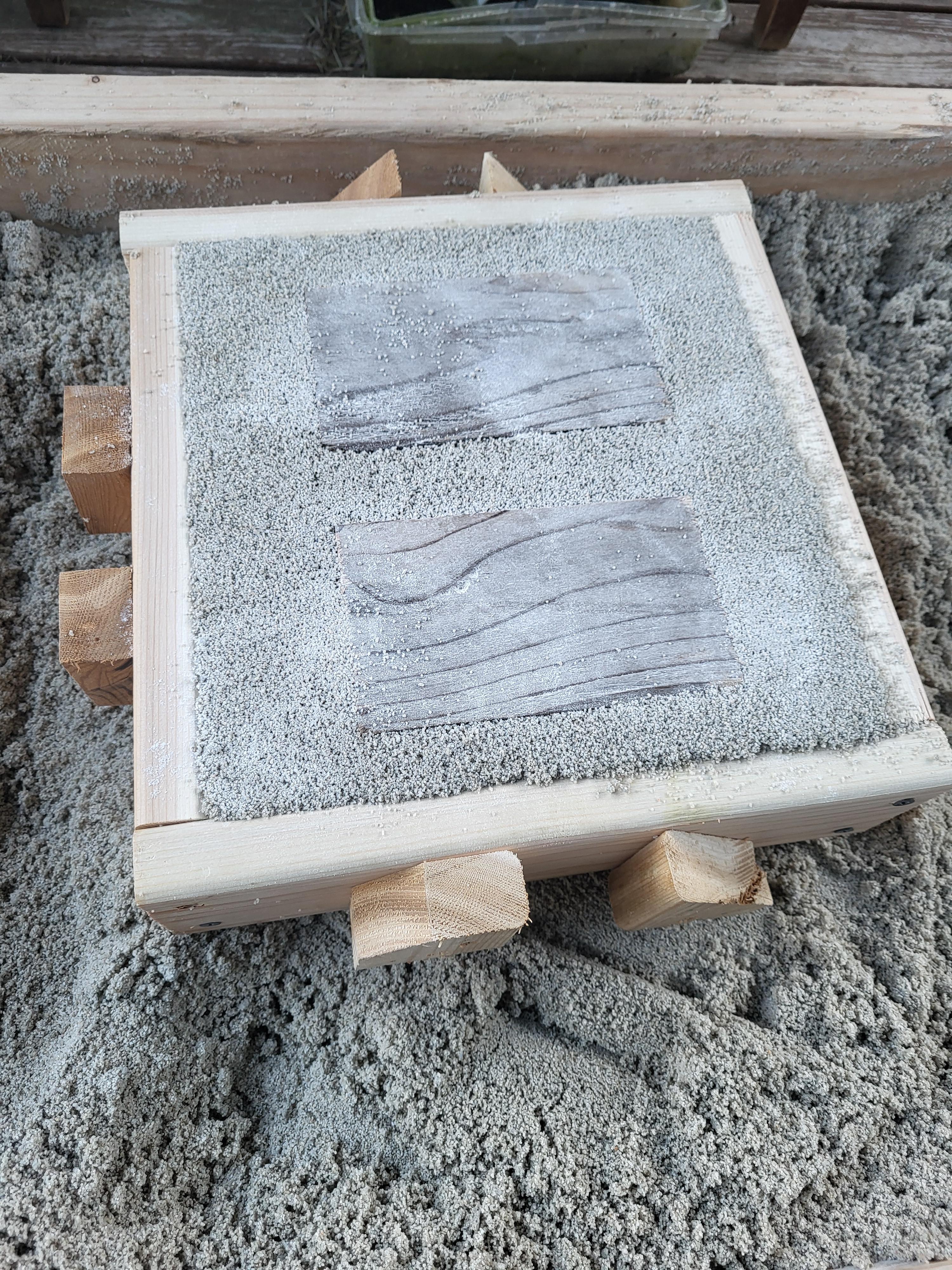

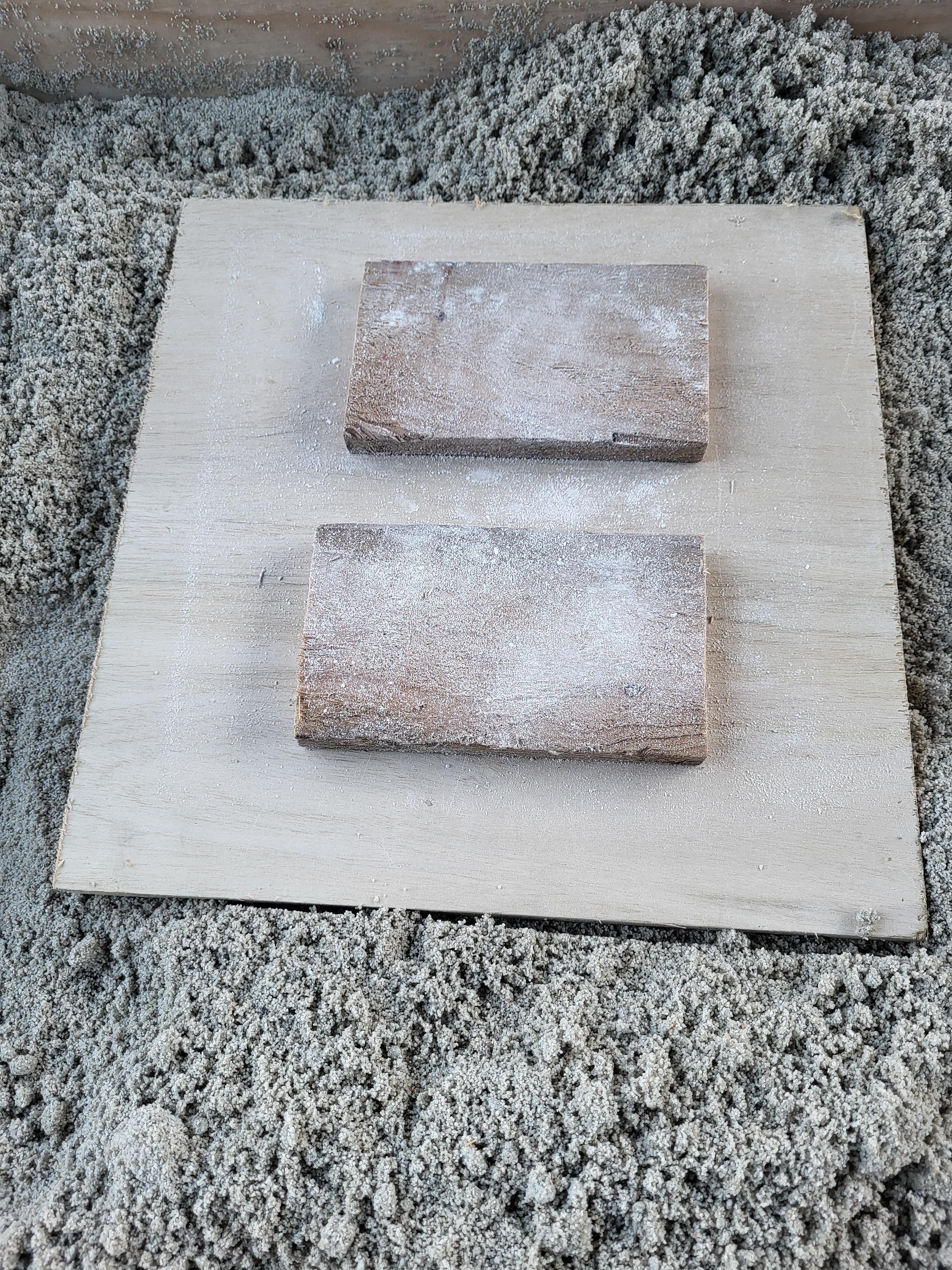

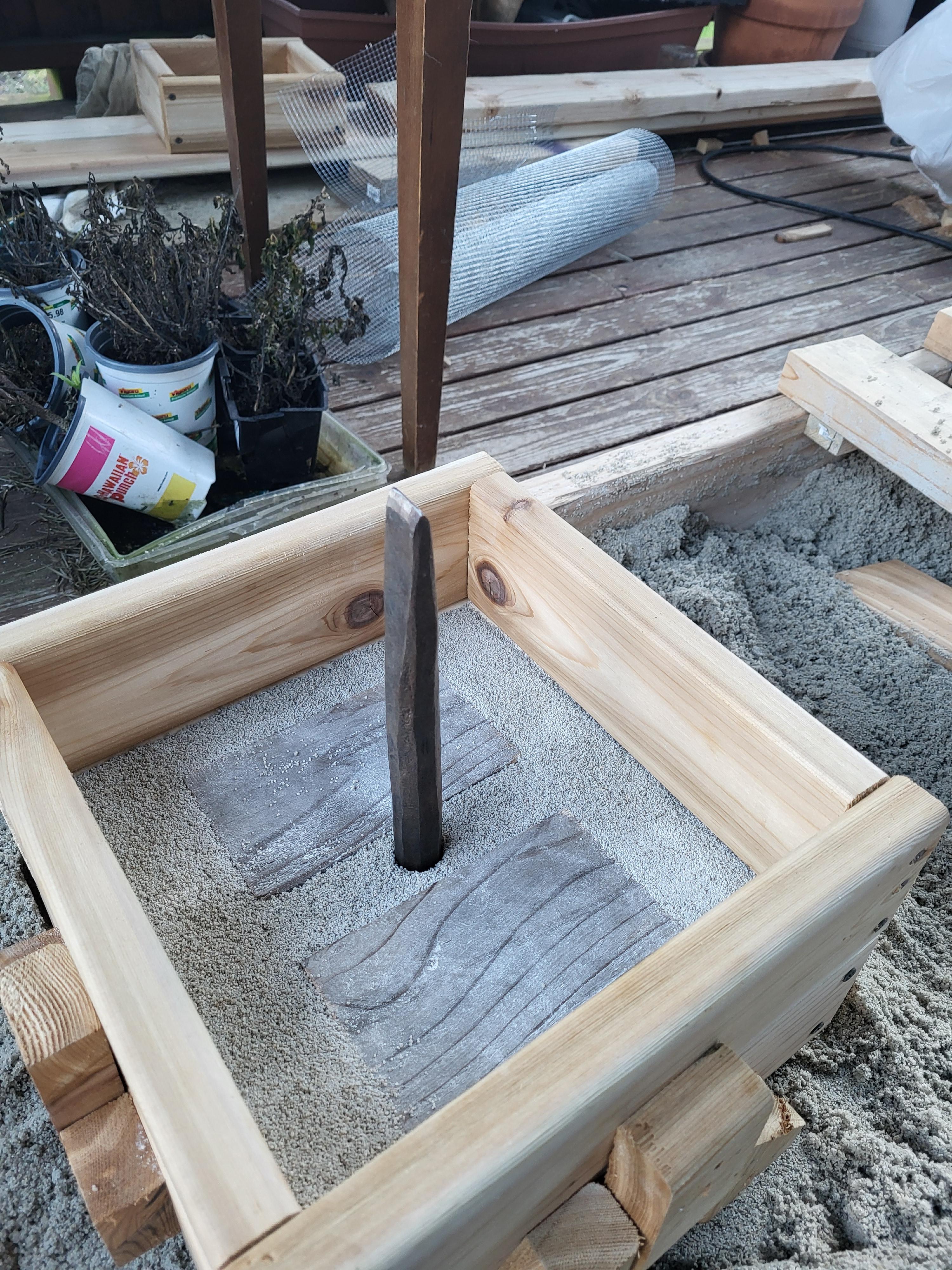

Well, got the first test casting done Thursday, following the Gingery books; he suggests casting core plates and since I haven't done casting in years, seemed like a good idea. I used a moderately thick stainless steel bowl as a crucible (I still haven't given up on pottery ones, but I've kind of gone sideways a bit). I'm a bit wary of steel crucibles, but it held up well under the heat and seems perfectly intact. Preheated it and the aluminum prior to charging and melting to make sure everything was warm and dry.
Made a few mistakes but perfectly happy with it as a proof of concept (i.e. that I'm not a complete idot who's going to melt my face off). I underpoured the casting due to guessing shy and not having enough aluminum yet (this represents about half a busted pressure cooker). Usually I prefer to have too much and make ingots.The casting wasn't completely level - hence why one side filled up before the other. And I got more porosity than I would like - on the bottom though, not the top.
That could be from overly wet sand, but I don't think that was the case here. I think I maybe over rammed it a touch and didn't vent well enough. I also stopped by a pottery supply in Tacoma on the way to drill this weekend and got some finer sand. Was also thinking about fluxing with crushed shell, never been entirely happy with borax for casting.
Haven't decided yet whether to set the medium sand aside or to keep using it and use the finer stuff as facing sand. Probably less work to replace it all in the long run since it will save finish work. Pic 1 moulding board and patterns with parting dust. 2. Drag rammed and vented. 3. Same thing reversed.

Pic 4 - the pattern removed. Could have been a bit better if I had lacquered them and had put a bit more draft onto them. Pic 5 - A cold chisel for a sprue pin. Don't judge, I couldn't find my dowels anywhere. I think my wife played with it with the pit bulls and it's now splinters. Pic 6. My furnace in action. Built it about 7 or 8 years ago and only used this one once. I honestly can't remember what happened to the original and the gas burner I had for it. Been deployed, two divorces, and slept since then. Pic 7 - My casting. Flawed but still fun. I can enjoy my aluminum I-phone and slice of bread, or I can always remelt it and go again.

You sprued and gated in the center of two flat thin patterns and no riser? :o Whenever possible you want the melt to move in ONE direction, not split and have to flow in two. That invites trapped air and incomplete filling.
Next time sprue centered but off one end and gate into the ends, corners suck to gate properly and clean up is more work. Then put a riser in the same general position at the far end!
Keep the runners in and out deep so the flow won't cool too quickly. What you remember about the gates should be above the bottom of the pattern and are wondering how to cut runners in the cope? You can lay something on the rammed up drag half to mark the runners or some kids in class made runner patterns so all they had to do was cut gates. Sprues and risers "should" be conical but cylindrical works just fine they just require more melt and you ARE going to melt a LOT more than you think you'll need next time. Right?

I'd maybe move the plates a little farther apart. The problem with dropping the sprue directly onto the runners like that invites the melt to erode sand from them which ends up in the mold. I do recall we dealt with shrinkage with deep runners and over filled sprue and riser.

Over ramming is a thing too, especially for beginners and it takes practice which I am more than 50 years out of.

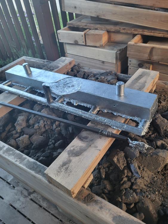

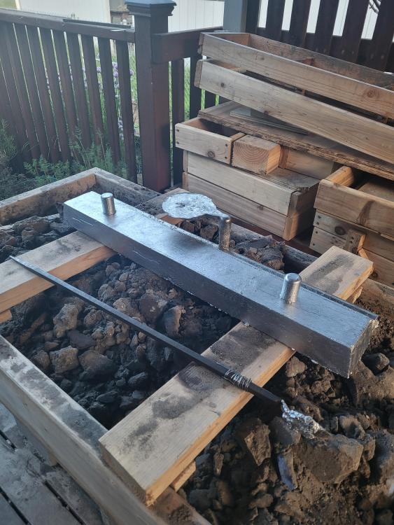

Busted up the first (smaller) half of one the fun way - with a big sledge and a three-pound ballpeen hammer on a ridiculously long handle that I got at a yard sale for two bucks with just such a purpose in mind. Got 10.5 lbs out of it and a large bearing for fun forging later. I'm sure there are more pieces in the yard near where I broke it that I'll find in the morning.  So figure maybe 50 lbs of aluminum before cleanup, maybe a little more. Even if I'm off by 20 percent that should see me well through the lathe and take me into the shaper, if I get that far.

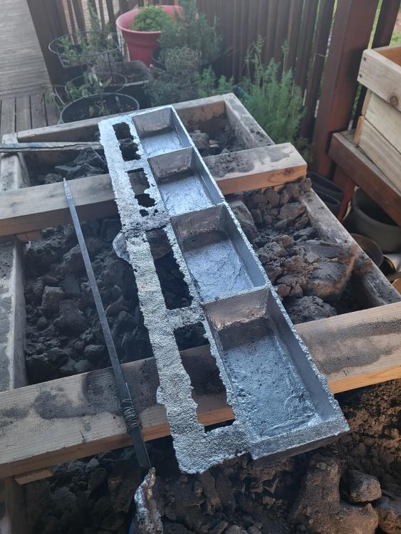

I was going to build a larger flask and start casting ingots tomorrow, off a long runner like the old pig iron pours. I even thought about using an open mold. I don't care if they come out perfect, just want to get rid of the worst of the oxides and oil, gunk, and any steel I missed. If I end up with even close to 50 lbs of aluminum, and it's that's around 500 cubic inches. The bed as Gingery calls for it uses about a quart of metal, which I think is about 57 cubic inches, about 5.5 lbs. Some of the versions I've seen call for taller or thicker beds to cut twisting or chatter but I haven't decided whether to modify it yet.

A good closed ingot mold can be welded up from shortish lengths of angle iron. Weld them flange to flange in two sets, say 4. They then get clamp plates across the outside and how you close up the bottom is up to you. I like using angle iron as the clamp plates, it lets you run long screws down to the base plate and across letting you clamp the ingot molds together and down on the base hard.
I suppose you could grind a channel between them to feed any overfill to the next mold but stopping before it over flows is my preference.
You can open the mold up for easy ingot removal and wire brushing when necessary. If al sticks smoke it first.
Of course using angle iron laid flat makes fine ingots but the above mold reduces air contact and loss to oxidization. And one last note, there is every reason to flux the melt before pouring ingots!

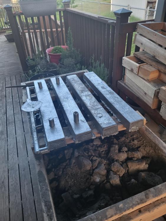

I made another flask, Friday, and some ingot patterns before running a few castings. Getting there but still making mistakes; didn't remember to vent the first run (still came out better than I expected, considering). The last one I poured a bit cold and is rough on the bottom of the ingots with some blowholes near the gate; I think because it was cold it stopped and started in the sprue, leading to air mixing with the metal and getting trapped in the casting. Not too upset, they're only ingots, but still want to get it right before I do the bits that matter. Still not quite happy with the medium sand and since the weather's supposed to be messy tomorrow, I might go ahead and mix up a new batch with the fine sand I got at the pottery supply last time I went to drill. Every day it's nice I'm going to run one or two batches of transmission housing until I have thirty or forty pounds.
