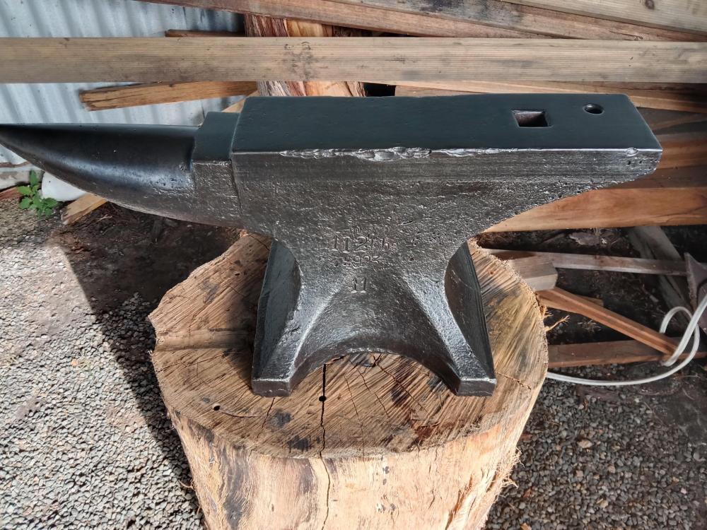

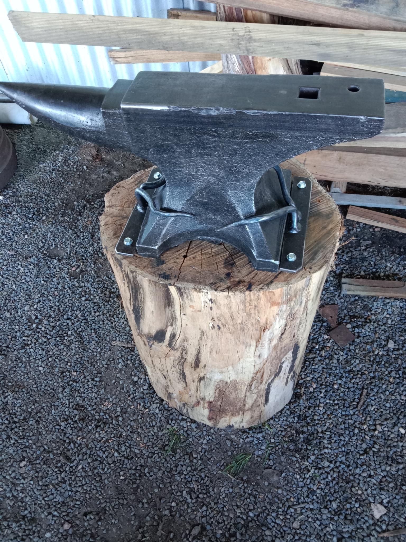

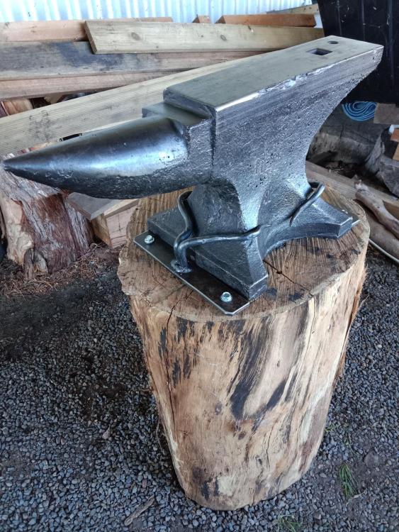

Finally found a good swedish anvil that i couldn't not take home so here is a few pics, 1923 Soderfors 112LB, nice flat face, rings loud( better now its mounted to the 85kg hardwood stump), if anyone knows what the 11 under the main left face is, or the 7 66 1-50 on the rear is that'd be great.

Thats a beauty. I really like the look of the hold downs too.
First thought was it looks like vines holding it. Then it got me thinking of like octopus tentacles.  4 more and they could hold hammers or something.
Sorry my imagination gets going some times. Must be a full moon lol.
Thanks, yeah before i fixed them they kinda looked like bull horns, gave me an idea of making coat racks with them mabye. Hammer holders yeah that would look even better!
I have a 125lb. 1926 Soderfors Sorcoress #5, best anvil I've ever used. Pretty cool hold downs but bear in mind function outweighs looks if you want a tool. I also put mine of a steel tripod to damp the dangerously LOUD ring.
The date is usually within a couple years, it was a model run or perhaps the date the model was added to the line. Dannemora is one of the cities with a Soderfors foundry.
Who know what the numbers on the foot mean, they were probably stamped by a buyer to ID their anvil. Or something like that.

I'll let you know how the hold downs go after a few hours, they may bend( if they do i should of used coil spring)! Its quietened the ring right down but i usually wear ear protection anyway.

Heck, I've never seen another Sorcoress let alone her big sister. It shouldn't bounce as tightly as you have it clamped down, mine wasn't pegged, spoked, clamped she just sat in a fitted miter almost as deep as her base.

No it just dropped into the miter it never bounced, wobbled and it wasn't "tight" let alone a tapered miter. The hammer and tong racks wedge the Soderfors and Trenton into their steel tripod stands but it's probably not necessary except as a way to hold the racks on without welding.

Looking good. I like the clean functional hold downs.

Thanks John, they seem to be working pretty well so far.

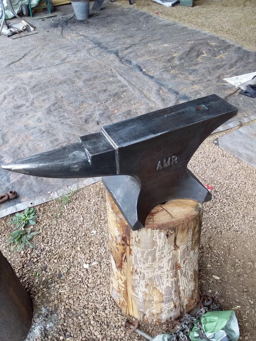

Here is my 70kg anvil (154lb) not very old this one( 2019) bit soft too but i like it.IMG_20231101_143220.thumb.jpg.913af72979cfcca103259f16308c1f13.jpg
Nice anvils, Jim. You can further deaden the ring on the Soderfors simply by adding a layer of silicone caulk or even a piece of innertube rubber between the anvil and the stump. I've got the caulk under the Undisputed King of Anvils and the rubber under the Emergency Backup Anvil, and both work a treat.
