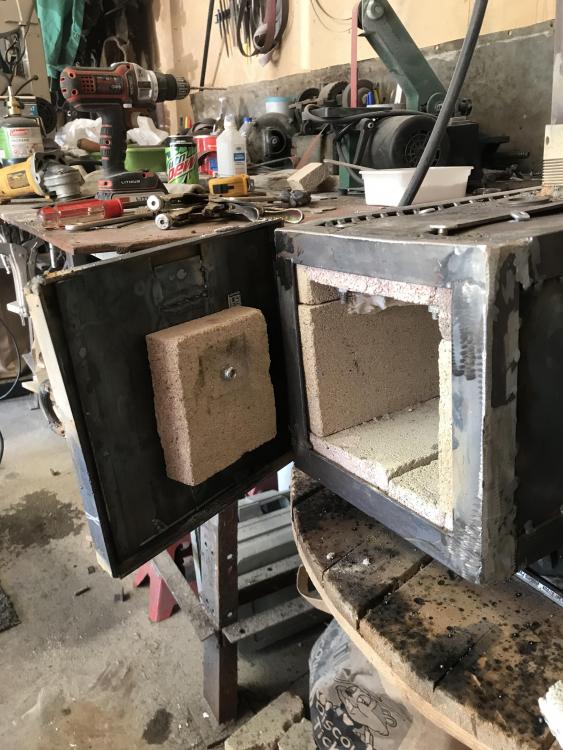

777jake777 Posted October 20, 2019 Share Posted October 20, 2019 Hey guys so I put a door on my forge now the burner goes out I am using a homade forced air propane burner should I simply put some air holes on both ends to ensure I have enough air going in Quote Link to comment Share on other sites More sharing options...
Irondragon Forge ClayWorks Posted October 20, 2019 Share Posted October 20, 2019 Without an exhaust opening the forge will not do well. So yes cut openings for the exhaust. BTW... Welcome aboard, have you read this yet? It will help you get the best out of the forum. READ THIS FIRST You might want to look through the Forges 101 section for ideas on the exhaust openings. What is your forced air source? Can't see it in the pictures. Quote Link to comment Share on other sites More sharing options...
