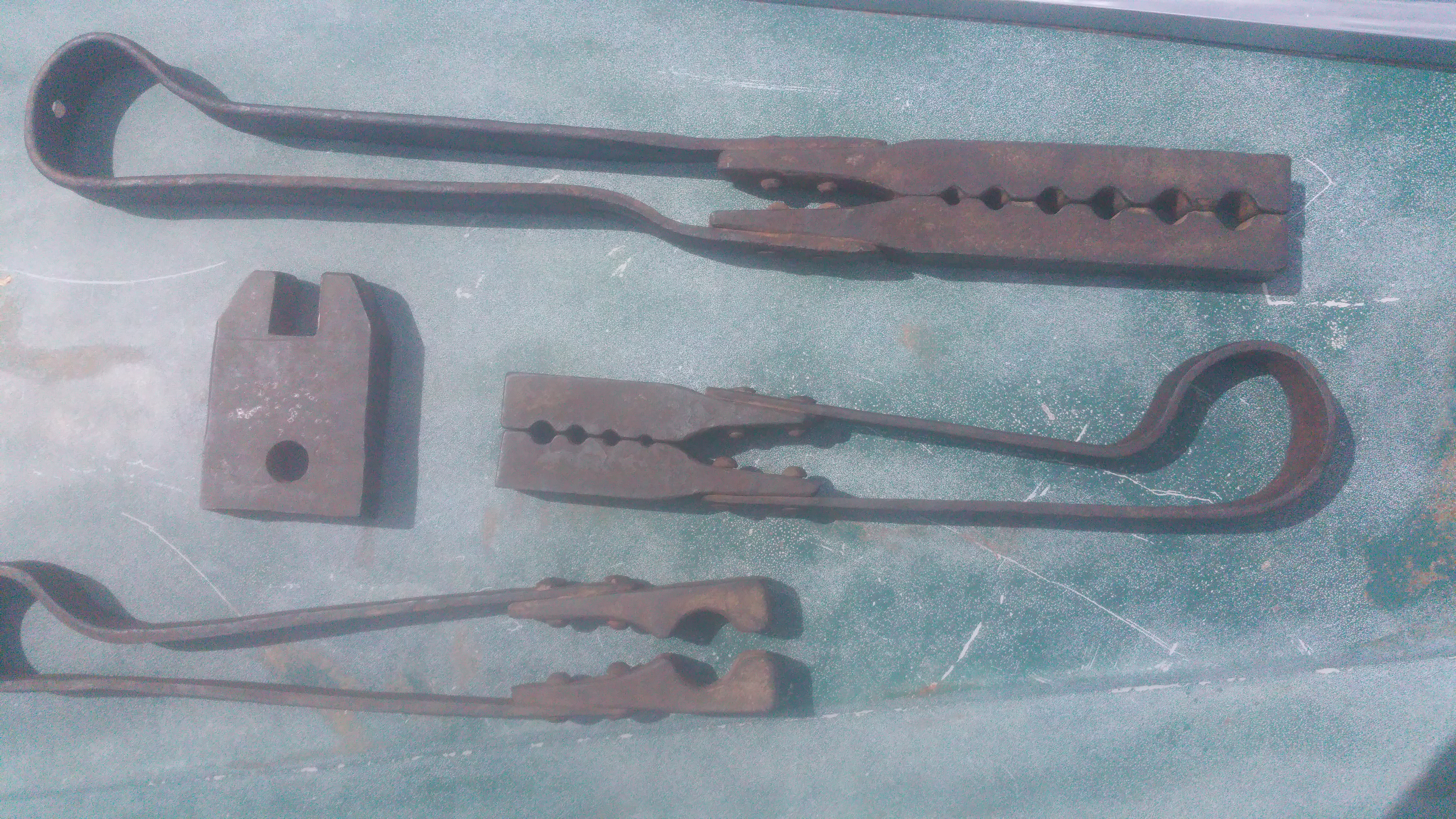

Speaking from experience both with Francis first hand and following his example in my own shop with W1/1095 tools, your concerns are not a problem. As an example, All of the tenoning tools in the pic are made from W1/1095 tool steel and have 30 some years of work, mostly under my 25# Lil giant. No chips, mushrooming or any other problems. Just a lot of years making a lot of tenons hassle free. They may not be hammers, but they sure have been hammered on.  Lol, the steel for the big tool on the top was in fact a gift from Francis to make the tool.

Different situation for sure Anvil. Tenon tools are driven together with piece of nice hot SOFT steel to cushion the impact. Miss a blow with a W-1 or 1095 hammer on a HARD anvil and it won't be many times before it chips. My Soderfors will skate a new sharp file, banging it with HARD steel is a bad idea. No?
Sure, I do some clean up on cold steel in my tenon tools and they're HC steel but even then there's a cushion and I'm not striking it like it stole my milk money. A piece of steel on my anvil? Oh Y E A H, I drive it like it's stolen.
My hammers aren't mild but they're aren't HC enough to become brittle without plenty of warning. I look at my hammer faces, peins and edges frequently, especially if someone misses a blow and smacks an anvil. I look then.

Frosty, thats actually a good critique on my tenoning tool. Thats the closest pic I could come up with to emphasize my point. I thought of one this morning. Even tho I don't have a pic, Francis made his daily driver. Sheesh, I have no idea how many hours over how many years he has in that hammer.  All his hammer demo's were made like this hammer and all, including his daily driver were made from W1/1095.
I wasn't critiquing your tenoning tools I was referring to the difference between them and missing a blow with a hammer on an anvil face.
