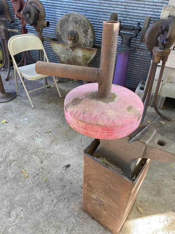

Will Brouwers Posted October 3, 2022 Share Posted October 3, 2022 I found this in the dumpster today. Normally I would scrap this kind of stuff, but before I did I wanted to see if it would be work keeping for something else. Quote Link to comment Share on other sites More sharing options...
JHCC Posted October 3, 2022 Share Posted October 3, 2022 IFI member TwistedWillow makes rivet forges out of them. Quote Link to comment Share on other sites More sharing options...
Frosty Posted October 3, 2022 Share Posted October 3, 2022 Twisted Willow (Billy) makes nice little coal forges from dead pancake compressor tanks. Look who's typing at the same time I am! Frosty The Lucky. Quote Link to comment Share on other sites More sharing options...

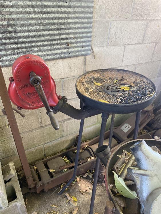

TWISTEDWILLOW Posted October 3, 2022 Share Posted October 3, 2022 Here’s a few I got settin around, one finished and a couple started on, Ive made a few here an there for other people too there actually kinda handy for a portable kit cause they are so light, they are really durable easy to make, an customize, you can make em to where to legs are solid welded or to where they are detachable, Quote Link to comment Share on other sites More sharing options...
Will Brouwers Posted October 3, 2022 Author Share Posted October 3, 2022 That's a great idea! We'll see if I get around to it, but thank you for getting my thoughts going! I also thought about using it as a dishing block? I'm not sure how well it would hold up though. Quote Link to comment Share on other sites More sharing options...

TWISTEDWILLOW Posted October 30, 2022 Share Posted October 30, 2022 On 10/26/2022 at 3:10 PM, Chad J. said: do you clay those Chad J. sorry just now saw your question, yes I clay them with local red dirt out of the bar ditch that bein said they are steel and you really don’t have to unless you want too, I believe the pans should hold up quite awhile, they are just as thick as those pressed steel pans that Buffalo an champion used to use for some of their rivet forges and table forges, Quote Link to comment Share on other sites More sharing options...
Irondragon Forge ClayWorks Posted October 30, 2022 Share Posted October 30, 2022 Probably a little heavier and better steel, seeing as they are designed to hold pressure. Quote Link to comment Share on other sites More sharing options...
