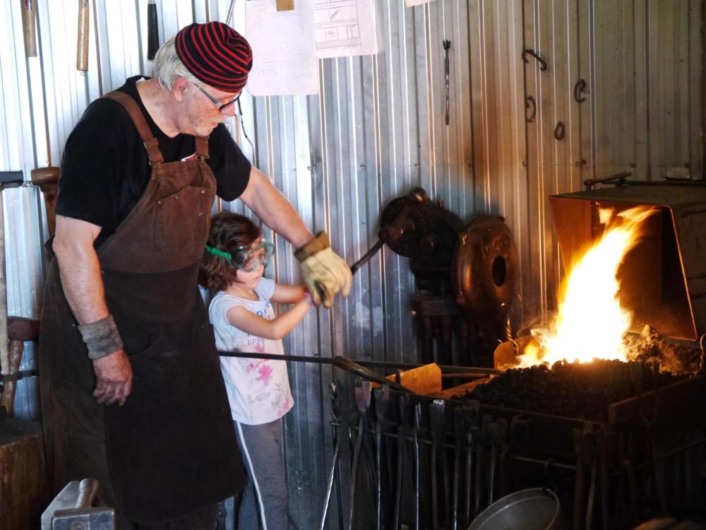

This has always been my set up. It draws very well and I never had a problem in winter. In fact, in the picture, you can see how I instruct my grand-daughter to hold on to the handle so that she would not go up the chimney…4C7E976E-BE58-49AB-9CC8-DC71325D6B0B.thumb.jpeg.1e3178b938f4923cd872fcae97088bdc.jpeg

Single. Notice the top of the chimney where a sleeve (Ø 14") overlaps the chimney (Ø 12") for 3 feet and extends 1 foot over the top.

This forge hood is interesting not only because the system draws so well but also because there is nothing above the fire pot. It eases the handling of longer pieces. Do not hesitate in your  new space. This supper sucker is a good way to go. The sleeve running at the last 4 feet permits to avoid a cap on the chimney. Rain always falling at an angle, hits the inside of the sleeve and runs down to the ground. I have very little water, even very little snow in there.
