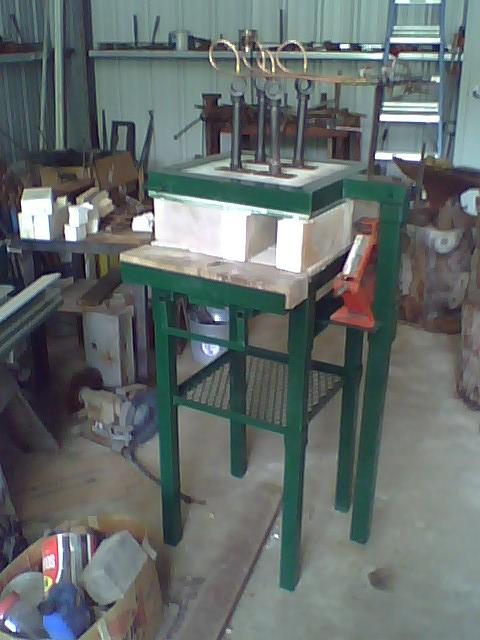

When I finally got my shop closed in I built what I thought would be a very versatile shop forge. It's roughly 24" square with a lid mounted on a scissor jack so I can lift the lid and arrange the IFBs that partition sections and shape. It's heated by four 3/4" T burners. In the 20 years I've had the thing I've only fired up all 4 burners a couple times. First for pics and to cure the refractory. After that a couple times when I had enough guys over to need room in the forge for 5-6 guy's work. 90% of the time I use that forge I fire a single 5" x 5" x 8-9" section and 3 burners just sit there looking like weird trees.

Yeah, that's the OD subtract 5" for the IFB sidewalls. I could cook pizza in it but it sheds stuff, dust from the ITC-100 on the lid, from scraped IFBs (Insulating Fire Bricks), flux, scale, etc. You  know the usual . . . stuff found in a propane forge.
Oops, it's only 20" square, posting a pic and it's obvious. This is it when it was new about it's 3rd iteration and pretty much how she is now. The open section closest is my usual when I fire it up, I'll move the partition and light the one in line behind for heating longer sections.
