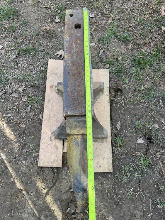

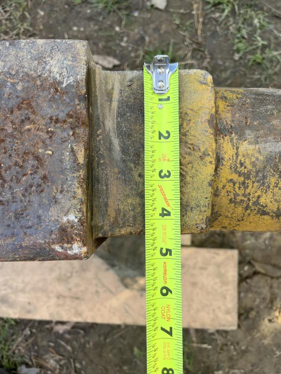

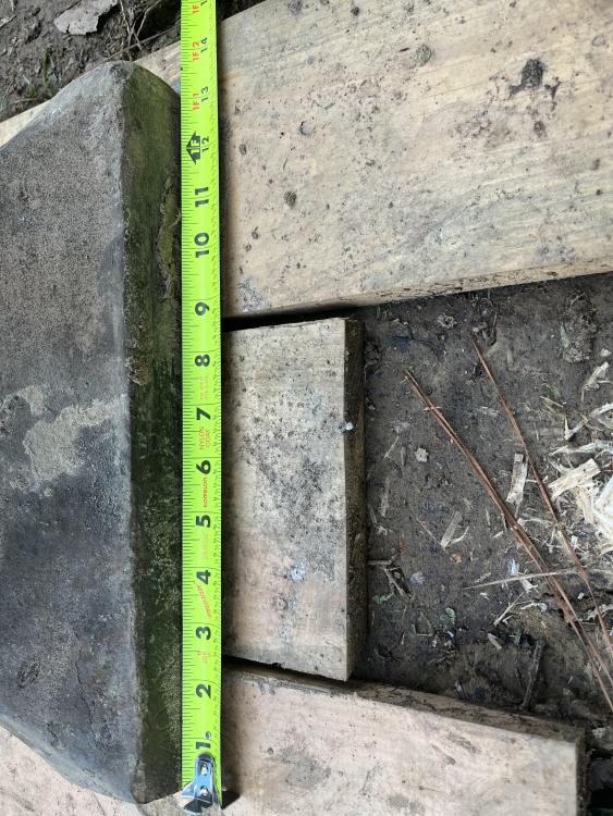

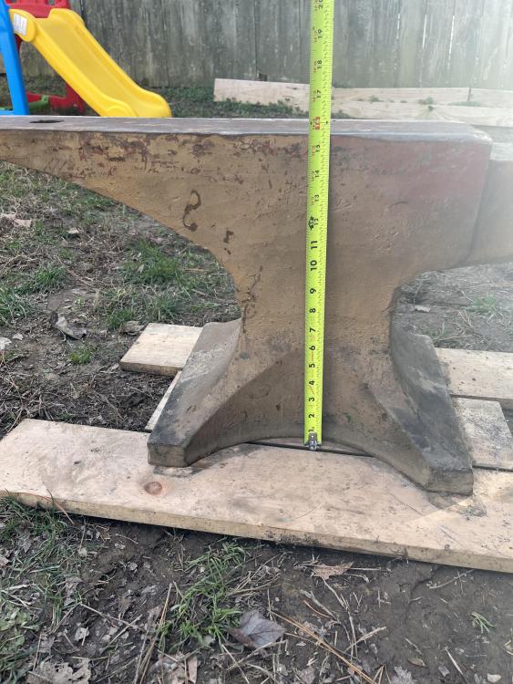

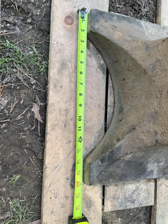

DDayton Posted January 14, 2022 Share Posted January 14, 2022 (edited) Good afternoon, I recently stumbled upon this beauty and have been cleaning off the layers of paint and neglect. So far this is what I have found for identification. I am fairly new to this community and have only followed YouTube as to cleaning her up. Edited January 14, 2022 by DDayton Lack of photos Quote Link to comment Share on other sites More sharing options...

DDayton Posted January 14, 2022 Author Share Posted January 14, 2022 Current progress on restoration. Any recommendations for oil for the surface of the anvil. I’ve got banding to put on and 2 more coats of teak oil to help the base. Quote Link to comment Share on other sites More sharing options...

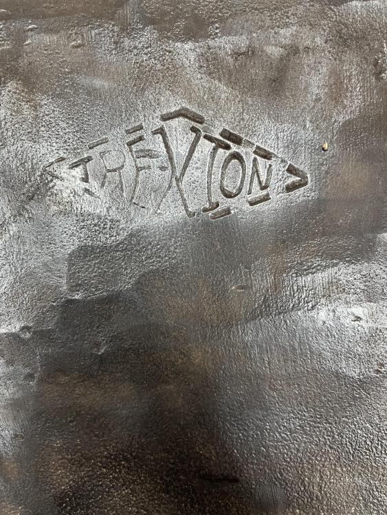

ThomasPowers Posted January 14, 2022 Share Posted January 14, 2022 Trenton, a top grade American anvil made in Columbus Ohio, the base should have a caplet indentation on it. The stampings on the foot is weight in pounds and a serial number that can be linked to a date of manufacture. The X stamping is a well known variant that folks have been speculating about for YEARS! Why would you oil the face; just USING it will keep it shiny and rust free Quote Link to comment Share on other sites More sharing options...
DDayton Posted January 14, 2022 Author Share Posted January 14, 2022 To be honest, yes. I have idle hands at the moment and would like to make her right before putting it through the ringer. Any advice on preservation and restoration of the face and table would be much appreciated. How would I go about finding the date of manufacture? All I’ve found is Trenton stopped making anvils decades ago, and even that info may not be accurate. Any insight is much appreciated as well! Quote Link to comment Share on other sites More sharing options...

TWISTEDWILLOW Posted January 15, 2022 Share Posted January 15, 2022 1 hour ago, DDayton said: How would I go about finding the date of manufacture? There’s an awsome book I highly recommend picking up, called anvils in America by Richard postman, it’s full of awsome information AinA list it as made in 1941-1943 pg 361 Quote Link to comment Share on other sites More sharing options...
DDayton Posted January 15, 2022 Author Share Posted January 15, 2022 6 minutes ago, TWISTEDWILLOW said: There’s an awsome book I highly recommend picking up, called anvils in America by Richard postman, it’s full of awsome information AinA list it as made in 1941-1943 pg 361 Thank you, I shall definitely look into getting a copy. I have a feeling I am going to develop an obsession with metal working. 10 minutes ago, ThomasPowers said: How does the Navy protect steel items in your area from rusting? Haze gray paint. Usually if it isn’t a moving part it’s painted. Quote Link to comment Share on other sites More sharing options...
