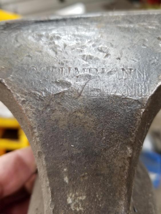

Here's the stamping on the wagon tongue vise incase it helps.  I almost think I see something above the year date on one photo but not sure.
I've had a Columbian with the full stamping on the back of the stationary jaw; Columbian, Cleveland Ohio, etc. I sold it on as it was in mint shape and I'd feel bad about messing it up with use. Looked to have been drop forged.
I have also seen mounting plates with a depressed triangle and raised C in it like their logo on anvils.
