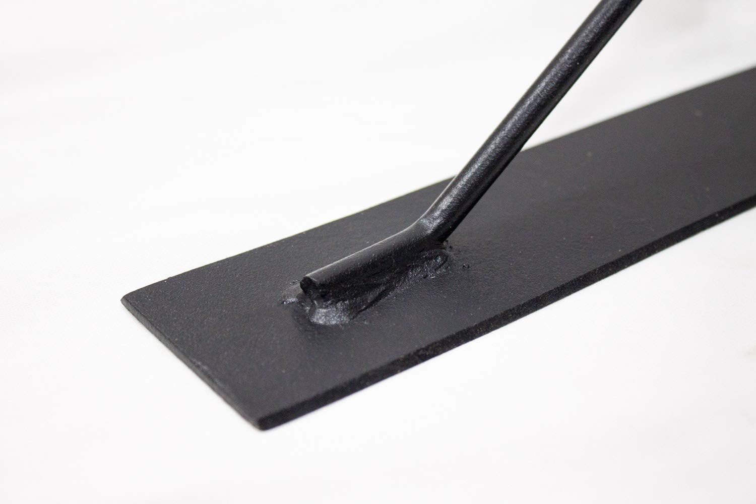

July 14, 20214 yr sorry for the inconvenience, I would like to make a similar tool to mow the weeds and bushes in my garden, I do not have a motor brush cutter, every time I have to borrow it. I think this rake-like tool that cuts like a razor and swings like a hoe could be useful to me, do you think it is efficient or would it be better to adopt a classic scythe? thanks, I wait for opinions and suggestions. DIMENSIONS 40″h × 14.13″w × 2.5″d how should i build it what materials i could reuse
July 14, 20214 yr I'd go with a scythe if you have a sizeable amount of land to clear. (And Yes, I have used both!)
July 14, 20214 yr Author I built it in the afternoon, only it came very heavy, I took a 30x30 x 2 mm box about 38 cm long, I welded teeth made with 8 mm construction iron, 13 cm long 6 pieces, welded about 5 cm l 'one from the other, in the reverse direction I welded the foil of a 4 cm wide gate spring, as a handle I put a rusty iron tube at the head, like a t-shaped razor rake. I broke it works like a hoe but it is very heavy, from the side of the blade I cut from the side of the prongs I pull the mowed grass and I make sheaves. I did something wrong I'm sure. about 3000 square meters let's say 5000 square meters with the neighboring land, it is aesthetically very ugly and heavy, perhaps the scythe would be more suitable.
July 14, 20214 yr Here in the USA "grass whips" are typically very light, the cutter is made from relatively thin sheet metal---thinner than the blade on a standard lawn mower. Goats?
