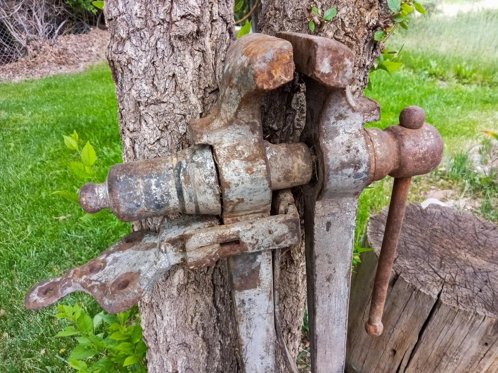

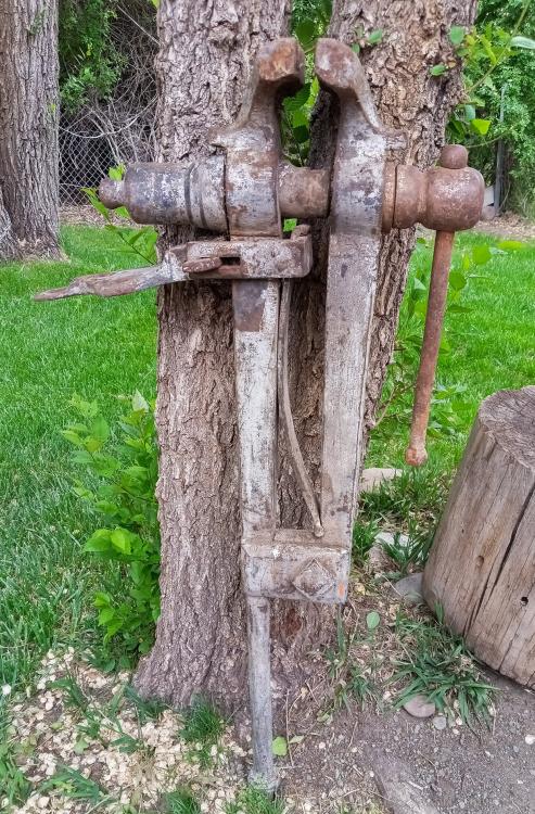

Does anyone recognize this nice working vice that was purchased in Carson City, NV? Trying to determine it's approximate age. It was purchased from a Carson City blacksmith a few decades ago by a very close friend of ours, Robert Pendleton, who has since passed away. There are no markings on it as far as we can tell.

Reminds me of an Indian Chief post vise I had, with the unbeveled legs and  Bell shaped screwbox.  I'd check the the upper flats of the stationary leg looking for a trademark stamp. Cleaning it with a wire brush may help.
Please note that postvises were made by a lot of different companies and not all stamped them so it may not be able to nail down the brand. As to age  I'd say 1880-1920 is a good guess.
Most of the value in a post vise is how good a shape the screw and screwbox are in.  The screw should have sharp square threads|_| , if they look more like V then they are extremely worn.

Unfortunately the best fellow I know for Post Vises was Frank Turley who recently deceased.  He identified my oldest vise as being pre-1800 and probably came over as part of an immigrating craftsman's tools.

Amazingly, the screws on this vice are still in excellent condition. I don't think it was used very much.

Judging by the mounting plate I say it’s a Peter Wright vise, they are the only ones I’ve seen that have that shape with four mounting hole instead of three.
