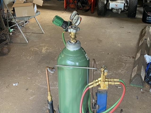

JHCC Posted June 17, 2021 Author Share Posted June 17, 2021 On 5/30/2021 at 11:38 AM, Frosty said: I know you want to use a soft flame but that's pretty rich. One of the difficulties with adjusting the flame while the rig is in torch mode is that the pilot light is adding propane without adding oxygen. Quote Link to comment Share on other sites More sharing options...
Frosty Posted June 17, 2021 Share Posted June 17, 2021 The pilot flame has nothing to do with the adjustment on the torch handle or do you have it plumbed in a strange way? The pilot flame should be reducing the volume of propane to the torch if it has any effect. Frosty The Lucky. Quote Link to comment Share on other sites More sharing options...
JHCC Posted June 17, 2021 Author Share Posted June 17, 2021 The pilot flame does not affect and is not affected by the amount of gas flowing to the torch. What I'm saying is that when the torch is clipped into its bracket (that is, when the stand is in torch mode), the flame is directed over the pilot light so that it will ignite when the pedal is depressed and the gas saver valves open. What this means is that even when the flame at the torch is perfectly tuned, it's picking up the flame from the pilot light, which makes the flame appear more rich than it actually is. Does that make sense? Quote Link to comment Share on other sites More sharing options...
Frosty Posted June 19, 2021 Share Posted June 19, 2021 Yes, makes perfect sense and no effect. Frosty The Lucky. Quote Link to comment Share on other sites More sharing options...

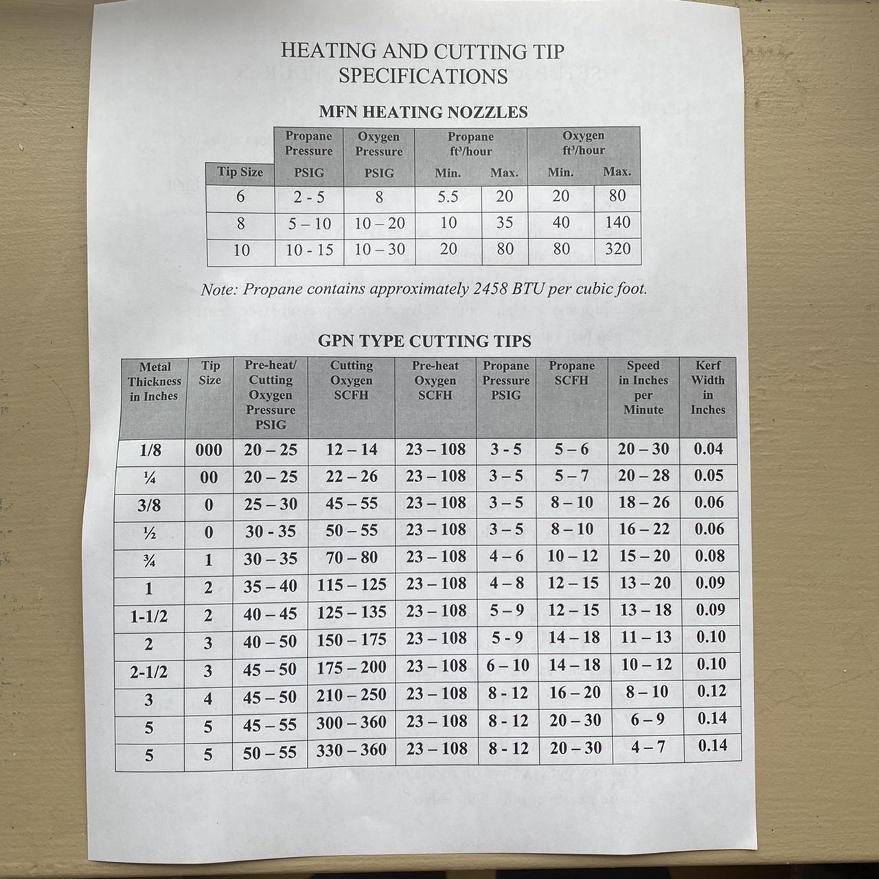

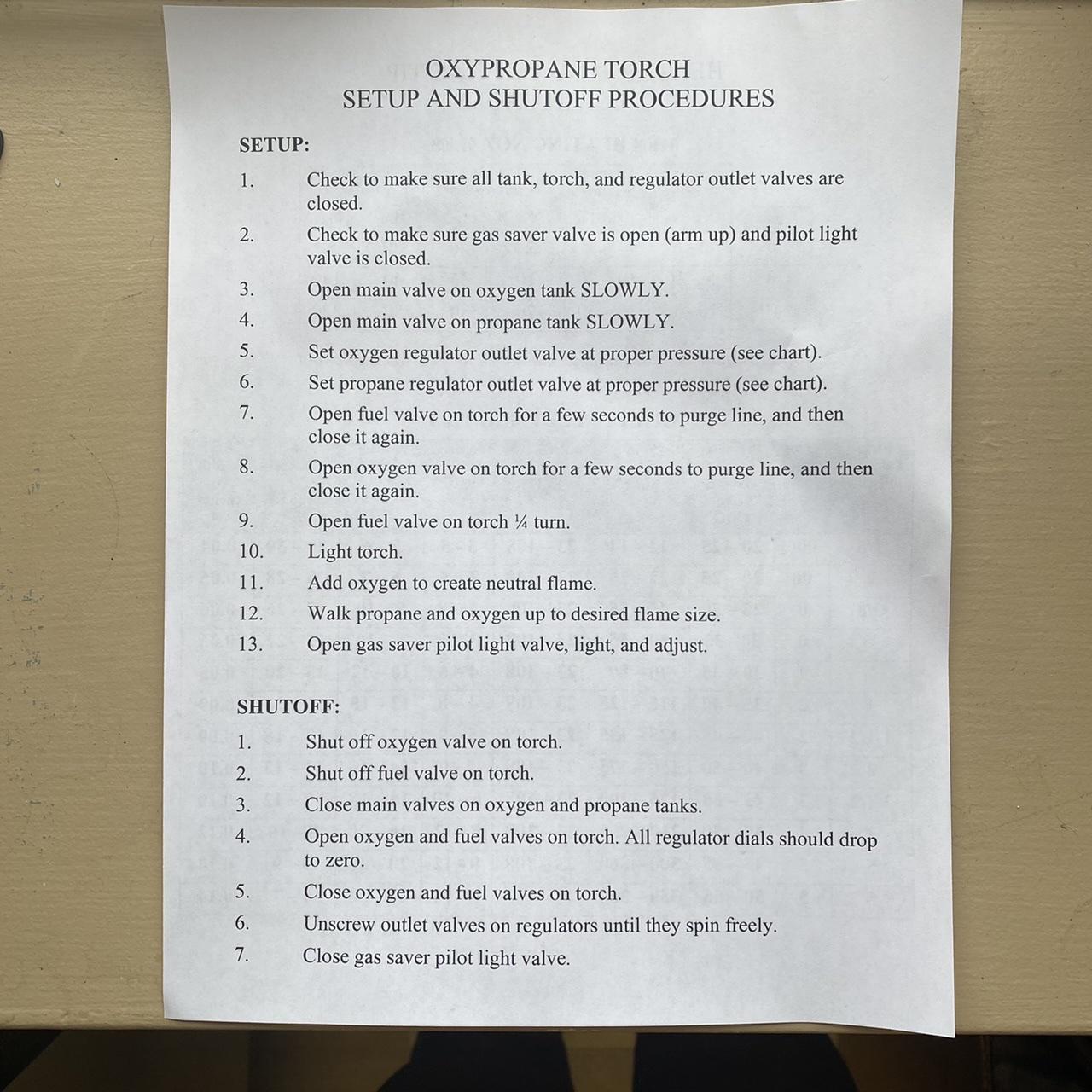

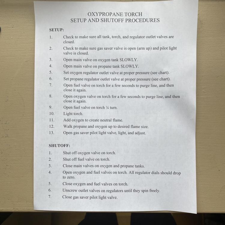

JHCC Posted July 16, 2021 Author Share Posted July 16, 2021 Having gotten tired of trying to find the right pages in the Victor instruction manual both for lighting and shutdown procedures and for adjusting the pressure settings, I decided to extract the relevant info, add specifics for my own setup, put it all on one sheet of paper (both sides), put that sheet in some kind of transparent sleeve, and hang it off the stand for easy reference. No more misreading off the oxyacetylene chart! Quote Link to comment Share on other sites More sharing options...
Frosty Posted July 16, 2021 Share Posted July 16, 2021 That'll come in handy. Frosty The Lucky. Quote Link to comment Share on other sites More sharing options...
JHCC Posted July 16, 2021 Author Share Posted July 16, 2021 Did I miss anything or get anything out of order in the procedures? (I didn't include "Connect hoses to torch, tanks, and gas saver, and install proper torch tip." Even I don't need a reminder on that.) Quote Link to comment Share on other sites More sharing options...
Glenn Posted July 16, 2021 Share Posted July 16, 2021 Make a second copy and store it in a fire resistant enclosure, say taped under the shelf of the table. It will come in handy later. (grin). Quote Link to comment Share on other sites More sharing options...
JHCC Posted July 16, 2021 Author Share Posted July 16, 2021 Fair point! Quote Link to comment Share on other sites More sharing options...
ThomasPowers Posted July 16, 2021 Share Posted July 16, 2021 Or the justly famed "Off Site Storage"; I'd bet that John has a filing cabinet somewhere! Quote Link to comment Share on other sites More sharing options...
JHCC Posted July 16, 2021 Author Share Posted July 16, 2021 The document itself is currently on my Google Drive, where it's safe from pretty much anything short of an EMP. If that happens, I probably won't be able to get propane or oxygen anyway. Quote Link to comment Share on other sites More sharing options...
Glenn Posted July 16, 2021 Share Posted July 16, 2021 Off Site Storage is great IF they still have it and you have a week or so to get it. An extra copy in the shops log book is great. The log book starts when you have several of the extra copies that need gathered together in one place so you can find them. Early on I put a copy of the rods I usually used on each welder, the amp setting, AC or DC, etc and covered it with clear tape for protection. Some amp settings are now crossed out and a better number is listed. You would be surprised how many times you check that list just to be sure. Quote Link to comment Share on other sites More sharing options...

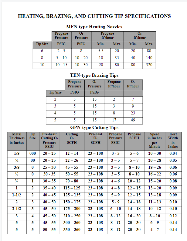

JHCC Posted July 29, 2021 Author Share Posted July 29, 2021 As noted elsewhere, I've acquired a brazing nozzle that takes Victor's TEN-style tips and added the pressure and gas flow settings to the chart: Quote Link to comment Share on other sites More sharing options...

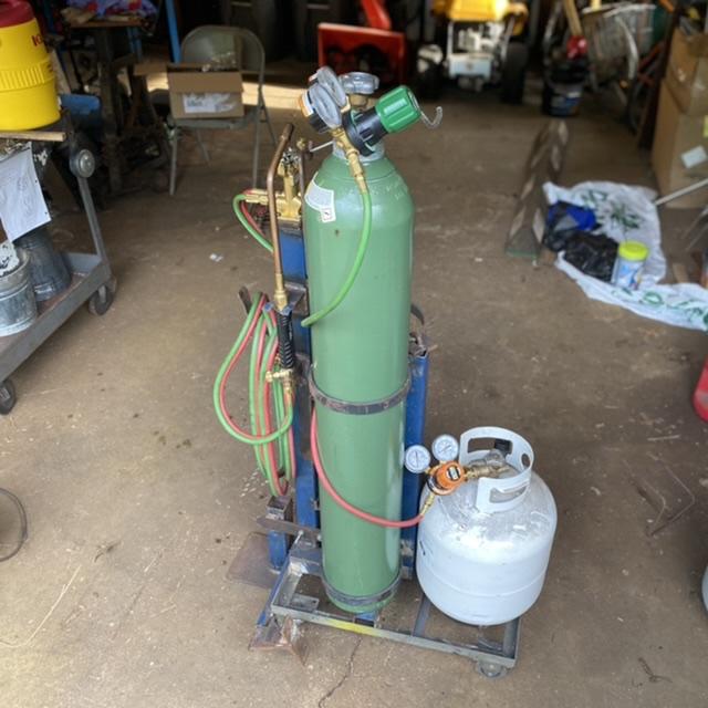

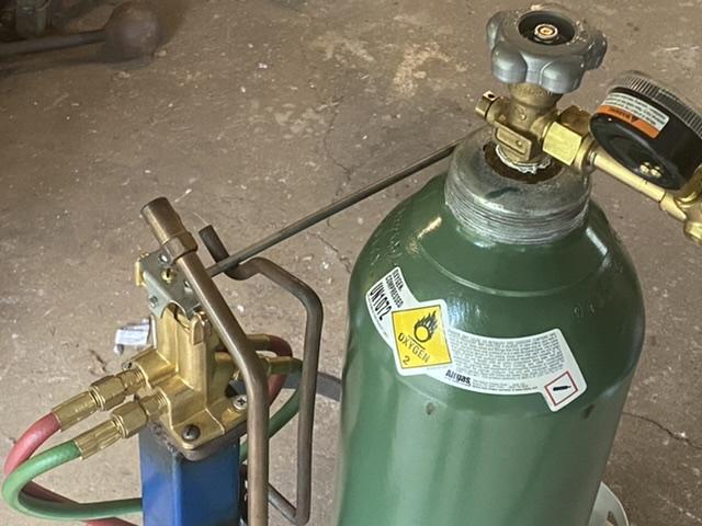

JHCC Posted July 30, 2021 Author Share Posted July 30, 2021 The 60 cu. ft tank having proved too small, I decided to upgrade to a 120. Since it’s a good bit taller than the 60, I’ll have to tweak my technique a bit when using the gas saver, either with more of an up-and-over movement to get to the pilot light or simply by working from the other side of the cart. Torch mode is unaffected: Quote Link to comment Share on other sites More sharing options...
JHCC Posted August 25, 2021 Author Share Posted August 25, 2021 It's occurred to me that the existing torch mode setup won't work if I want to use a brazing/spot heating tip, as those nozzles are much shorter than the rosebud. I think I might want to figure out a dual-height mounting bracket if I end up using the torch with the shorter tips. I'm also contemplating switching the position of the tanks, so that the oxygen would be at the far end of the dolly from the pedal and the propane would be in the middle. That would eliminate the need for an up-and-over motion when using the gas saver, but it would shift the center of gravity somewhat. Need to think about this. Quote Link to comment Share on other sites More sharing options...
